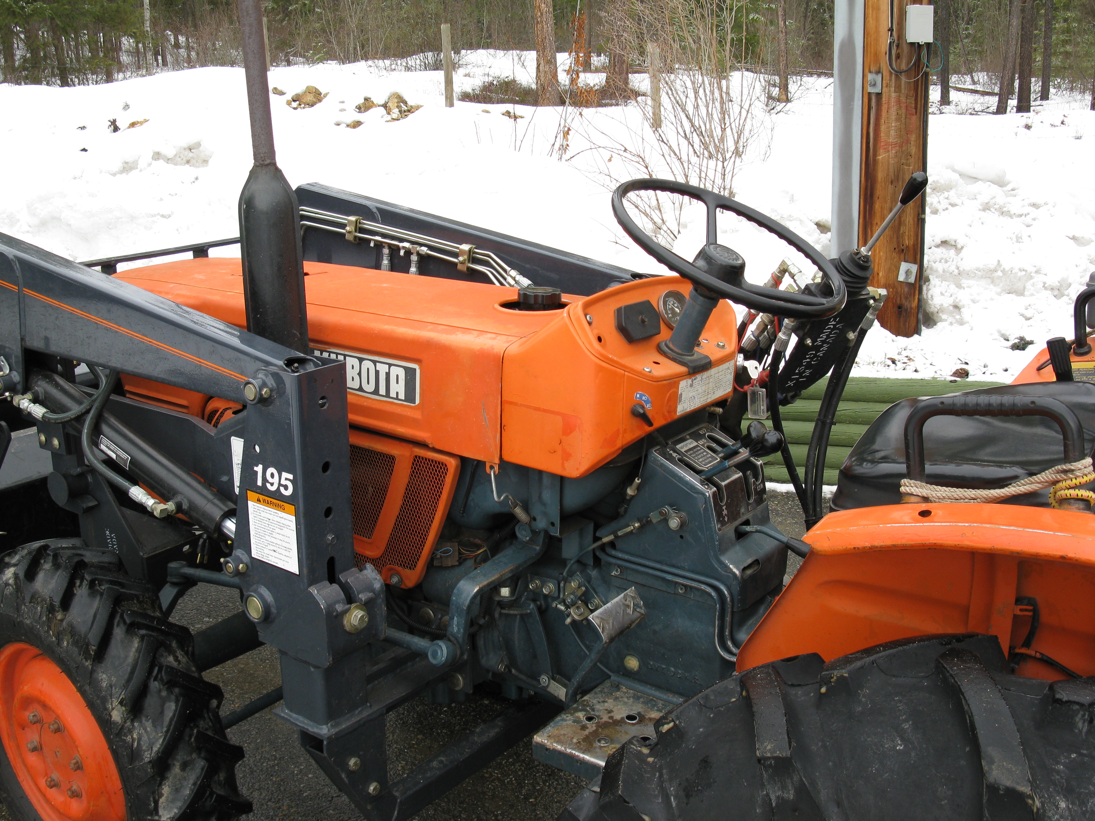

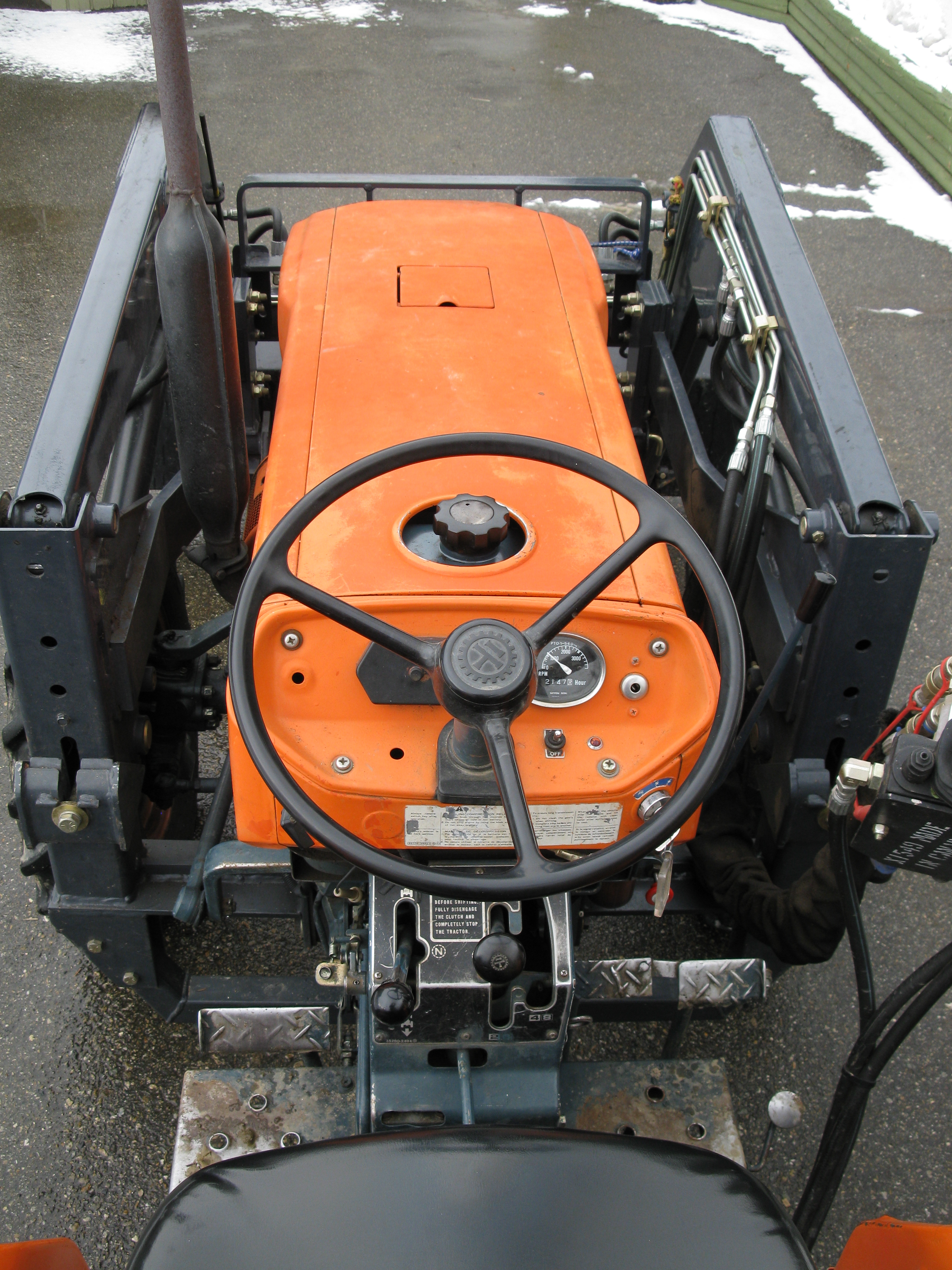

I had a 1981 L275DT with an Allied 195 loader. It was a great tractor that I traded in for my DK35 in 2011. The loader should be easily detachable. Lower the bucket with it flat on the ground and put down the two support legs. Loose the large bolts by the base of the loader and swivel them up to clear the bracket. Then gently curl the bucket so the arms lift out of the mounting bracket enough so you can drive back a bit and undo the hose couplings.
I've attached a couple of photos of old L275DT. It was a great tractor. My Kioti dealer lives near the person who bought it. He often sees it working and it is still going strong.
Adding another note about the loader....Mine did not have a separate pump. It used the same hydraulics as the 3 point lift and was nicely plumbed in with fittings on the topside of the transmission tunnel under the seat.
