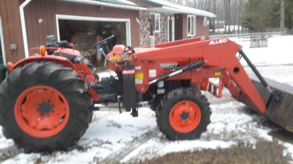

Hello All:
I just bought a 1984 Kubota L305DT. The tractor is clean with just under 1000 hours on it (if the meter worked it's whole life). The unit seems in really great condition aesthetically and mechanically. I will take delivery in it Tuesday and we're just going to service the whole unit stem-to-stern. I currently have a 2017 BX25D and have been using it around the place for over a year. Four questions:
1. What is the difference between power steering (BX25D) and Power Assist Steering (L305DT)
2. The FEL on the 305 is stickered "Allied." Is that an aftermarket loader? it has external valve and a tank on the drivers right side of the FEL mount.
3. The 3PT hitch doesn't lower by itself unless there is something attached, then it lowers fine. Anything to be concerned about?
4. What do I need to know about this unit from anyone who has used one. I like my BX and I won't sell it. I bought this for the increased PTO HP and because my wife said she didn't care if I bought another tractor as long as I keep it in the bark and off the yard - NO BRAINER!!
Please advise - any help would be appreciated. Thanks!!
   / Just bought a L305DT - Looking for answers please! #2
1. The L305DT has mechanical steering, i.e., gear box with mechanical linkage to the front tires, that is assisted with power hydraulics. The BX25D only has hydraulic steering, if the engine isn't running you have no steering. The old tractor will still steer, just takes more effort.
2. Allied has built and sold a LOT of loaders for various tractors. So yes, it's aftermarket. Sounds like it might also be powered by a hydraulic pump driven off the engine crankshaft and mounted at the front of the tractor.
3. The 3pt not lowering isn't anything to worry about. The friction in the linkage and internally in the lift cylinder must be enough to offset the weight of the 3pt arms. No worries.
4. A friend of mine has one of these. He borders on abusing his tractor. It has never failed him. Very, very tough tractors.
I think you did good. And it will compliment the BX25D nicely and visa versa. :)

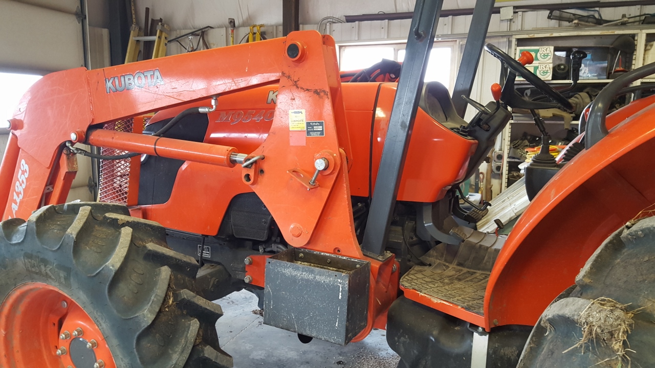

I doubt that it's easily removable as in Quick Attach, but I can't confirm that. Don't recall on my friend's tractor. Post some pictures of the area where the FEL attaches to the tractor and we'll try to figure it out.
Something like this. You can see by studying this picture that my FEL removes without tools simply by removing a large pin on each side.
