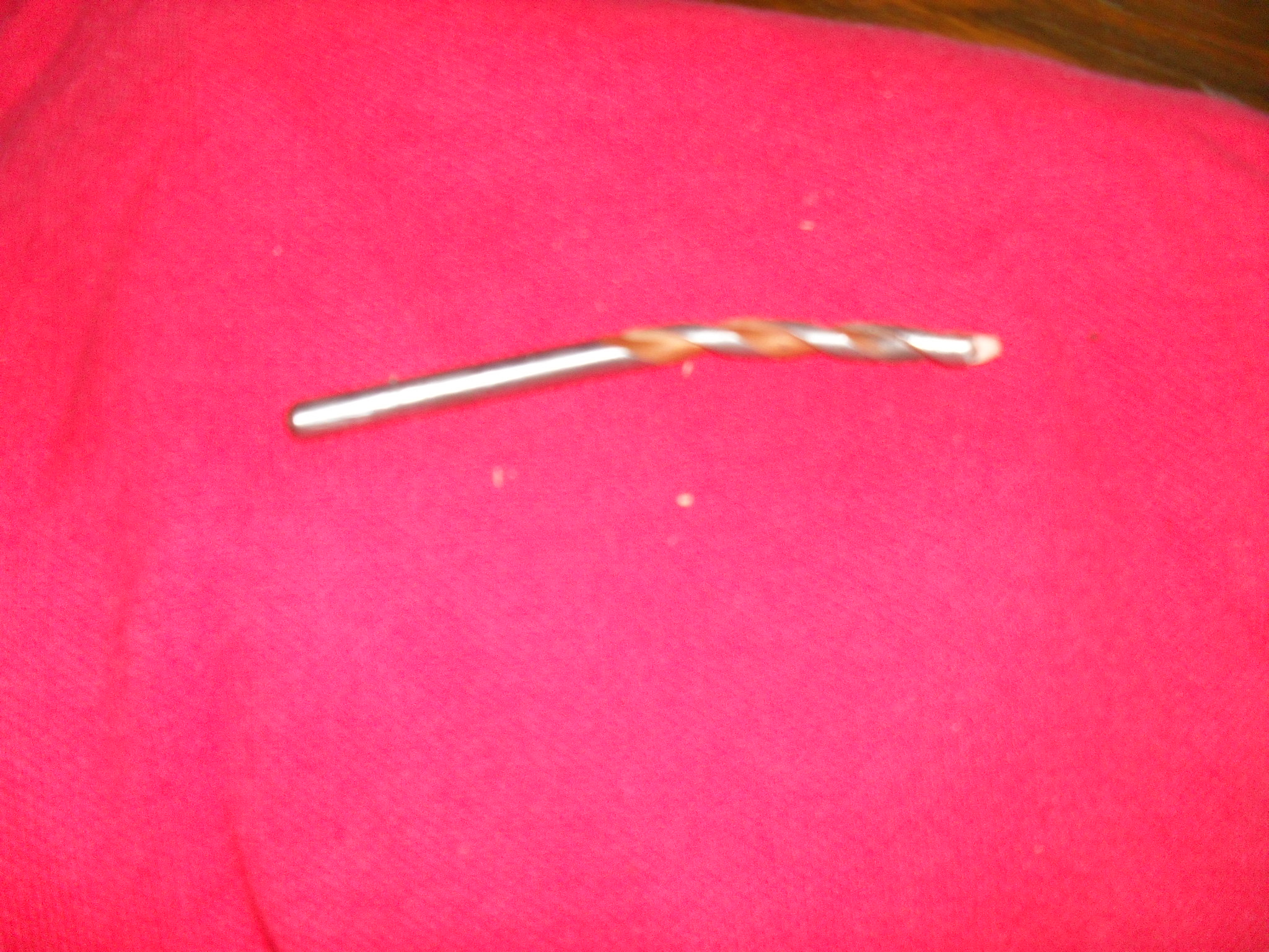

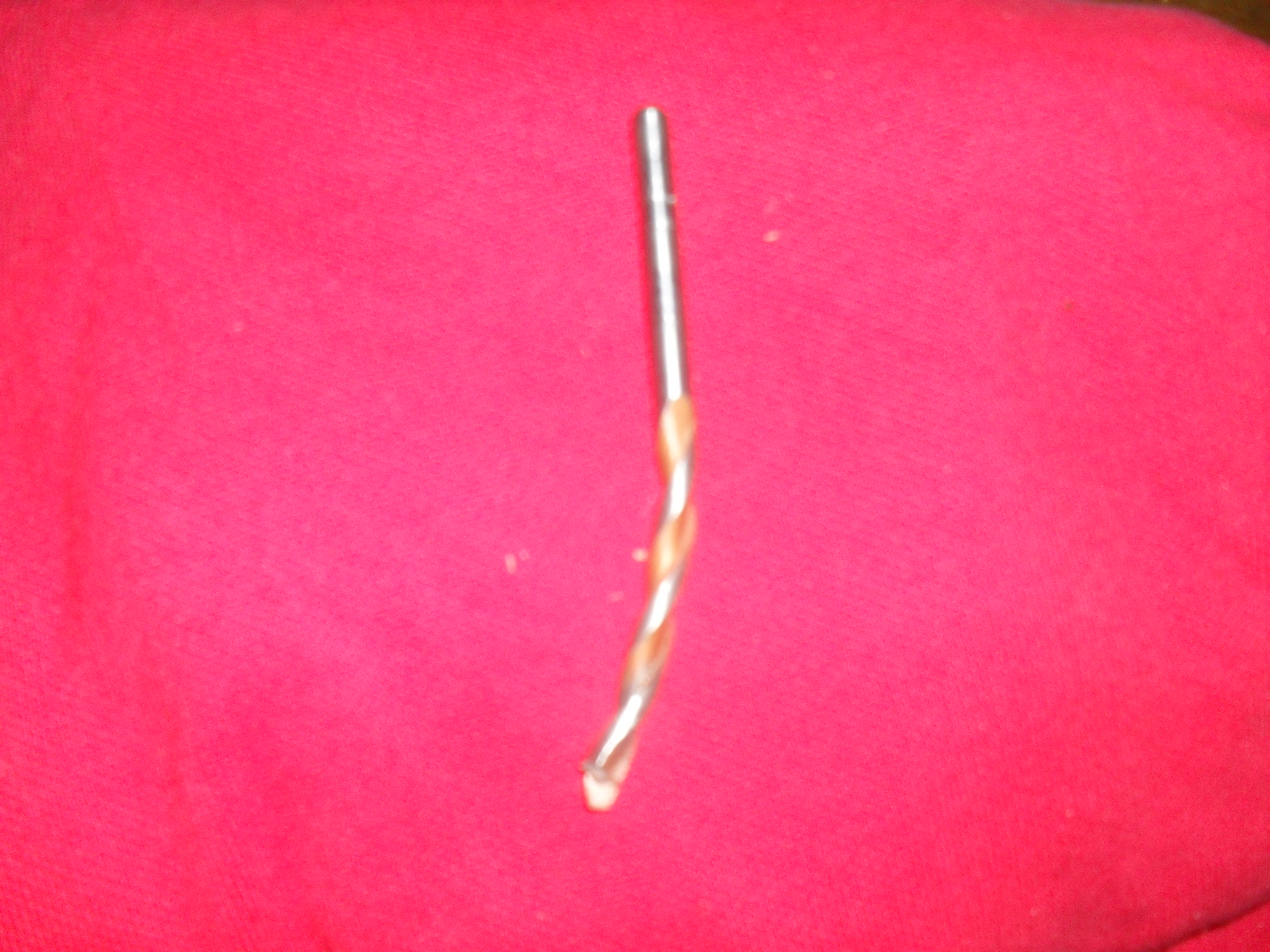

Drilling a ball bearing (4" diameter ) whilst making a Trophy for a friend who has just written his Vauxhall VX220 off :)
The drill was cooled during the drilling operation but not enough as the end snapped off the bit whilst drilling about an inch in and the bit caught in the hole and started spinning the ball bearing which was slightly out of true on the bit. Before I could hit the off button on the stand drill, the bit bent as it was so hot and the ball spun it into the shape below.
The upside is that the bit is gaurenteed for life so I'll just post it back and they will send me a new one FOC:D

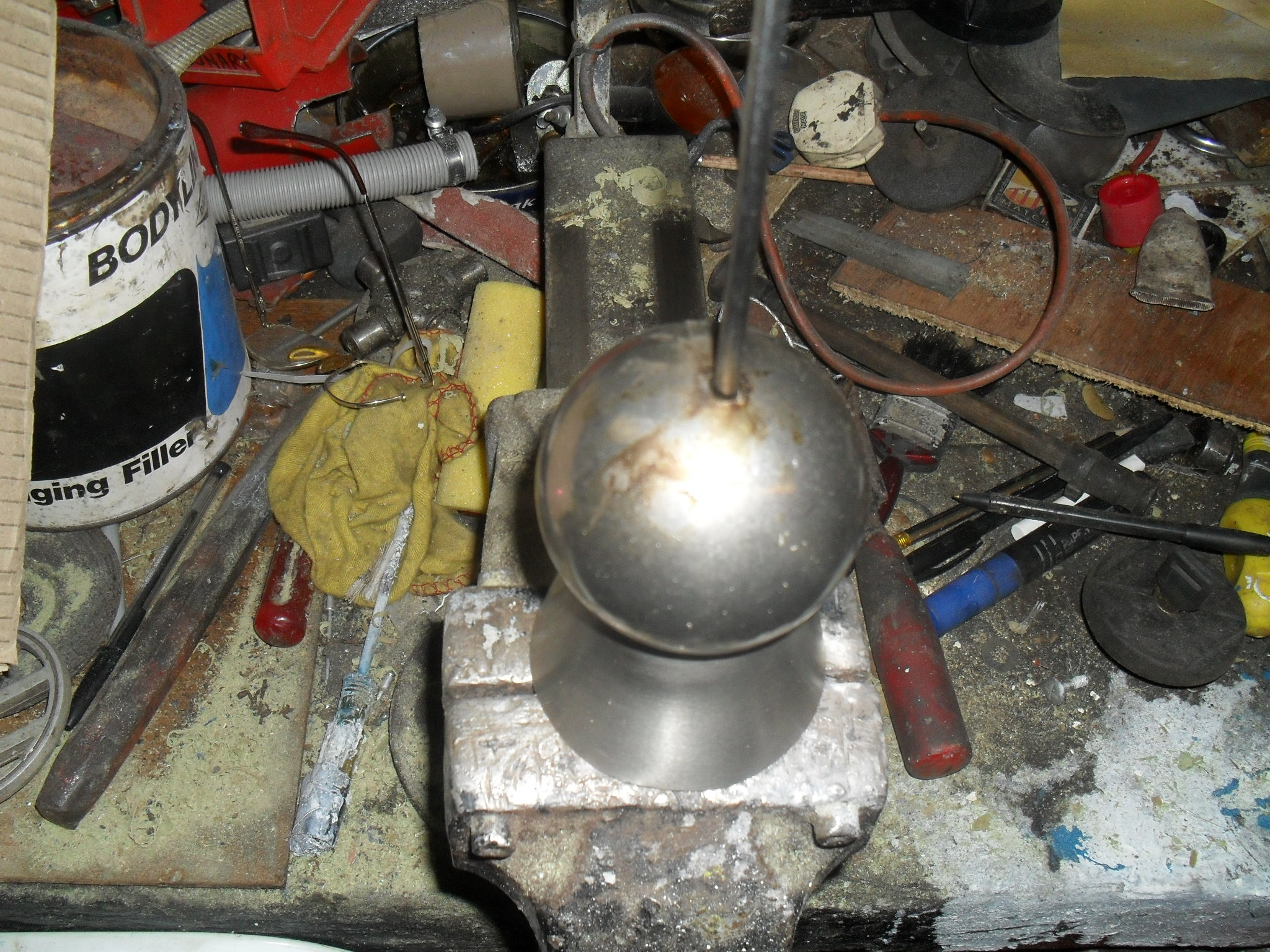

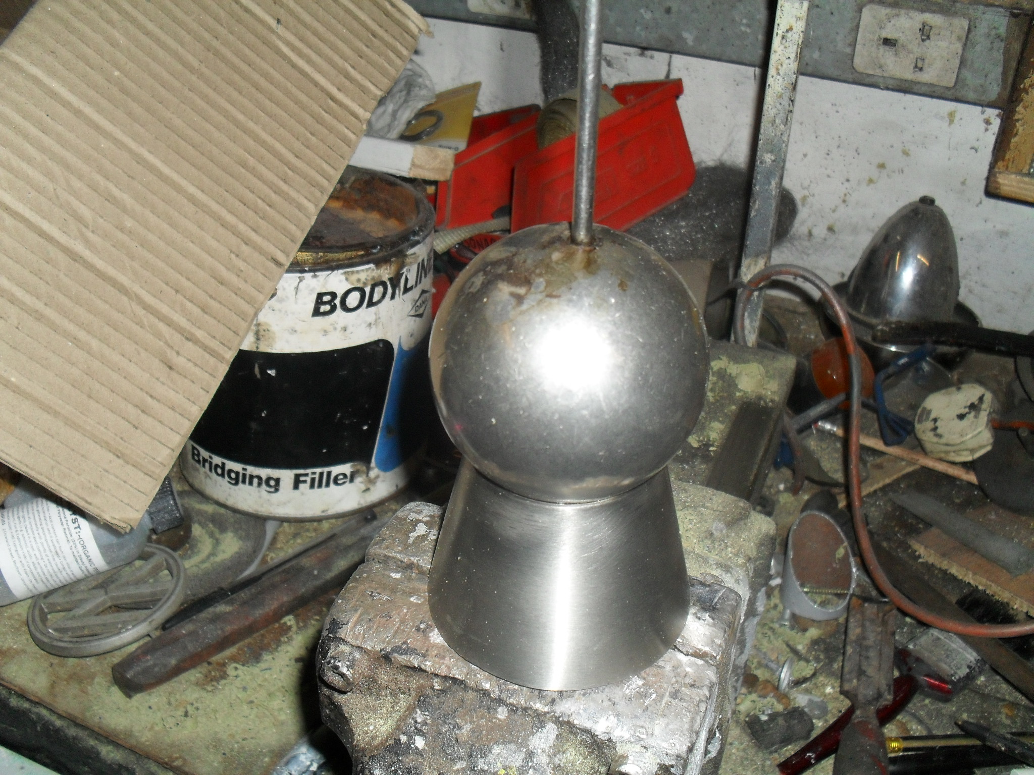

Heres a pic of the unfinished Trophy with the rod soldered in ready for fitting a broken piece of alluminium wheel on top

Drill bits are hardened and break - they don't bend. You don't have actual drill bits there, they just look like it... :) Never seen a drill bit bend like that without breaking.

Just like to point out that my bent drill bit has done a lot of work in the past year that I have owned the set. (british made btw:rolleyes:)
Also that my bent drill bit did drill an inch deep hole into a hardened steel ball bearing which my other drill bits would not even scratch.
You will notice that the end of the bit has snapped off leaving the peice inside the ball.
Probably my fault for not securing the ball before drilling but hey...it did the job and I'll get a brand new drill bit to replace it.
The drill bit was dragged out of shape by the ball spinning out of true on the end of it after the bit snagged and jammed in the ball.
I can only think that the bit was so hot that its shaft was softened allowing it to deform after the hardened cutting edge had snapped off.
Unless anyone has a better explanation:anyone:
