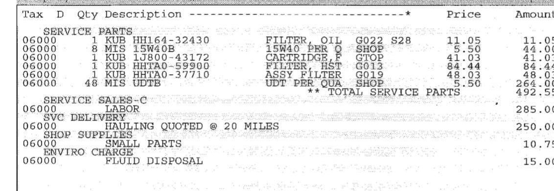

I got the owners/operators manual and other than basic checks and greasing fittings only calls for engine and HST change along with filters. Manual also calls for Super UDT, but written quote from dealer lists UDTB "B" for bulk. I'm going to suggest OEM filters and TSC, Rotella T4 or T5 synthetic 15w-40 Looks like there are 2 HST filters, is this correct? See attached dealer quote for $400+ in parts.

RickB, Ford850, ljjhouser, and I would probably feel better for your wallet if you posted a copy of the Maintenance Service Intervals page that shows a change of the HST oil is called for at 50 hours as opposed to just replacing the filters. I have access only to the L45 and MX4800/MX5200/MX5800 operators' manuals that call for filter only change at the first 50 hours and HST oil and filter replacement at 400 hours. The MX5400HST manual may call for a change at 50 hours, but $264+ is an expensive mis-reading.
Wow!
That is an insane quote!
Over $800 (+ sales tax, plus $250 transport), and I can do the same job myself, with all new filters and SUDT-2 + Rotella T4 or T5 Synthetic 15w-40, on my much larger Kubota L48TLB, for $344.
My tractor has not, and will not, ever see a dealer for a fluids change!
If it were me, I would use SUDT at the required intervals. Once upon a time ... I bought a Kubota L3800 HST at 69 hours. The HST was whining much more than what I figured was right. I did a lot of research and found that it was a common problem, and the advice was not to use UDT, but to use SUDT which was a special spec that Kubota felt was the best answer. It often reduced the noise for others and partially for me, but not enough. I ended up selling the tractor with 109 hours.
The point is that UDT and SUDT are not standard hydraulic oils. I buy TSC Premium hydraulic for my other non-HST tractors - works well. But I would not want to end up with HST problems because of a non-Kubota oil. That way if noise gets annoying, you can put the blame on them.

When my M59 needed filters and fluid changed went to buy them. Fall the dealer offers 10% discount on parts and labor for their slow season. Casually asked how much they could do the service? They can pick up and deliver, change oil and filters for what they can sell me the oil and filters for! Their cost for super UDT in bulk tote offsets the labor and transportation. Allows them to keep their employees busy. They also washed and greased the tractor. Win win.
