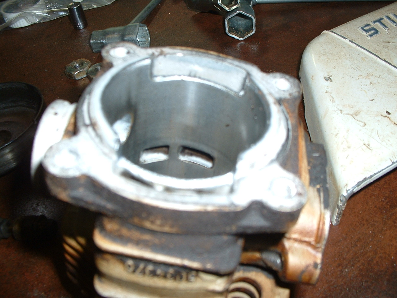

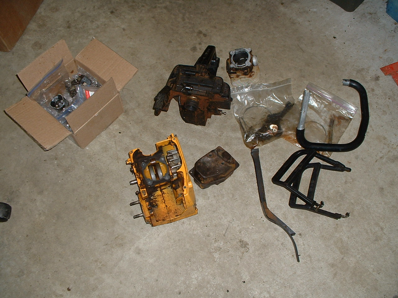

More junk cluttering my bench today. Poulan 425 opened up for new bearings and seals.
Decided to do the same thing to the poulan 475 I was building too. Could feel a little roughness in the bearings. So better safe now then sorry later.
