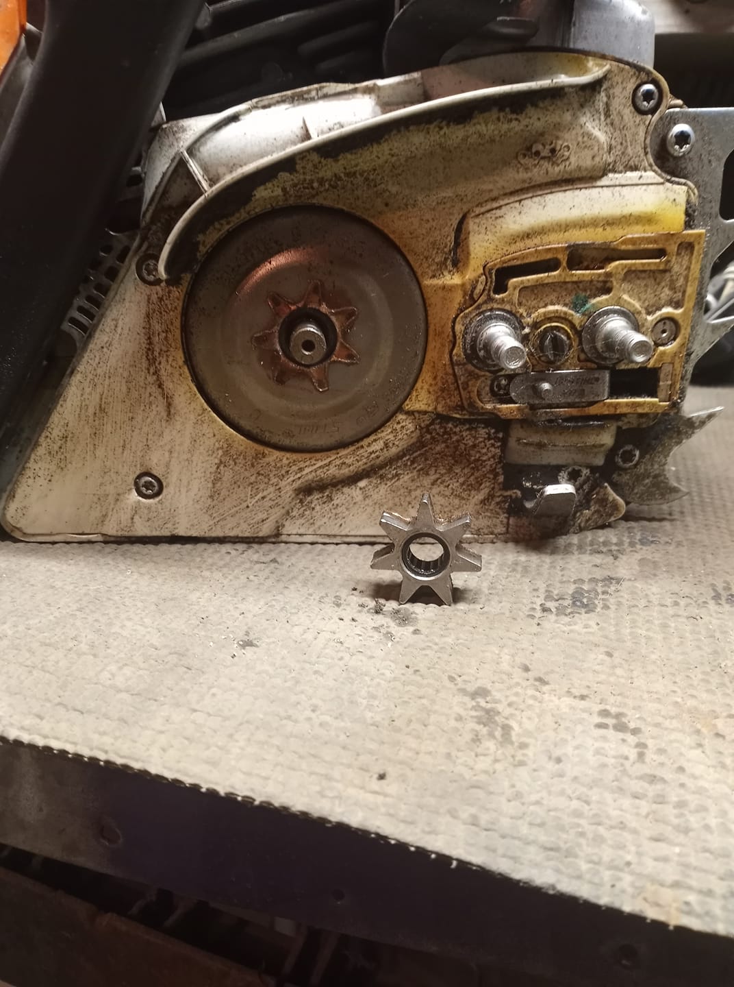

Guy in chainsaw repair group just showed us his 2 month old stihl he bought for his uses. These list for $399 for a 50cc plastic clamshell saw.
Least a easy fix.
/ Just another junk chainsaw #946
Least a easy fix.
Thats the sprocket one gets with a $400.00 Stihl saw, Husky have rim sprockets, my cheap 501p Echo also has rim sprocket.....

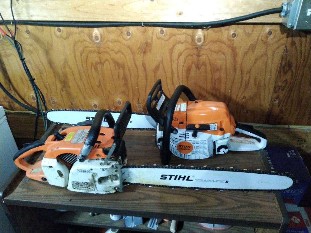

Bought a new 261c, it's time for the 032 to retire to backup status.IMG_20210211_202234.jpeg

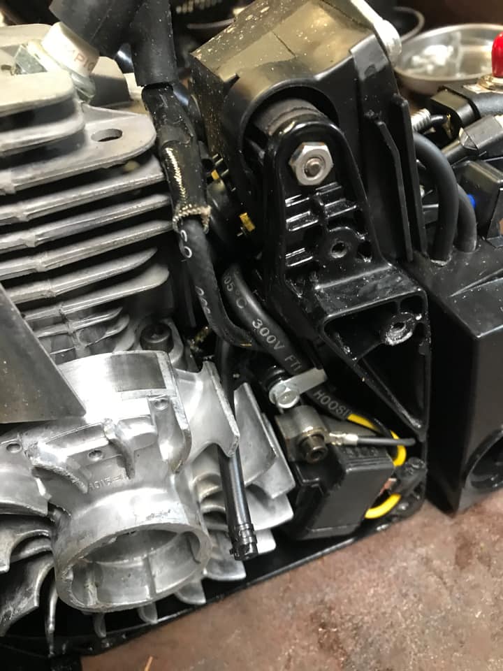

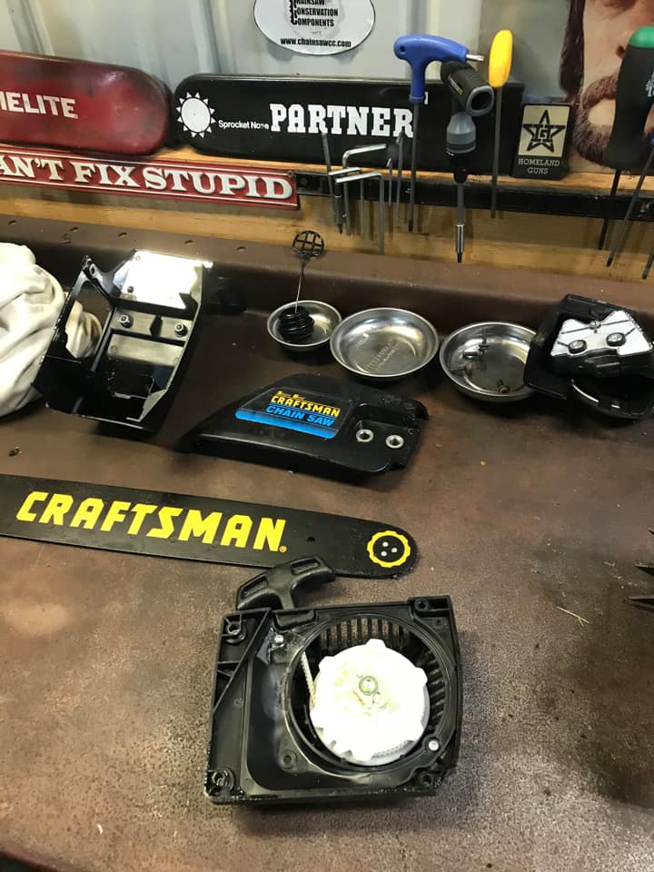

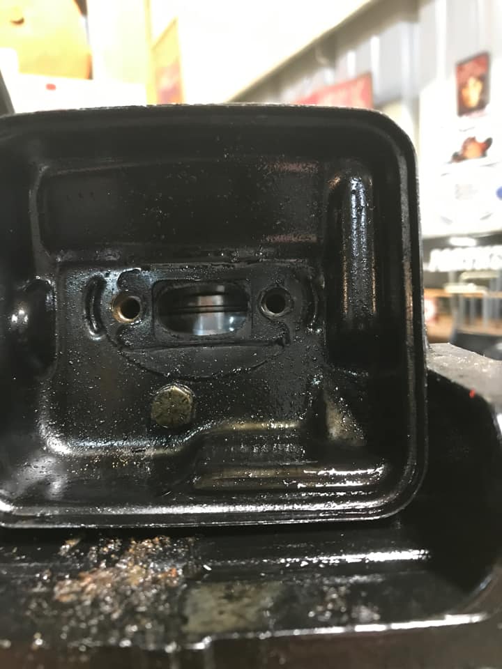

Local bought that NOS 3.3 I knew about Nov 2020. He couldnt get it running right so I took it in for a look after changing lines and carb kit.
1996 on tag
Saw came in saying only run on half choke. Choke off just for few seconds.
Soon as I seen the tank vent routing heading under air filter I pretty much knew what I would find.
All good now. He had line routing wrong. Didnt run impulse line. He had run tank vent to impulse line.

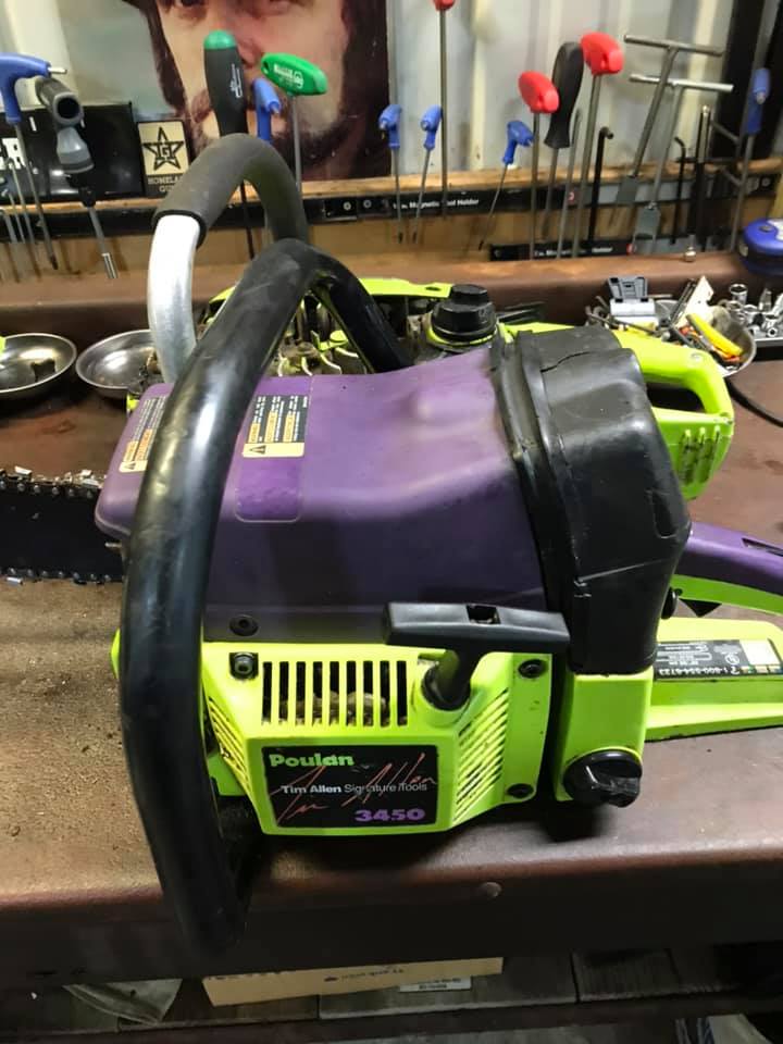

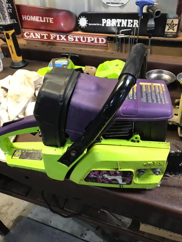

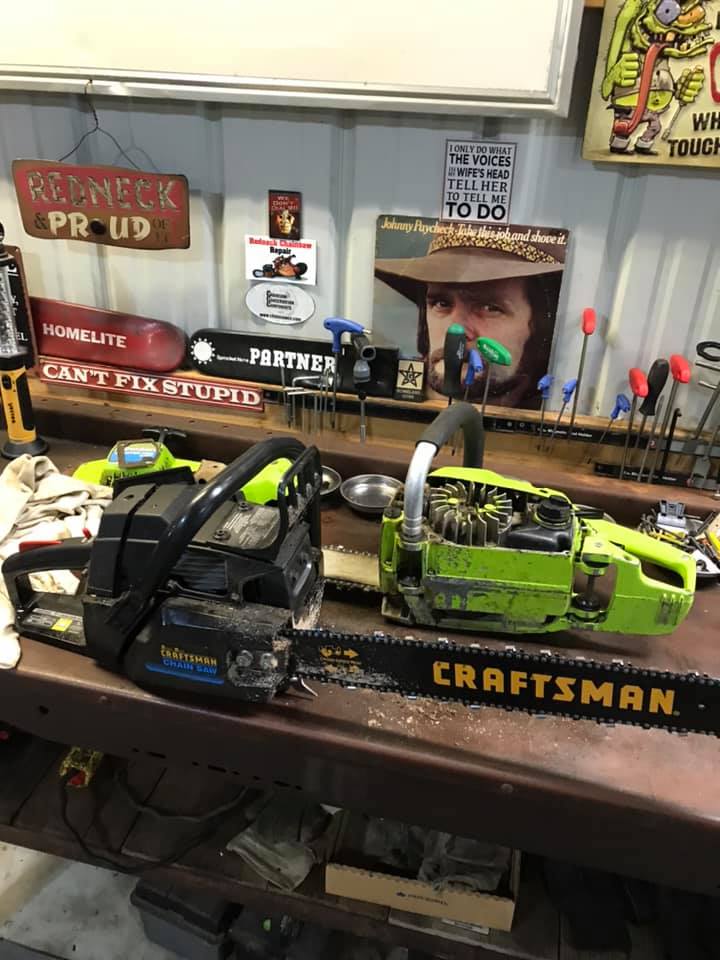

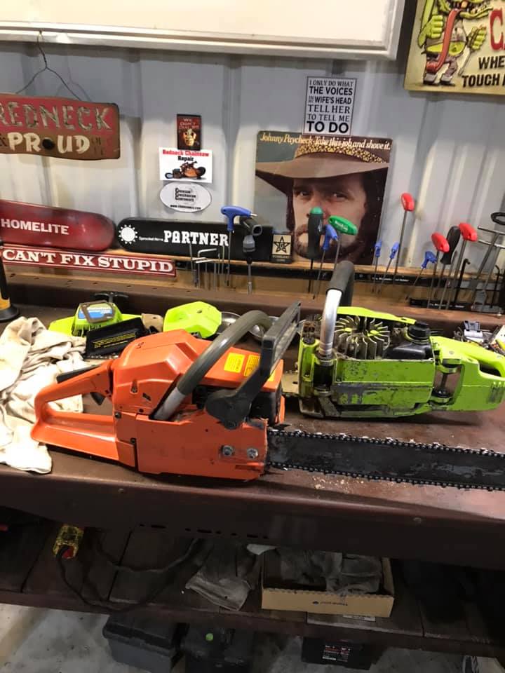

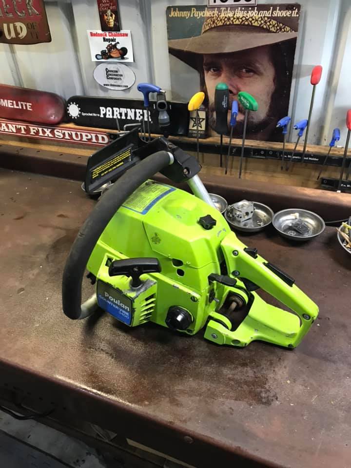

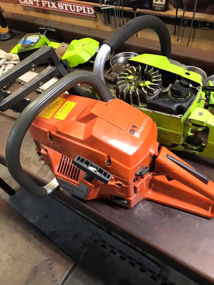

Some trade in's yesterday. Now to see whats up and move them.
The NOS 3.3 was also traded in after 2 tanks of cutting. He wanted a bigger cc saw he tried out.
p3450bbtaa.jpgp3400x.jpgc33noss.jpgc33nosss.jpgh51t.jpgh51m.jpgh51r.jpgh51cc.jpgp3450bbtaaa.jpgp3400.jpg
