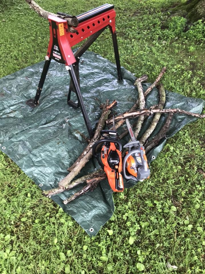

Just playing to see how she acts unlimited in same wood I tested in with limited coil. 3/8 8T
Pushing hard in cuts testing. Was able to pull down couple times.

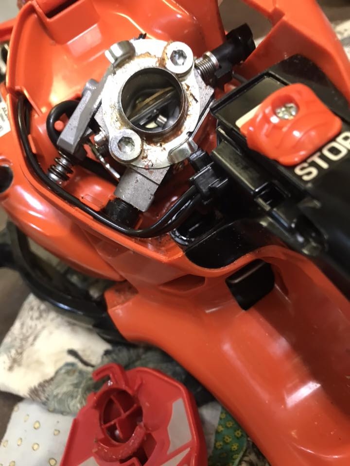

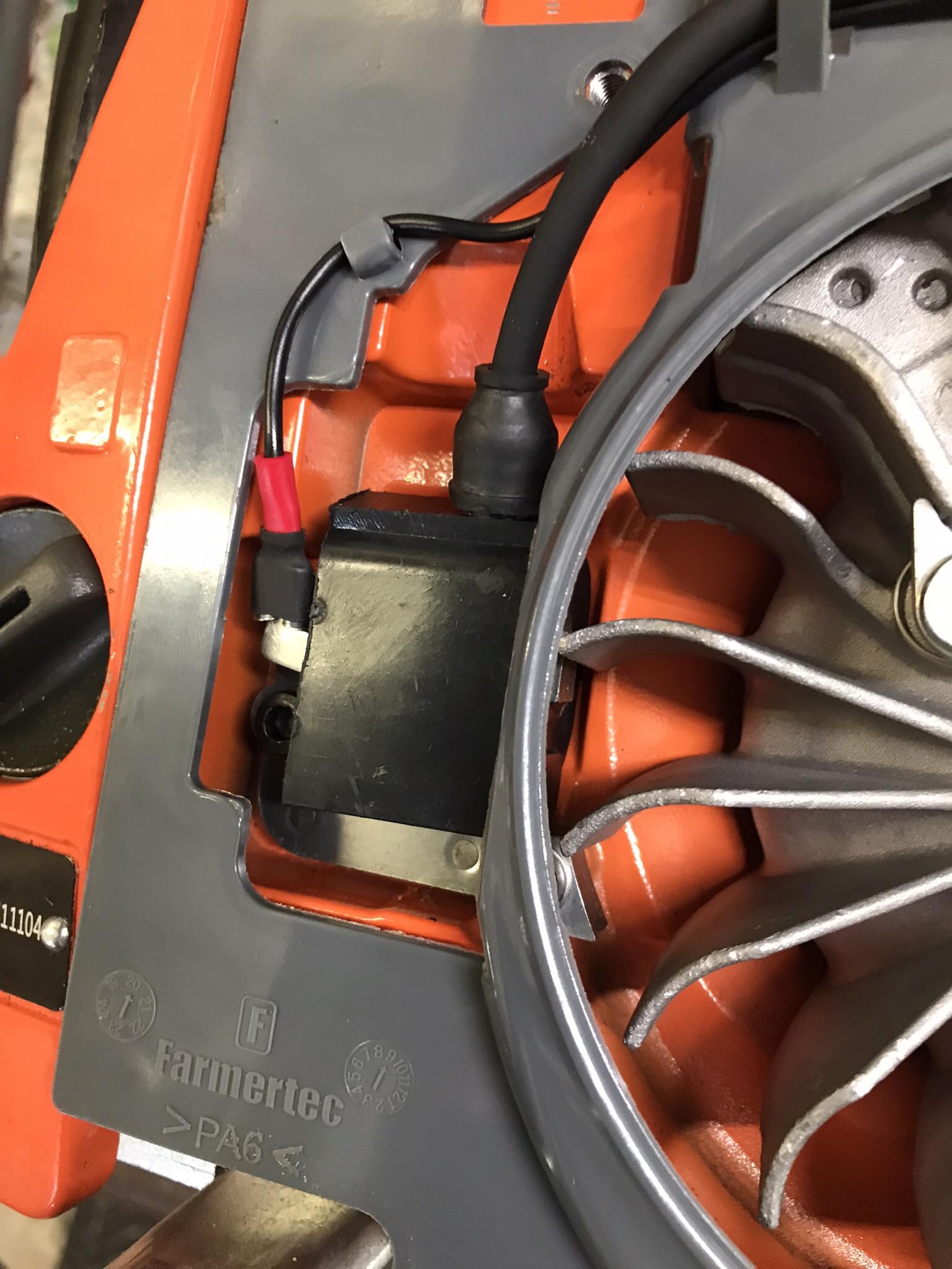

What is the right female end for the coil connection?
Changing mine back forth and got in hurry pulled dang thing apart.
My redneck quick fix with bigger end I had on hand.
   / Just another junk chainsaw
#2,523
Never mind on question got answer in my CRG already.

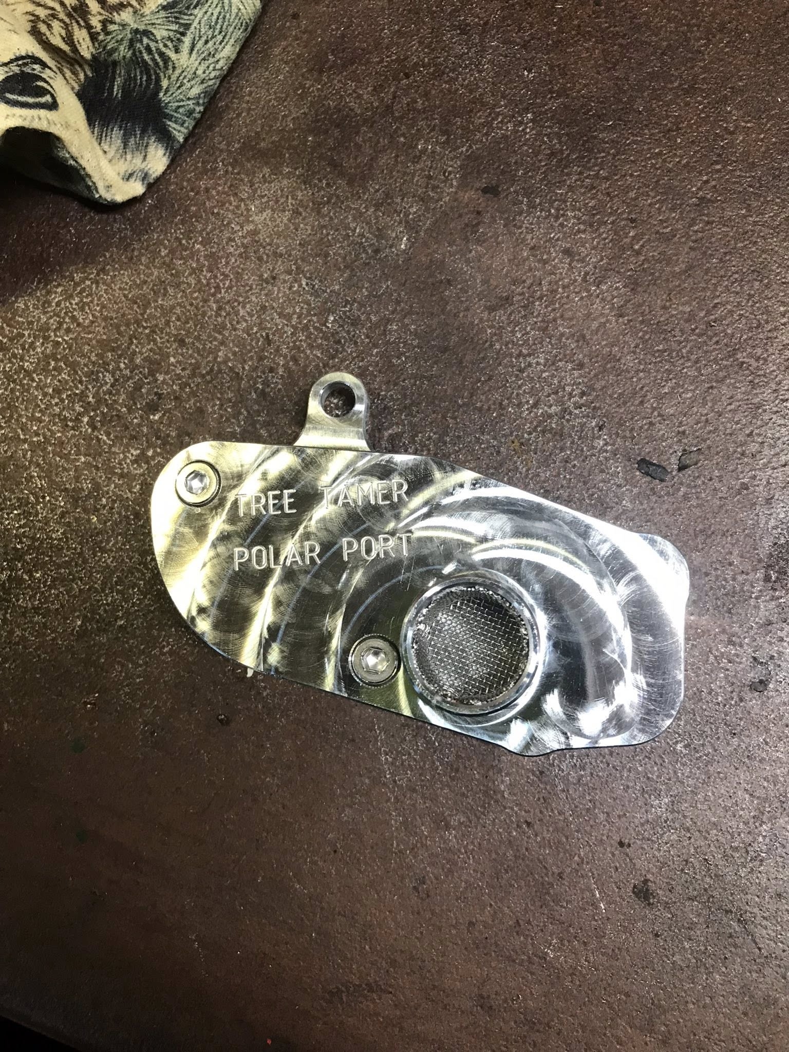

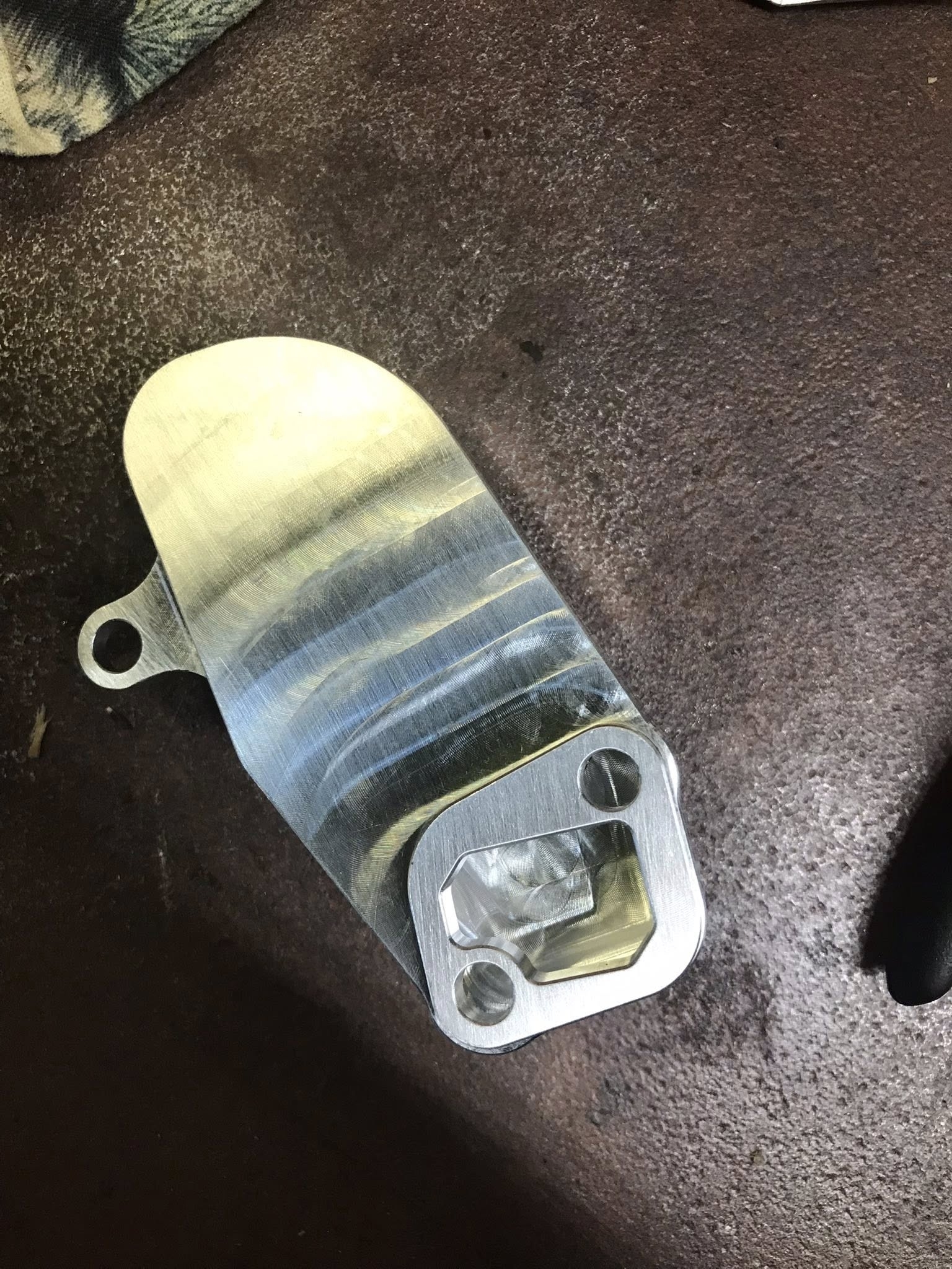

Precision saw service NY cnc 2511 muffler V2 showed up this evening.
$49
Also comes with spark screen for those worried about that.
I think she really flow compared to the other cnc muffler being offered.

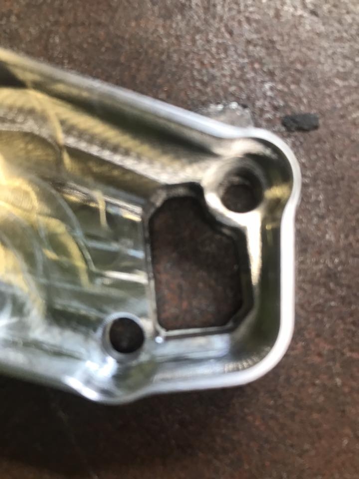

Did some measurements on the ID of the pipes on clone, Egan and PSS V2.
#2,526
Getting ready to test a oem stock muffler, clone muffler, egan pipe, pps V2, wcs ones.
Prob have the wcs one next week to throw in the test.
Also in thread in my group. The PSS V1 that was made before the V2 by the NY member was 11mm ID to compare. So it was just hair bigger then clone ones.
Glad he made the V2 ones shown size above. Another guy in my group said he is doing 17mm on his ported ones.

Make sure you trim oem gasket. Heat shield I would imagine too. If the ext outlet is size of new muffler.

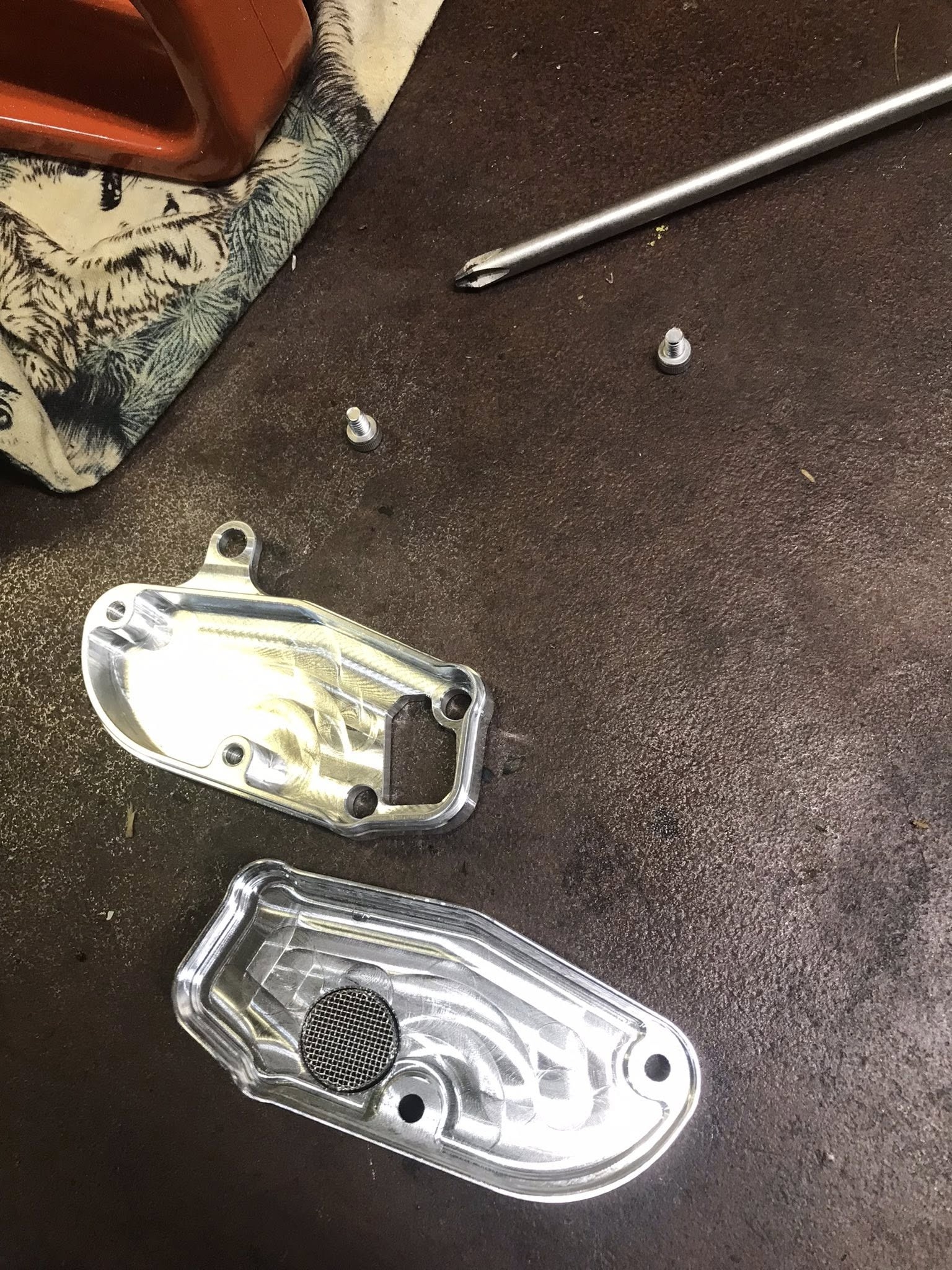

Just to show. Grease catching the fines on my oem one.
If grease isnt there on ech and stihls fines will get by into throats of carbs.
Using both today.
My oem fits looser then my clones because I dont have a o-ring in it.
