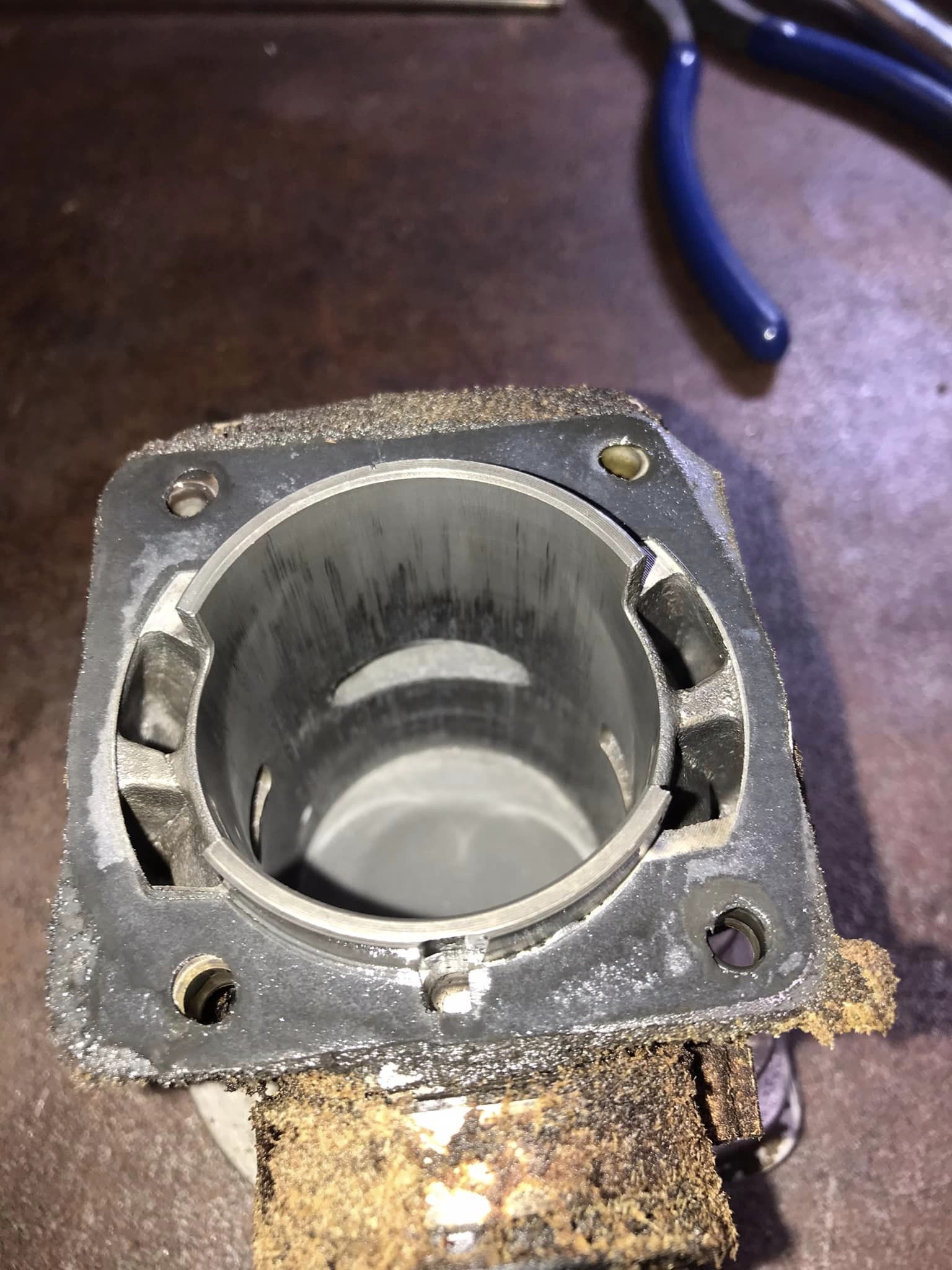

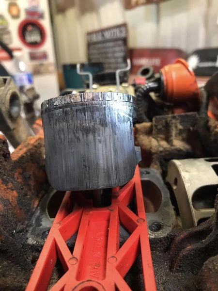

Just a typical neglected saw till she quits on ya.
Smelly old mix, plug was loose, muffler loose, 2 cylinder bolts loose.
Scored and finally stuck exhaust side ring.
Imho cylinder will clean up easily.
Just going to order piston kit and different muffler with out the cat. Tired of digging that crap out of them.

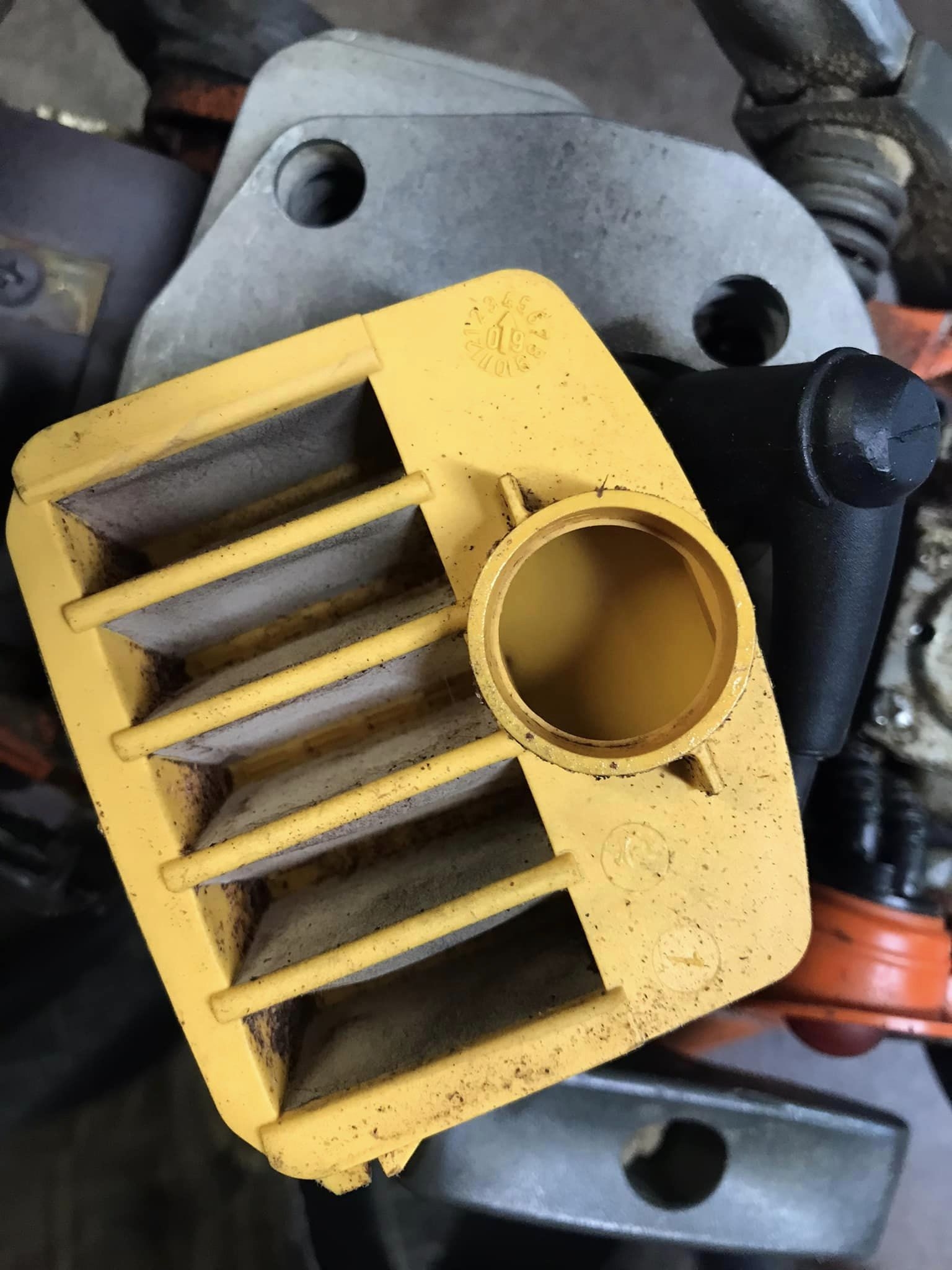

Mesh filter was doing its job. No fines in throat.
2009 346 etech

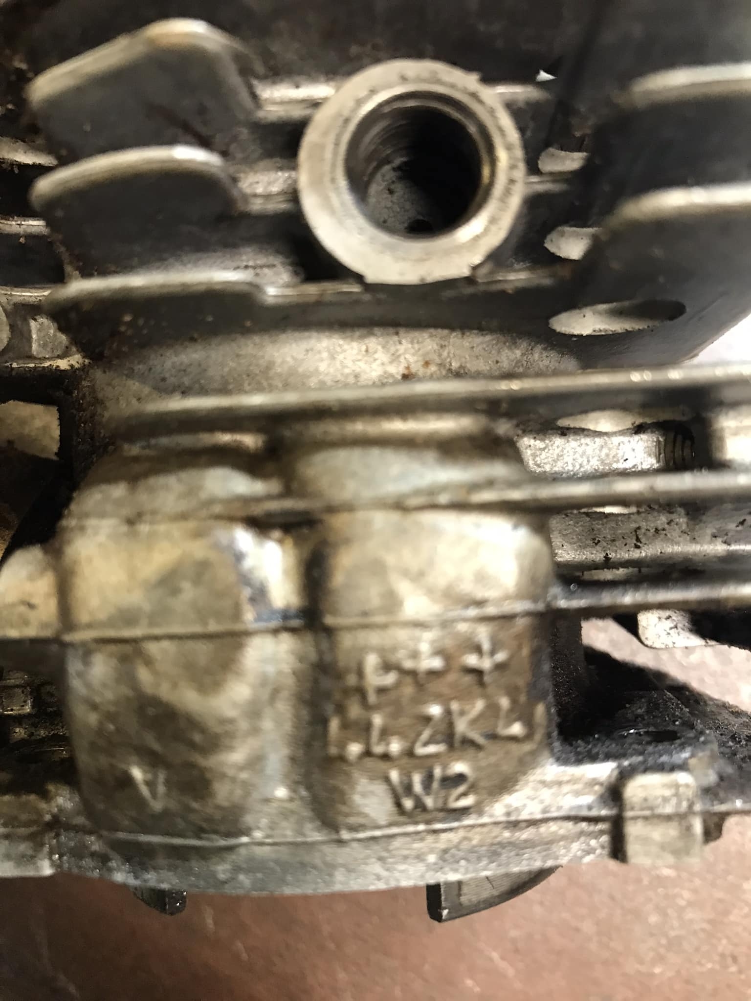

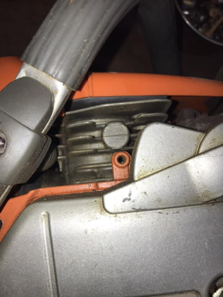

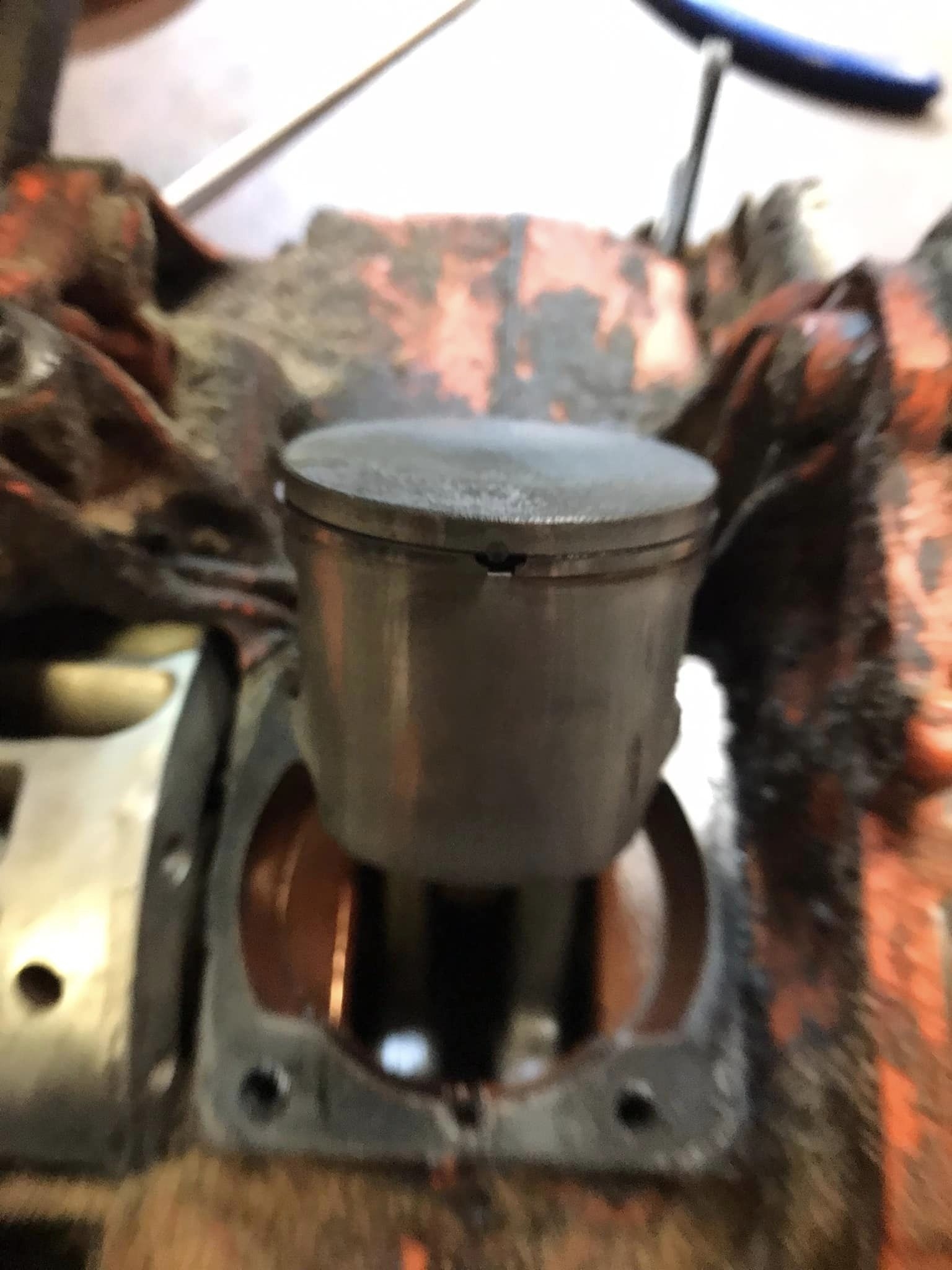

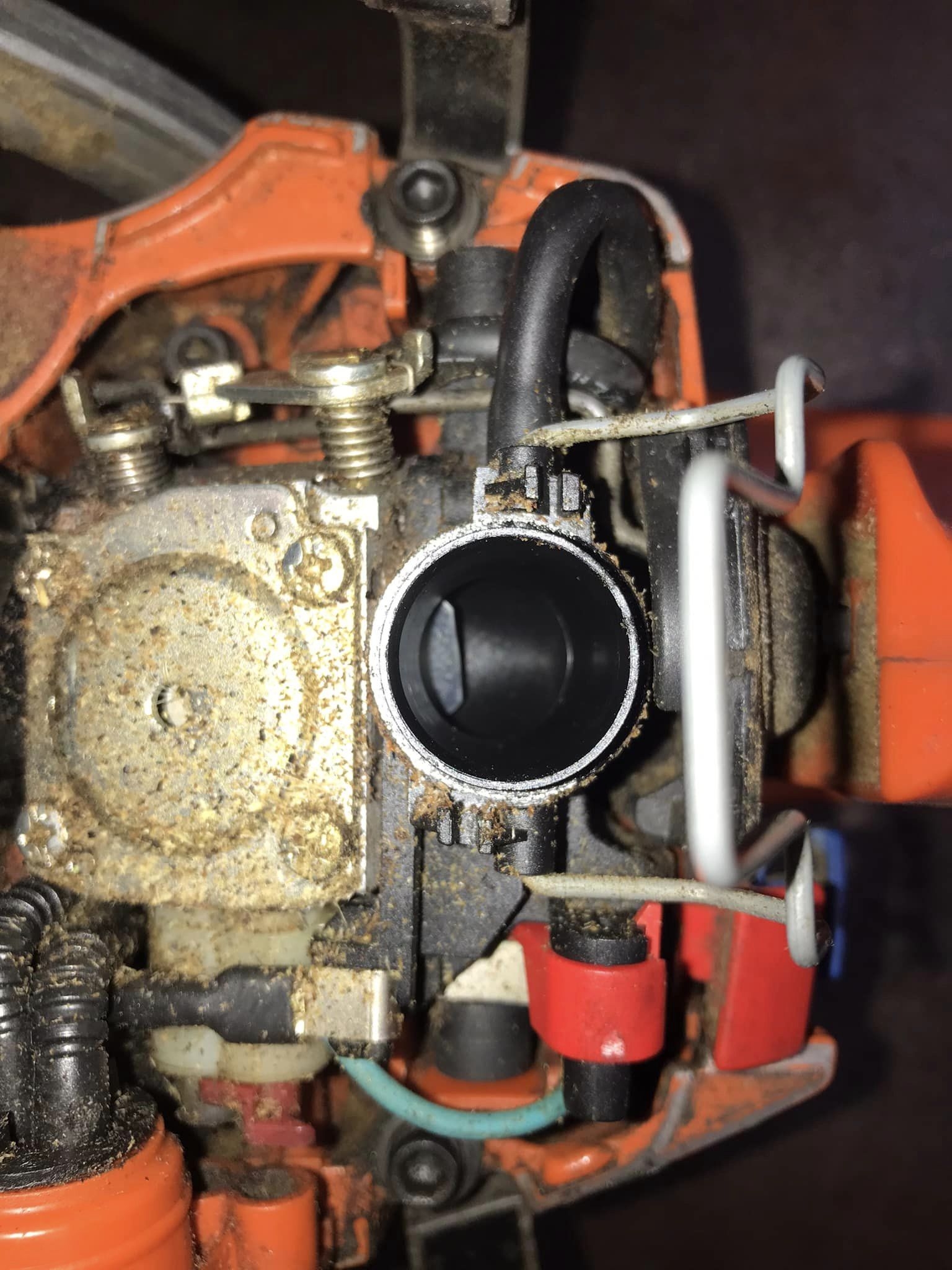

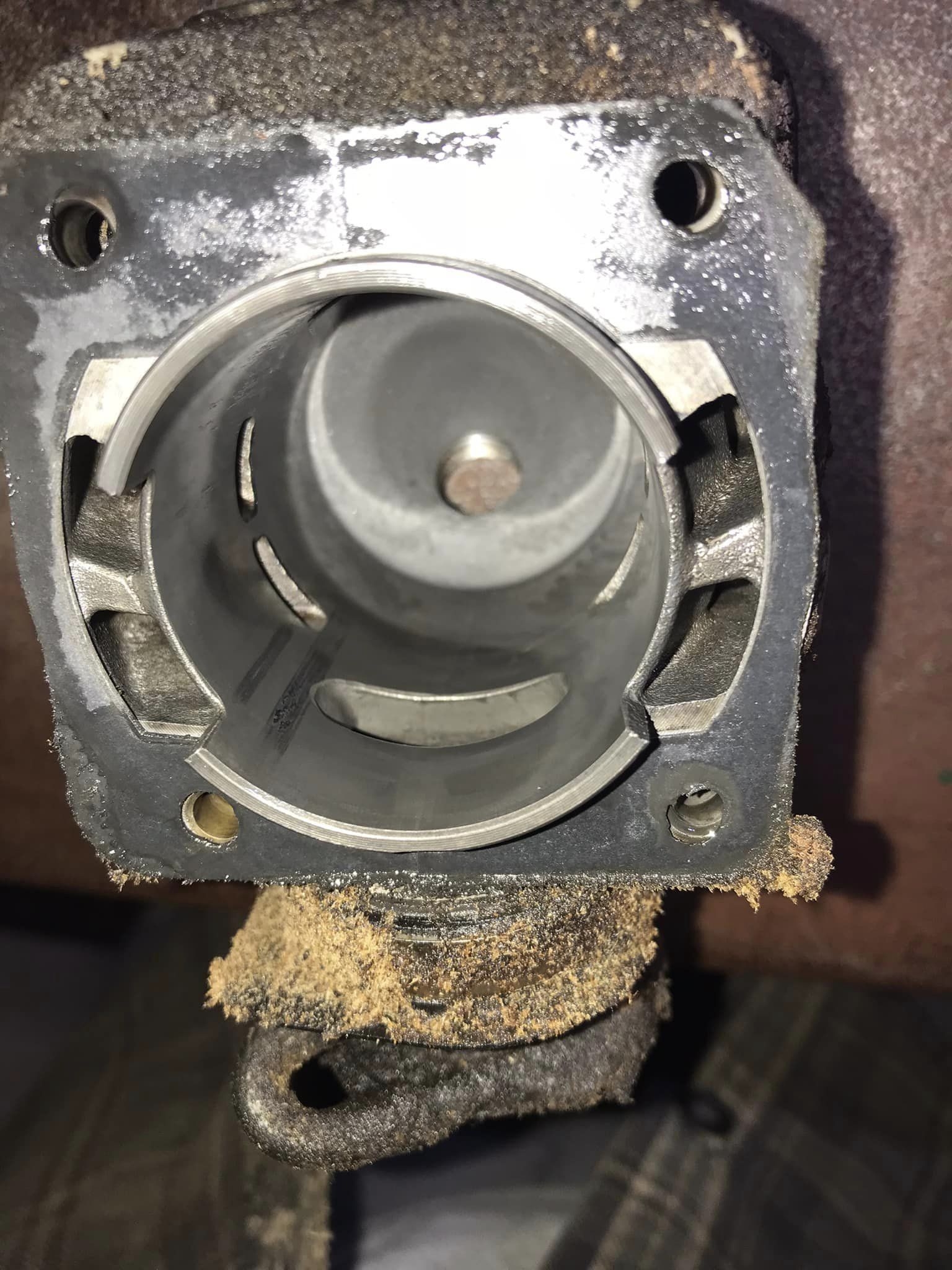

2009 346 etech
View attachment 1678880View attachment 1678881View attachment 1678882View attachment 1678883View attachment 1678884View attachment 1678885

Parts already ordered.
So nope will sell after done and have a line already from my CR group and a local that bought my last OE one.

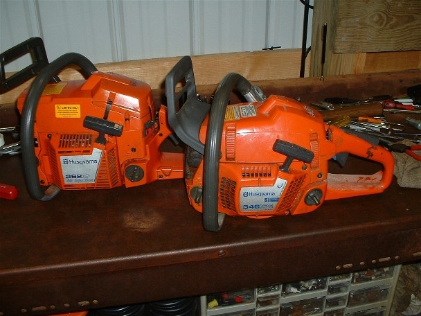

Here is 2 NE 50cc ones I bought later. 2009 and 2010
One of them he gave me credit for b+c. I dont need the crap stuff they came with.
