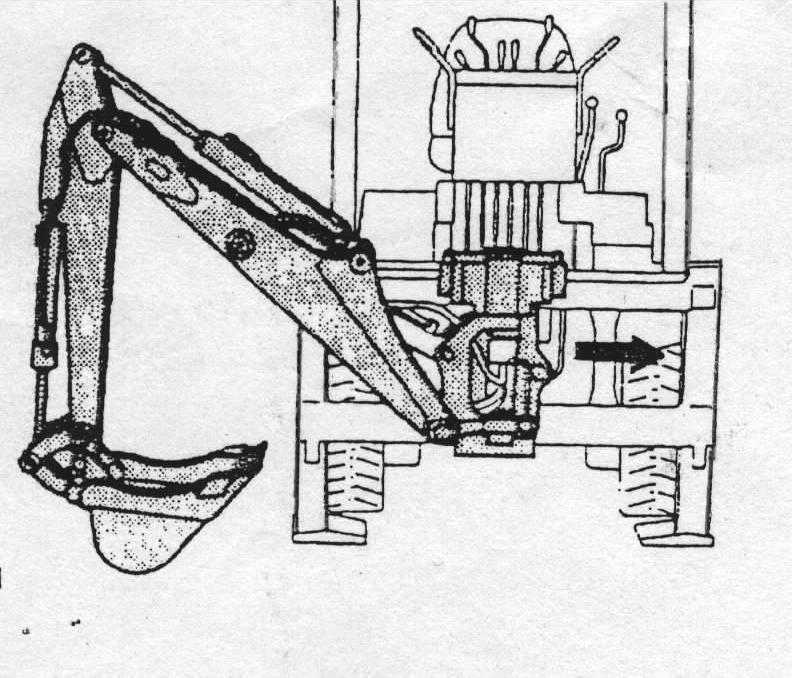

Hi All
I have the Kubota JR900 backhoe fitted to my L35 and are having real problems with side shifting it for side-digging, it is in the middle at the moment and I've followed the manual instructions to the letter, but it still wont shift. Has anyone else had this problem ?
Regards
Chris

Chris,
I have never seen the JR900, so this is a WAG. Is it perhaps pinned like the boom to keep it from shifting when not in use? What does it do when you attempt to move it, lug down or just no response?
Al

Hi Al
There's no pin, it's locked via a hydraulic switch, and I can hear this moving when I operate the switch so I think it's working ok. And what happens it that the whole tractor moves instead of the b/h sliding on it's cradle.
Chris

Chris,
The tail wags the dog/w3tcompact/icons/smile.gif. If this happens in both directions I would suspect the hydraulic lock. Sorry I was of no help and I'm out of ideas. Hope it something simple . Good Luck.
Al

I think Chris has a "side shifter" the boom is attached to a side-shift mechanism, a bracket that can move the entire backhoe boom horizontally on a cradle. I have never seen a JR900 so this is a guess from his description and his location.
Al

Al was spot on in his description, I've attached a quick scan of the backhoe, this model (JR900) is standard equipment in Australia, it gives a much wider digging arc and is compact to transport. The thing is, I have kept mine central for quite a long time, and it just wont move now, I was hoping maybe someone out there had the same model and knew of some trick/? to free it, but prehaps I'm the only one on TBN with this backhoe, I hope not.
Chris
