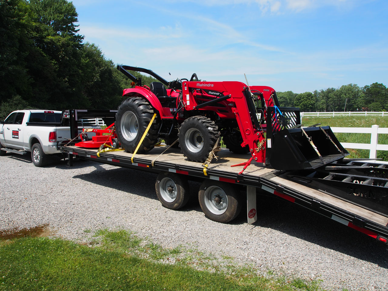

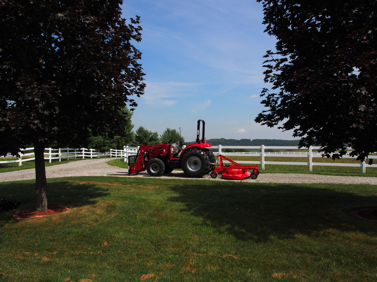

I finally got my new 2555 HST on Friday. I'll try to attach some pictures. Overall I'm very pleased. The tractor is a beast! I took it out on Saturday and did a few acres of mowing with the my new EA 7' finish mower. I couldn't be happier with the mower. The previous property owner hadn't been mowing and the weeds/grass were up to my knees. I had it set at max height which is about 4.5 inches. Worked great. No problem chewing through the deep stuff. I did go slow since the terrain is unfamiliar to me. The land is mostly flat (by PA standards) but there were a few holes that could have flipped the tractor if I had been moving too quickly. I'll be fixing those come fall. I will be mowing more frequently from now on so I won't be subjecting the mower to the tall stuff again.

Sorry to hear about the throttle issue. It seems like your dealer has his strapping reversed. The chains and binders should be attached to tractor and straps on the loader and mower. Hopefully Mahindra can figure out what is wrong with their tractors soon. I have not heard anything like this on TYM's own tractors. TYM uses a different engine and don't seem to have this problem. Seems like Mahindra might have not invested enough in this new line of engines. They better find and fix this problem soon or people might start looking for a different brand.
