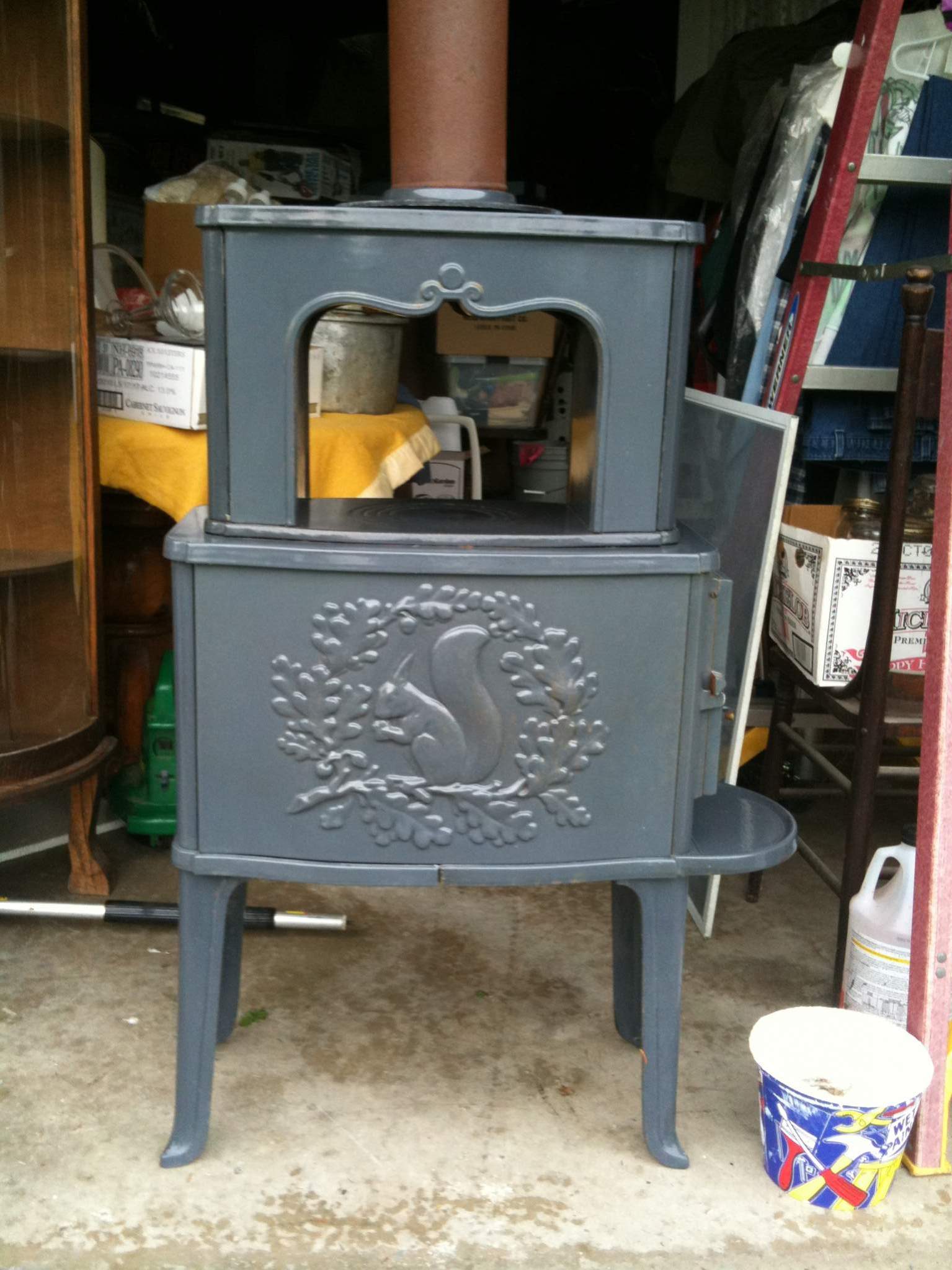

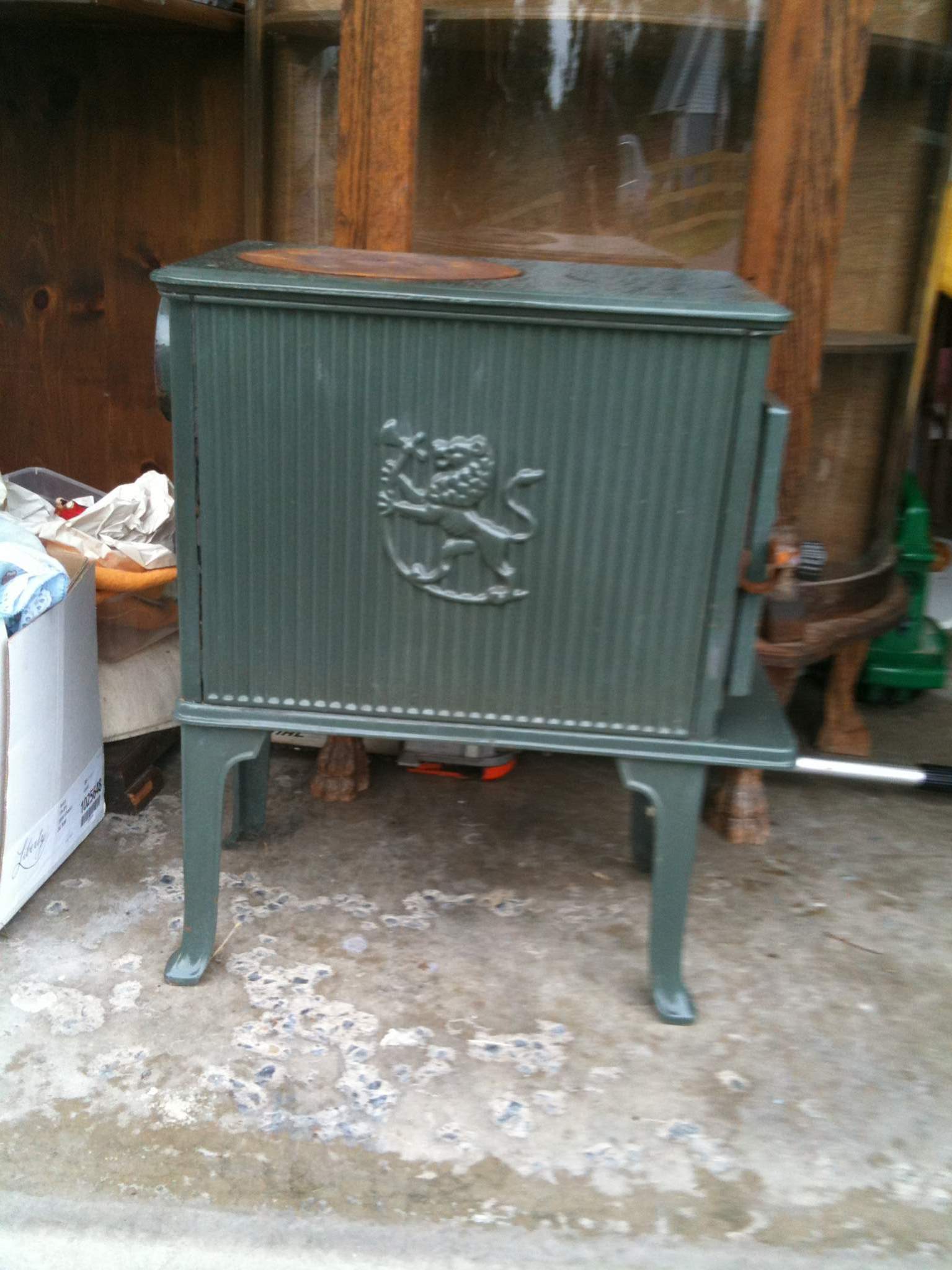

I don't know the first Jotul, a very interesting looking stove, but the second one is a model 602. Here is a link to the Jotul web site. Jøtul F 602 CB Woodstove
The 602 is a great stove, and I believe that the new one is the same as the older stove and meets EPA standards without airtubes or a catalytic converter. I may be mistaken about that.
$200-300 is about right, provided that the parts, the back, the inner plates, are in useable condition. They are replacable, but Jotul does not give them away and they are cast iron so the shipping can add up quick. Don't ask me how I know.

There are two current ways that manufacturers have been able to gain EPA certification on stoves. A cat converter or air tubes. No other way has been successful in a woodstove. Often, a manufacturer such as Jotul will add one of these technologies to a stove to maintain the use of the castings but still be able to sell the stove. Your daddy's 602 is not the same as a modern 602, on the inside anyway. The only way to know if the stove is EPA compliant is to read the tag on the rear of the stove. No tag = no certification = not legal to buy, sell, install, use, etc is most parts of the US.
The tax credit is not 1500$ towards a new stove. It is a 30% rebate on the value up to 1500$. So you would have to buy a 4500$ stove to get the 1500$ and that is a very very expensive stove.
The new 602 sells for around 1000$. Used should be half that. Used and uncertified should be half again for 250$ and remember that all parties are probably guilty of breaking a stupid law in the transaction.
I particularly like the first one with the cool flue outlet casting. Neat stoves.

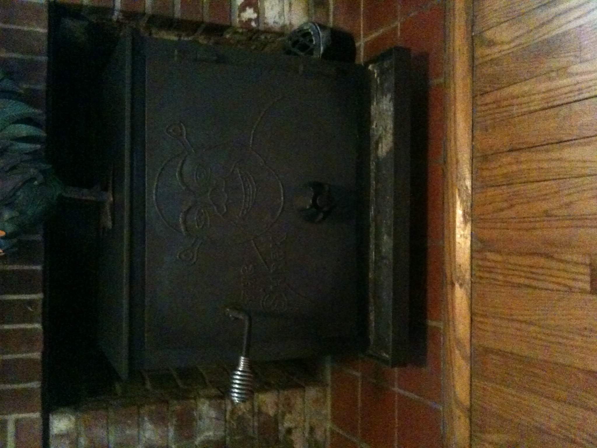

I really do appreciate the feedback!! Hate to get rid of them but also hate to see them rot. Heres a pic of my current stove that two good friends of mine built for me. "The Shrek"

So why is EPA anything a concern if you now have a custom built one?? Did it get certified? Frankly I'd buy one if you were close and put it in one of my shops and to **** with any sort of certification crap.
