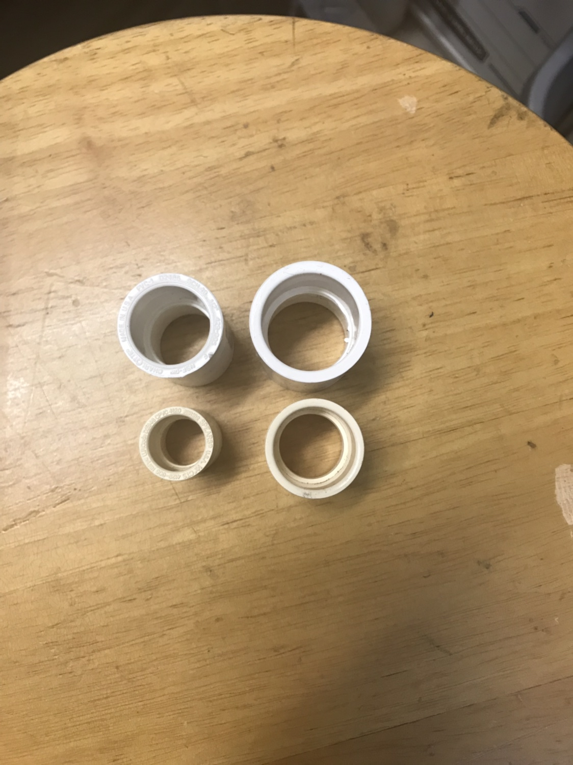

Here’s a 1/2” and 3/4” pvc and cpvc coupler. They’re not even close to the same. View attachment 710726
Yep it's different because it's Copper tube sized like I mentioned earlier. Horrible to deal with when it's 50 + years old, every piece I ripped out of my house literally exploded in my hands it was so brittle.

No you said they were the same size and would interchange. They’re not the same size. And I do agree 100 percent that cpvc is trash.

Not sure you understand, did you even look at the schedule I linked earlier. Standard PVC and CPVC pipe has exactly the same dimensions. your focused on a little used type of cpvc that is based on copper tube size that is no longer used by professionals in new construction.

Every CPVC I’ve ever seen was smaller outside diameter than pvc. You’re right it’s not used anymore because most people are using pex but you can go down to the hardware store and buy a stick of pvc and a stick of cpvc and they won’t glue together. I looked at your schedule you posted but it’s wrong. CPVC and PVC are different pipes, with different dimensions and they will not interchange. It would be just as logical to discuss gluing pex to pvc.
