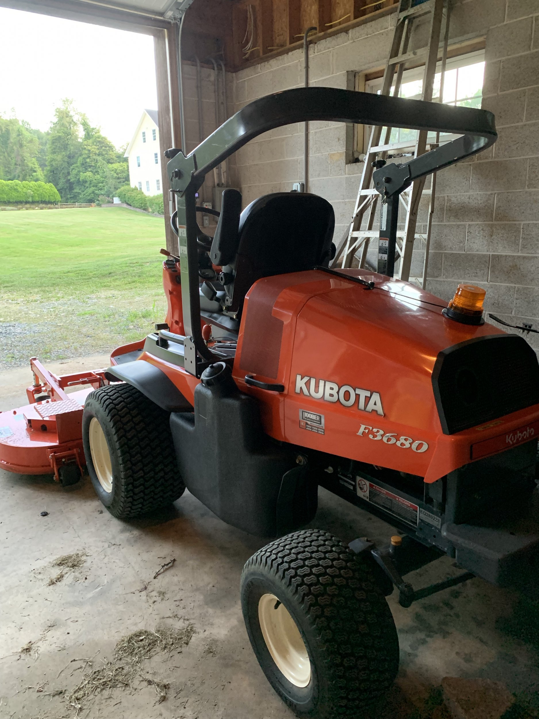

I pretty much am committed to the F3680 now. So much so, I removed my Carlisle bar tires and slapped Carlisle turfs back on the ZD331.

Did another full day of mowing with the F3860. My son is now getting used to the ZD331, so we are now able to knock down mowing time of our big one-full-day customer. I have him cutting the flats and I am doing the steep/challenging stuff.
I was able to cut even more spots with the F than last time. I mowed a bank we used to weed wack, saving is time with weed whacking.
I also learned sometimes it’s better to run in part time 4wd than full time 4wd when cutting sideways on hills. Still also realizing I have a diff lock and need to utilize it more….
I got a compliment from customer on the quality of cut.
Machine has not given me any trouble since I got it back.

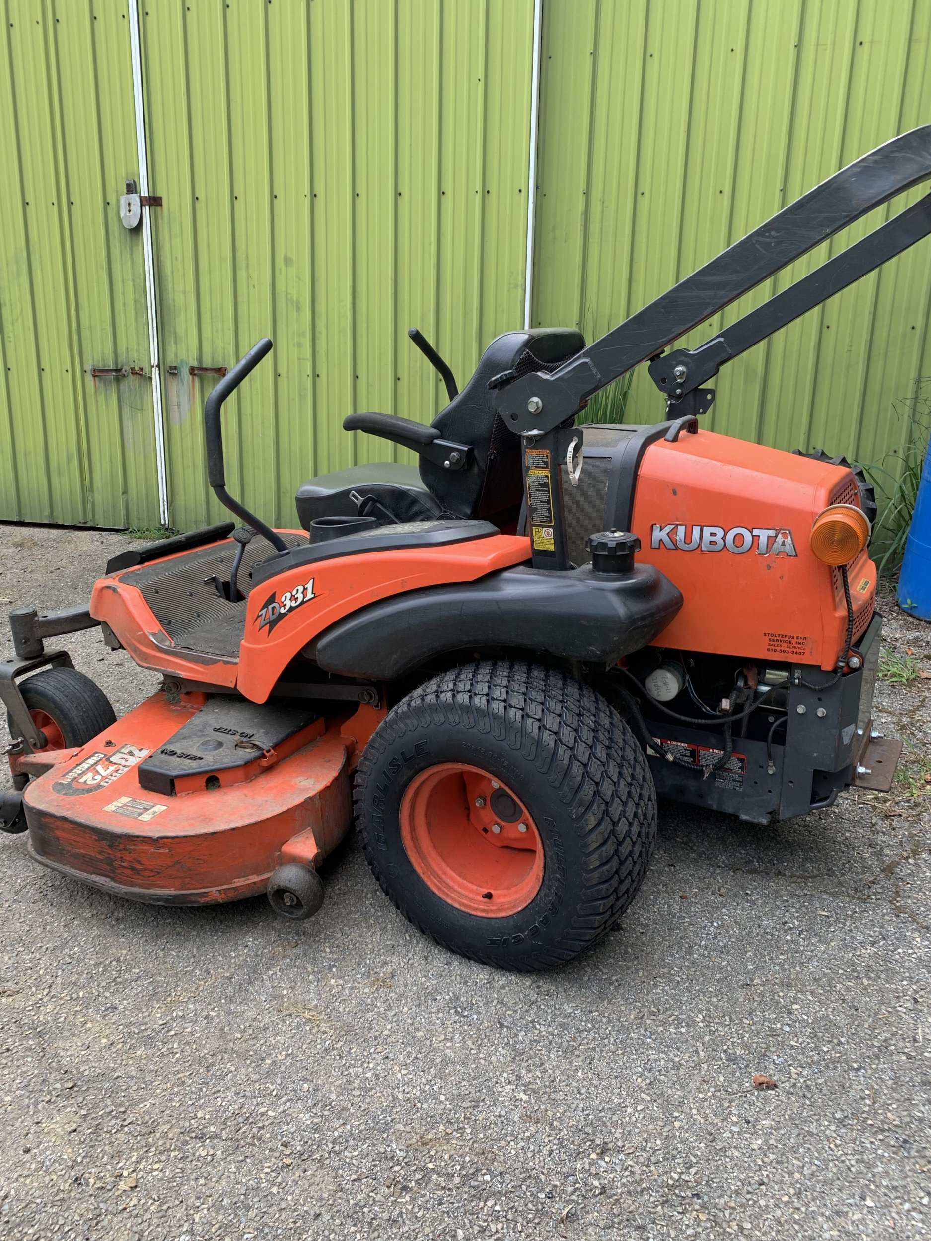

   / Joined the Kubota F-club #68
The ZD 331 traction is much improved adding the optional cast iron suitcase weights in the rear corners. I have some steep areas that I mowe and it has very good traction as long as the grass is not wet. However going down hill I have to be very careful as it will lose traction to make turns. So go uphill is ok and then either go around and repeat or going downhill backing up and repeat
#69
Hey thanks. Kubota has been tough on certain models to get information on factory options.
It took some pretty extensive research for me to find a hay baler monitor mount for my M135x, but they make one!! Lol
Do you have any pictures of aforementioned optional cast iron suitcase weights in the rear corners? Or are they just generic suitcase weights hanging off back frame?
   / Joined the Kubota F-club #70
I am not good at posting pics but these are Kubota options at the time I bought the mower. They come with brackets mounted to each corner on which you hang two suitcase weights on each side. You may be able to fab your own brackets and find some farm tractor suitcase weights to hang on them
