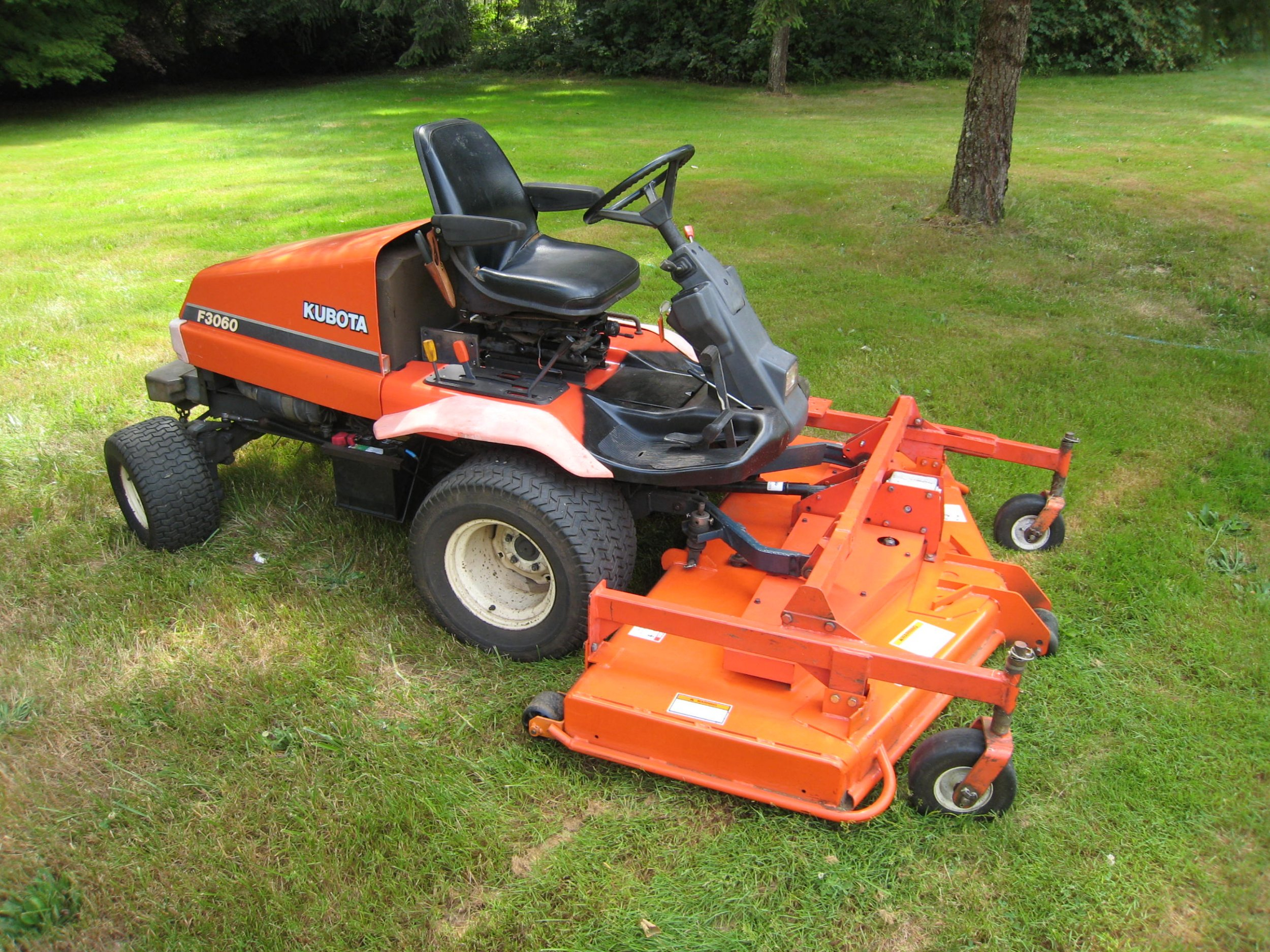

Fingers crossed, but full disclosure- usually once a machine is split, I don’t trust it as much. Many parts need specific torque specs and factory assembly procedures. Nobody will be able to verify that was done.
The dealer does not want this mower to come back on their dime for the same issue, so I would think they had a competent mechanic working on it!
However I would suggest carefully checking out under the transmission for oil leaks after each mowing, as well all hydraulic hose connections - including the four hoses or pipes at the steering hydraulic controller up front and also around the oil cooler lines.
Pay close attention to areas where transmission cast aluminum pieces and center piece, as well as the HST join together.
I disassembled my 3600 hour F3060 completely (I mean all but the engine) mainly due to few oil leaks, and have it back together now and put on 10 hours of mowing since.
So far my mower works perfectly and is 100% leak free but I will keep monitoring.
