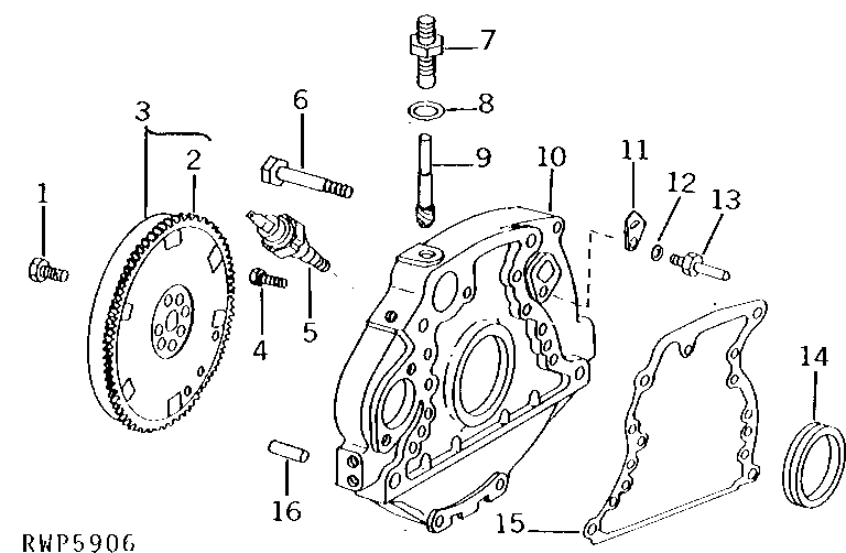

Aug 19, 2014 / John Deere Thread Starter #2 OP B Bill Johnson New member Joined Aug 19, 2014 Messages 2 Location Dixon, MO 65459 Tractor 2510 & 3020 Where is the timing mark located in a 2510 John Deere with gas engine. Thanks

Aug 20, 2014 / John Deere #8 Tx Jim New Member Joined Jan 26, 2007 Messages 10,400 Location Coyote Flats,Tx Tractor JD 4255/Kubota M7040 HDC :welcome: to TBN. Timing mark is on flywheel. Remove cover(parts key 11) held by stud on LH side of flywheel housing. Attachments RWP5906________UN01JAN94.gif 12.8 KB · Views: 114
