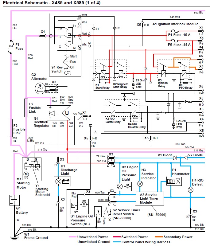

I an new to the site so bear with me; I have a 2004 JD X485 tractor that the pto will not operate. I have changed PTO switch, bypassed the brake switch, and bypassed the RIO switch.
The PTO solenoid switch works as I put 12 volts directly to it and it works. The PTO worked fine as long as I kept the juice directly to it. I have worked on this machine for 3 weeks and pulling what little hair I have left out.
Any ideas or suggestions?

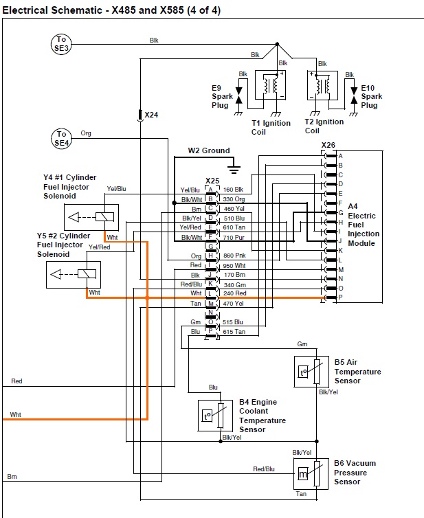

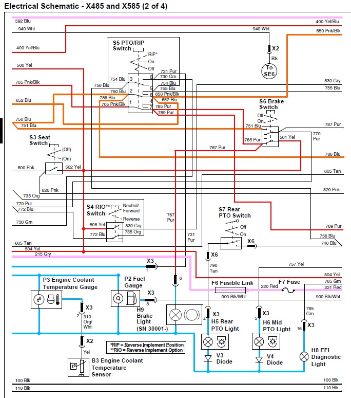

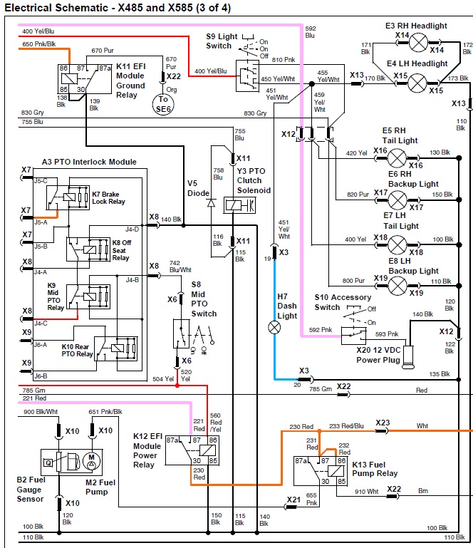

Took some time to post up the electrical schematics for the X485.. total of 4 and the read left to right from 1 - 4. May give you something to follow when tracking down the problem.
Not in order, but won't let me move them to be in order.

From the diagrams posted by beenthere in post #4, look a the last diagram he posted. Find S5 PTO/RIP Switch.
Which wire/terminal on S5 are you connecting 12volts?
You should be on terminal 2 the blue wire number 750. If this is correct, then no power is getting to the switch.
You say you bypassed the brake and RIO switch. You did not say if you bypassed the seat switch, if not do that. If still no power to the S5 PTO/RIP Switch, the interlock module is bad.

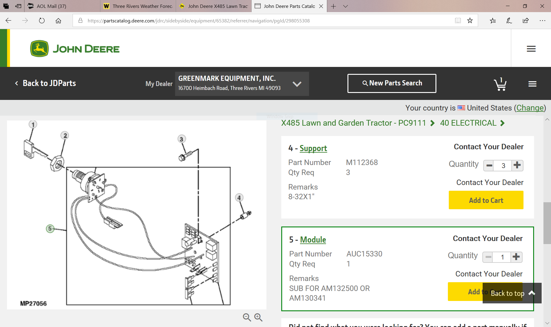

As a lat resort I ordered and changed out the Ignition Interlock Module and still no power to solenoid.

I also bypassed the seat switch. I also replaced the PTO\RIO switch. I am getting power to this switch.
If you are getting power to the PTO/RIO switch, no need to replace the interlock board. I only recommended replacing this board if NO power to the PTO/RIO switch.
With the PTO/RIO switch ON, do you have power out on the terminal 3 blue wire #755?

Yes I do have power out of 755.
/ John Deere X485 Lawn Tractor
#12
I do have power out of Blue 755.

Where is S5 RIO located? Doesen't it have to be where it can see the machine is in reverse (reverse pedal/linkage/transmission). The normal PTO/RIP (S5) switch being up on the dash right side just the hydraulic controls. Or do I have those two confused in location? One of the switches has to see the reverse pedal being activated. At least as I understand the safety switches checkout test. I see that is S5 (PTO active) (switch closed) is pulled up then the engine will not crank/start with brake or parking brake not set (brake switch closed). So I think you down to the PTO/RIP switch on the dash or the S4 switch down in the machine. Not having the TM to get the location of S4 is needed

RIO switch is located on the inside of frame on right side of mower. It is activated (or deactivated) by the movement of reverse pedal.

Yes, again check operation with VOM set on continuity (black (negative) wire on the common of the switch), the red would move to either of the other for tabs, move pedal see if switch closes or opens (On Analog meter - the needle moves from 0 to infinite or vice versa)(Digital meter - the digital goes from 0 to Open or a 1). The brake switch is double ganged, so there are actually two switches stacked. There are configured as Double Pole - Single throw (So a single movement trips both of the switch elemnts)
