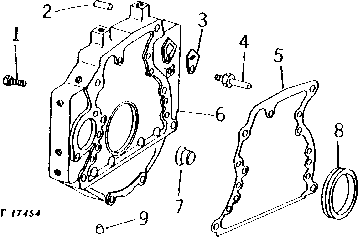

I need to know how the timing gears marks go on a 1020 301r john Deere its a 70 something's model maybe 31hp
   / john deere tractor timing gears #2
First you need to put the crank shaft to TDC for #1 cylinder on the compression stroke. Both intake and exhaust valves will be closed.
The timing mark for the cam shaft gear will be on a line drawn thru the center of the crank shaft and the cam shaft.
The timing mark for injector pump gear (if diesel and not gas) will be on a line drawn thru the center of the crank shaft to the center of the injector pump shaft.
   / john deere tractor timing gears #3
Most likely there is a timing mark on the fly wheel as well, and it should be able to get the crank set correctly.

   / john deere tractor timing gears #6
Part # 4 in the drawing is for setting the flywheel to TDC. I think you reverse it and it will engage a hole when #1 cylinder is at TDC.
