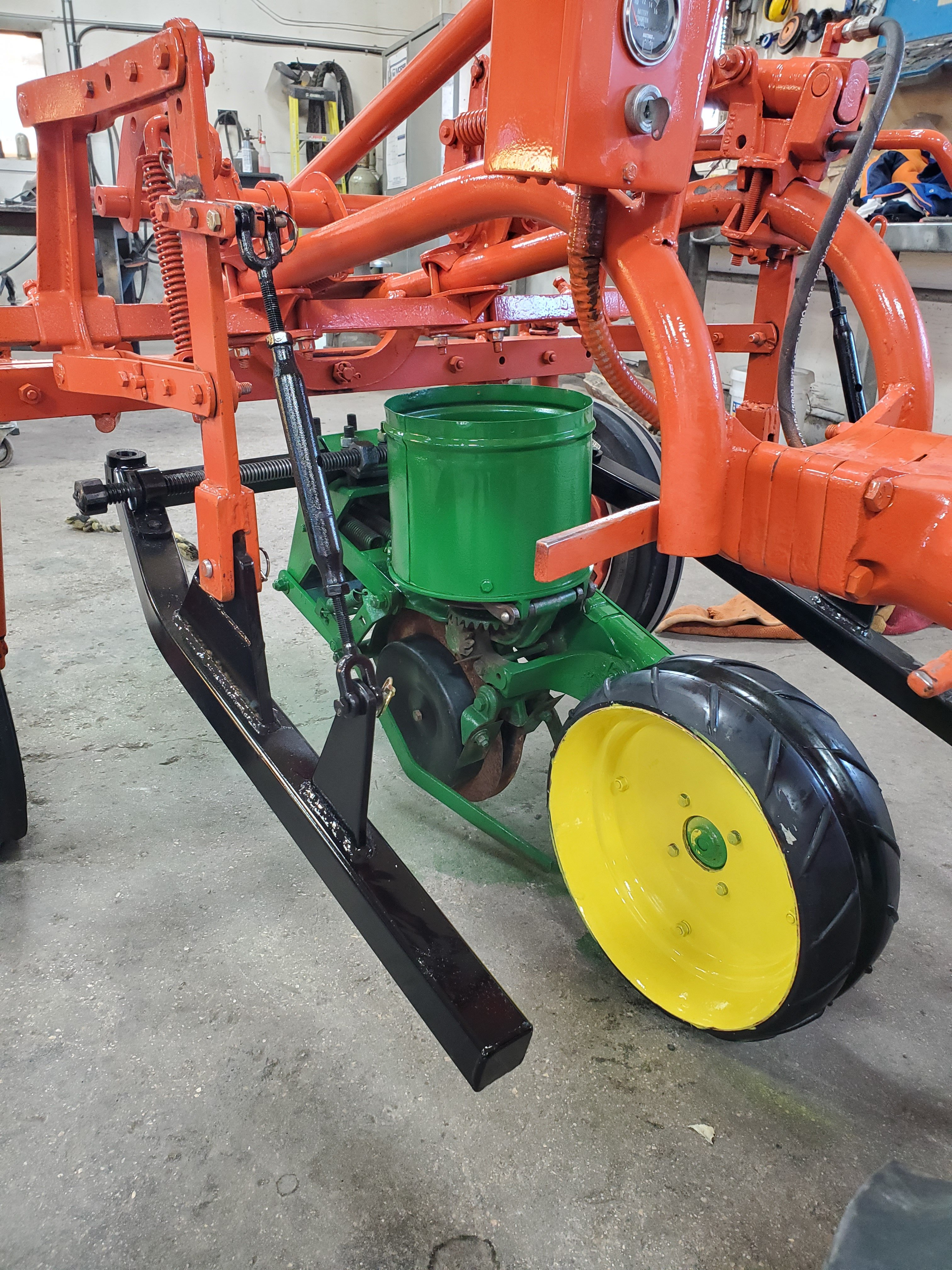

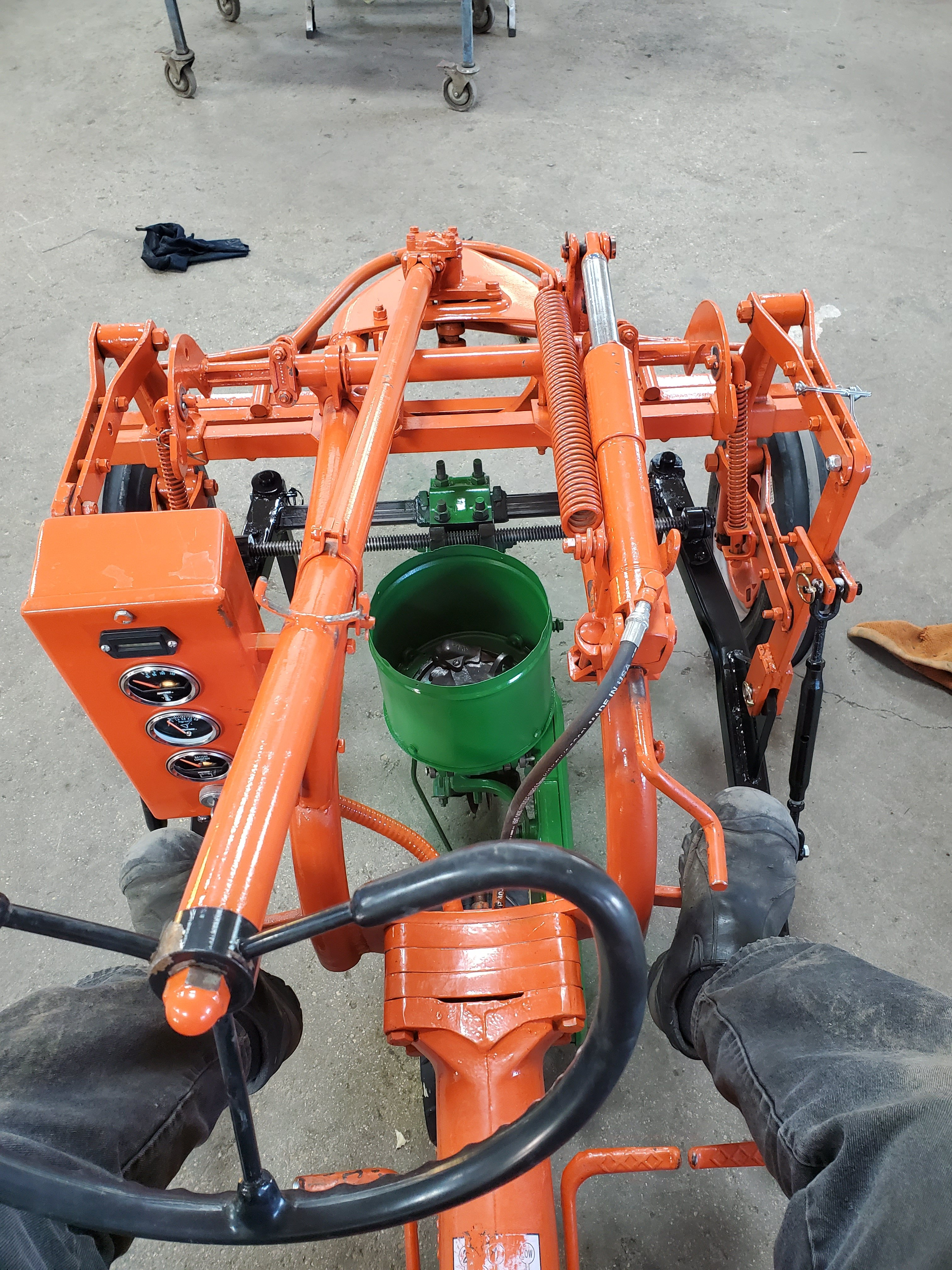

Had a planet Jr but didn't like the job it made. Bought a planter 71.. Took out the flex with a couple spacers cause I didn't have enough lift on my G. Made it adjustable with acme thread for different row spacings. Can't wait to try it out this spring
