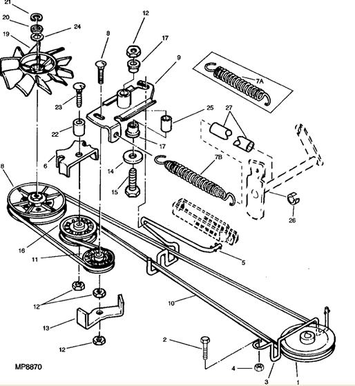

I have had this mower since new and has served me well, I cut about 2 acres of grass all summer and pick up leaves in fall with a jarco wagon and it works great without a power flow. My concern now is a noise, like a bearing or? I have taken the mower deck off, it does it when it idles but does not vary with engine speed. When I push on the brake peddle and lock it with the brake lock it quits and as soon as I release it and go, the noise is there. I do not think it is the engine bearing as it is a steady speed. If it were in the engine it would vary with the engine speed. Would like to get it fixed before spring and would like to do myself and not take to dealer. I have taken the seat, and frame cover off and I cannot pinpoint the noise. Anyone have any ideas? Thanks for the help

Possibly could be a bearing going bad in one of the transmission drive belt idler pulleys.

Where is that located? Maybe on the transaxel? If I remember right there is just the main pully on the motor. Appreciate the help.

Shown here are the drive pulley's and idlers.
I'd suggest letting it set and run for a length of time, like an hour.
Then shut off and feel the bearings to see if one is hot to the touch. That should identify if it is a bearing in an idler or not.
Also, if it seems to be brake related, look for some debris in the brake drum/ brake band area.

I don't see a drive clutch (see posted pic of pulleys) as one pulley is on the engine and the other is on the tranny. The two idler pulleys are linked to your "clutch" pedal (that I think you have).
Maybe something is vibrating (rattling noise) that is locked down when the brake is on.

Just wanted to update on my progress with my tractor. It was a idler pulley am115459 under the mower frame. The screwdriver worked great, thanks for the tip on that. Hard to imagine that one small bearing can make so much noise. It still spins free and probably would of lasted a long time but I am tired of the noise. Will be ready for the spring mowing. With this unseasonably warm weather will not be long.
