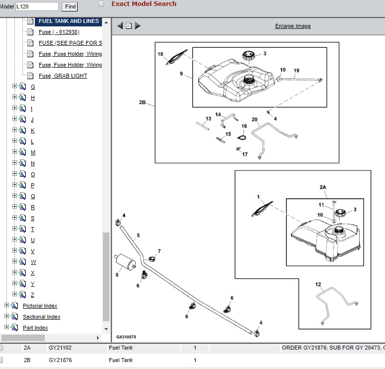

The shaft inside of my tank shook loose is there a way to re-attach this it is a sealed tank is there any type of tool that is used for this. The tank is in great shape except for this shaft which goes to bottom of tank to suck the fuel up has become detached.

From what I see in the two tanks offered for the L120, one of which is likely yours, that neither require a tool.. just the bushing (key # 10) and the fuel line to push through the bushing into the tank.. different fuel pickup for each style tank. Maybe an end of the pickup tube broke off and is what ended up in the tank. New pickup tube and bushing should get you back in business.
