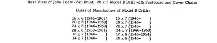

What model grain drill do I have I have no clue can't find a serial number on it it has 7 rows and mechanical lifted and dropped
   / John deere grain drill model ? #2
4' John Deere Van Brunt or at least looks similar.
   / John deere grain drill model ? #3
Only problem is JD didn't build a Model B in a 4 ft size. Must be a customized version. I know for sure because I assembled JD model B drills back in the 60's when I was employed at a JD dealership before I was reincarnated into an old crippled fart.

Yeah I'm needing to buy some parts for it that's why I was asking so it's a van brunt 4' u think
   / John deere grain drill model ? #5
Yes it's a modified JD Van Brunt model B grain drill

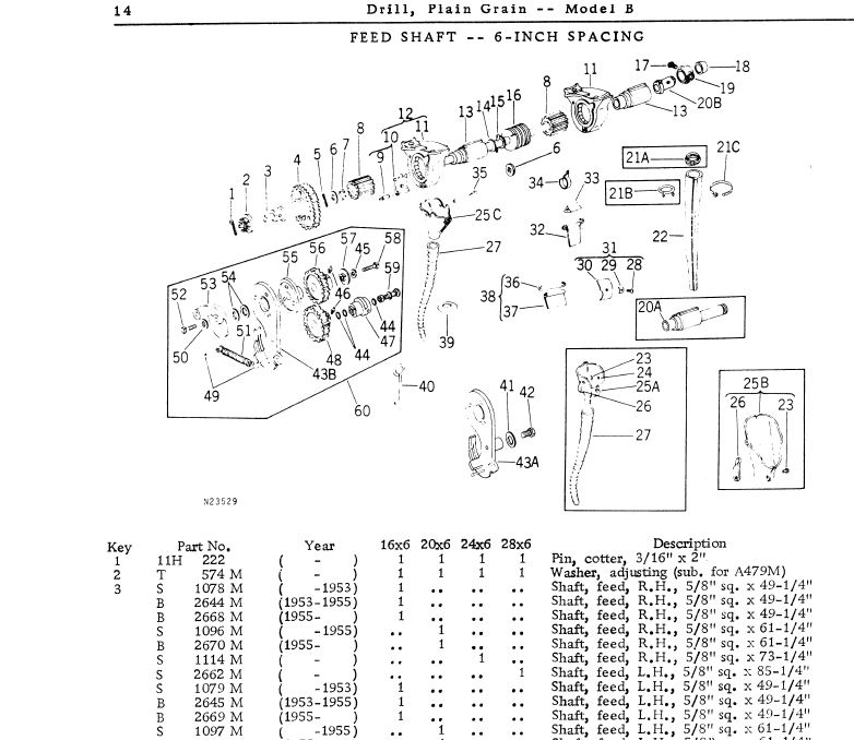

It needs all new seed cups and the road that drives them any clue where I could get them
Yeah the rod with the gear on it that actually turns in the seed cups

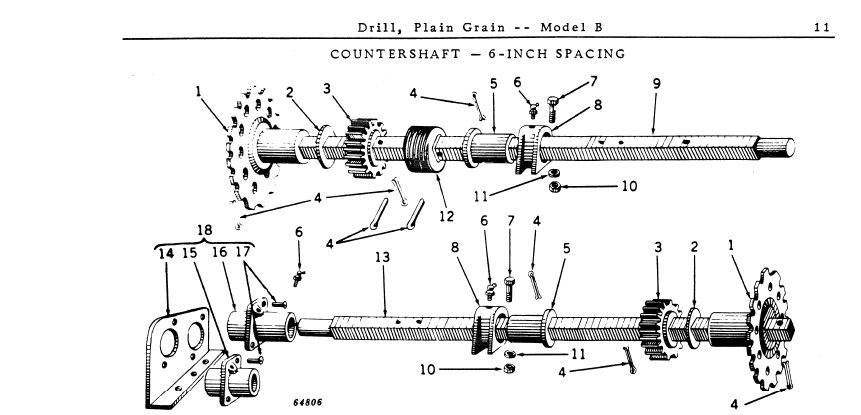

   / John deere grain drill model ? #9
Counter shaft or feed shaft? Feed shaft I'm guessing. FYI the feed shaft is fairly complicated to R&R. What distance are the feed openings apart(center-center) and how many openings on your customized drill?
