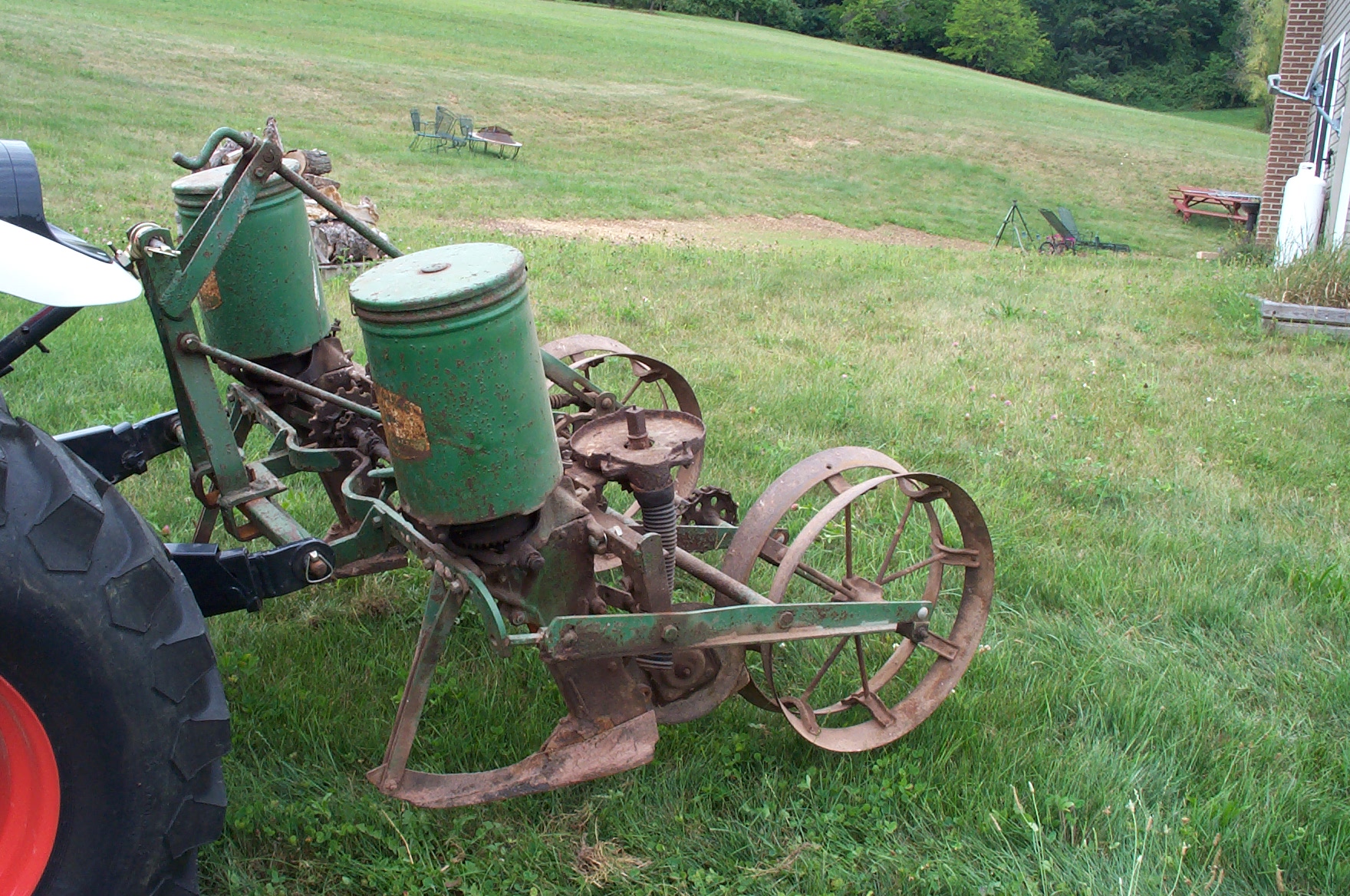

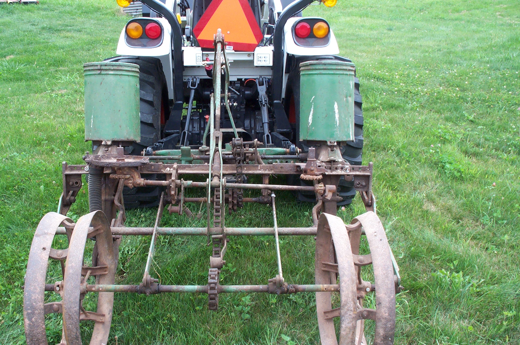

I just picked up this corn planter and was wondering what model it is? I stopped at my local john deere dealer, but all the people with any knowledge were gone. They let my look through their books and I think it might be a 246. Can anyone confirm this by the pictures? Also is it difficult to find parts or a manual? I don't know anything about corn planters, but wanted one to plant some sweet corn. I will probably get a fertilzer spreader instead of fixing the fertilizer system. I'm sure that would be costly.

That is a model 246. I have used one for the last 20 years or so for small foodplots (1-2) acres in size and a couple acres of sweetcorn every year. Mine still has functioning fertilizer applicators which make it far superior to the cut down, 2-row model 71's that are so common these days for planting/fertilizing small areas. To get the same effect from broadcast fertilizer you have to apply nearly twice as much, which aint cheap. Unfortunately, it is difficult to locate fertilizer parts for these. Many but not all are the same as the pull-type model 290's which are a little easier to find because they were produced in greater numbers. I thought I could use the lower disk-wheel assembly from a 290 on my 246 but found out they were not the same so I had to fabricate the assembly when I rebuilt mine this spring. The planter shoes were the same however between the two models and those I took off the 290 were in great shape. It looks like the shoes on yours are worn down pretty good, but i bet you could get new ones from a JD dealer. The seed plates on your 246 are the same as those on 71's and can still be purchased new.
/ John deere corn planter - what model? #6
A little bit more info....You'll need to determine whether that's a hill drop planter or drill type planter. The drill type is a 246, the hill drop is a 247. Put a few seeds in the seed cans, raise the planter and slowly spin the press wheel(s). Do seeds drop individually, one at a time, or several (3 or 4) at once? (several at once would be a hill drop...247) Visually, the difference is VERY difficult to determine. The difference will effect what parts you'll need (from Deere) In the late 50's, hill drop planters were still very popular. A large portion of the 246/247's were equipped as 247's, especially so in the south.
Those were the best 2-row planter Deere offered in their day. (50's and early 60's) THey have to be kept at reasonably slow planting speeds compared to later "unit planters" (such as #70's, #71's ect) Also, shoe type openers work OK in some conditions and not so ok in others. Later planters used disc openers more commonly. Disc openers were available for the 246/247's, but not all that common. I started off years ago with a 246 equipped with disc openers, row markers, fertilizer box, and insecticide applicators. The poor thing was a miriad of chains, sprockets, and idler pulleys! In the mid 70's I made the switch to the #71's to reduce set-up time, increase planting speed, and increase my crop yields.
The #71's will plant circles around most plate type planters, so many prefer them. (Better, more accurate seed placement, higher planting speeds, better in rough conditions, ect...) They weren't commonly equipped with fertilizer attachments. The solution for them is to install a liquid fert. application system. I did so on my 4-row #71 rig. Cheaper than dry fertilizer in the long run, easier to deal with, and the fertilizer unit itself will be FAR less trouble to maintain. You could very easily install a simular system if parts availability isn't up to par on the 246/247 dry system.
With the exception of some VERY early Deere plate planters, all Deeres will use what is known as a "type B" plate. They're all over EBAY. You can also find them NEW at Lincoln Ag. Older OEM Deere plates are usually cast iron. Newer ones supplied by seed corn companies and now from Lincoln Ag are all "Lustran" plastic. Either will work just fine.
