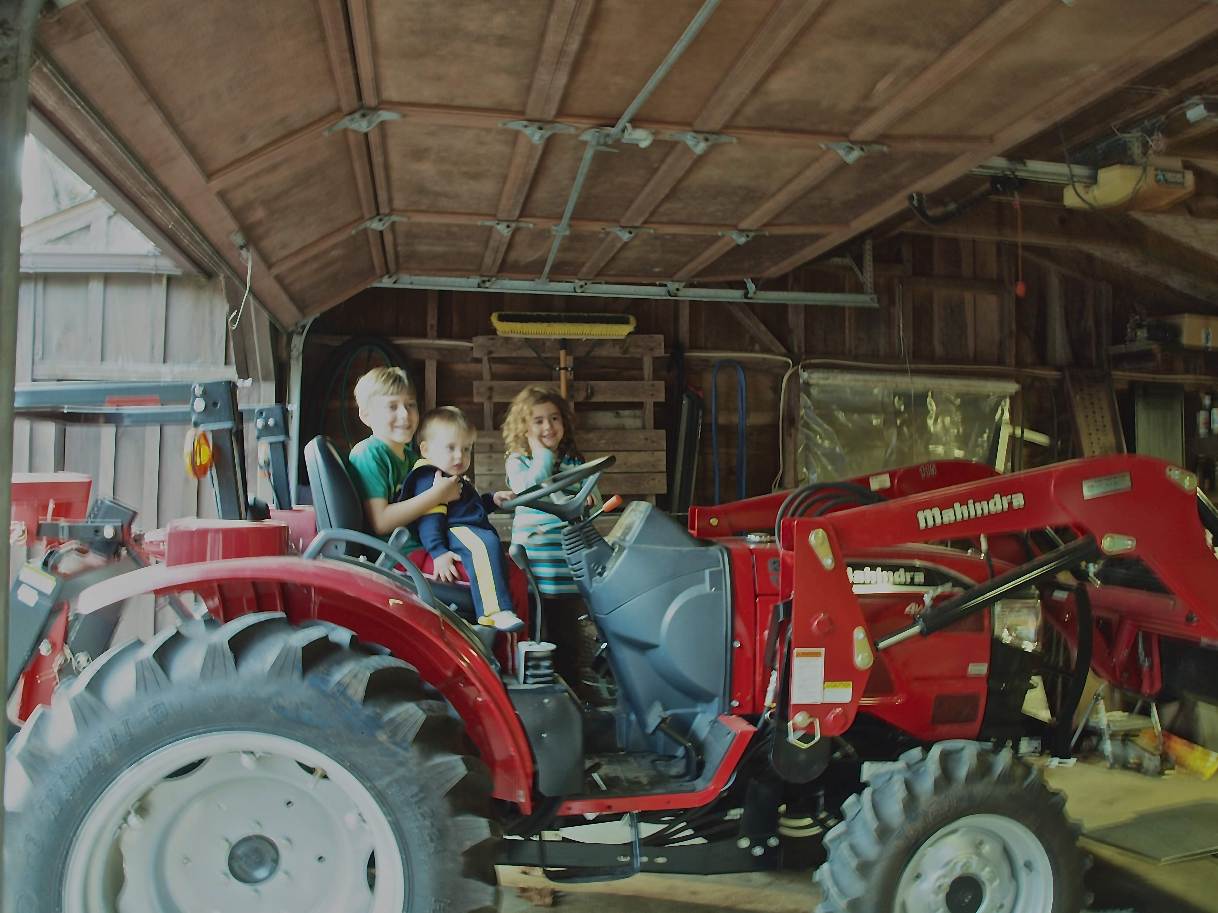

In the 28 yrs I owned the 750, I never took the fel off but I did not cut grass or rototill with it. I did negotiate some very tight spaces in the woods with little problem and was always glad it was on there.You are exactly right about "use". I mostly log and plow snow with mine. Of course I went to look at the Deeres first and was shocked to find that the 3032-38 series Deere's were mostly a lot of plastic including the floor boards. I was concerned that these would get wrecked in the woods and thought my old 750 was a much better built tractor. If I could, I thought the 770-790 or what they then called 3005 was a better choice for me for how I use a tractor. I then went to the JD 3320 and loved this tractor. With my trade, the JD dealership was 10 grand off what the Mahindra dealership was offering me so I settled for the Mahindra geared 3016. This has been a very useful tractor so far and the grandkids also seem to like it as much as the green one I used to have.
Thanks again Arrow, re Grandchildren, terrific piccie, bet they have a lot of fun. My only grandchild to date loves the ride-on mower but will I suspect be even more impressed with the tractor, if that is I can ever make a decision!! I'm a bit tied with make of tractor as there is a large JD dealership close to our France property (was leaning towards JD anyway) although I have since discovered there is a New Holland dealership close by as well.
