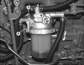

Yes, I made sure the fuel shut of valve was turned to the "O" (open) position. This tractor doesn't have a pump/priming function. It suppose to automatically bleed the air out. When you say the "return line", which line do you mean specifically? The one going into the filter from the gas tank or the one going from the filter to the engine? I have posted instructions below from the service manual that show the hoses connected to the fuel filter/sediment bowl. Is the hose that you are referencing any of these?
Using Fuel Shut-Off Valve
This engine is equipped with a two position fuel shut-off valve. Keep the fuel shut-off valve completely open when running the engine to ensure proper fuel delivery. Close the valve when performing any type of engine service, during transport of the machine, and during storage
1. Raise and latch the hood.
2. Remove service shield from right side of engine.
MX4114
3. Open or close fuel shut-off valve lever (A) as required:
キ Open Valve: Rotate valve lever to the "O" (vertical) position (B).
キ Close Valve: Rotate valve lever to the "S" (horizontal) position (C).

Try re-filling the fuel bowl again, by the look of your picture,
it's in the "off" position now.

There is a line that should come from the tank that is the supply line to the filter. The other line is the supply line to the fuel pump. Remove the line which feeds the fuel pump. You should get a good stream. If not try turning the shut off valve as Skyhook mentions. If you get no flow from either you could remove your filter again. Open the valve and see if you get good flow with no filter. You may have some clogs happening in the tank pick up.
I have not changed my filters in a while. My tractor has a water separator by the tank and another filter up by the pump. I thought when I open the valve up I saw some fuel flow filling up the bowl.
