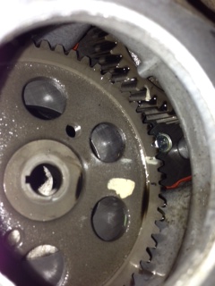

The IP gear has not moved from its original position from when I removed the pump, so I should be okay. However, you mention aligning marks....there are white marks on the IP gear and the idler gear, but these marks do not align. I have included a picture of these marks....are these the marks you are talking about?

Those are the permanent marks... part of the set of five I referred to. They will not be lined up unless you positioned the engine at TDC on No. 1 before pulling the IP. That's why you add your own mark. If the gear has not moved, you'll be fine. Just turn the pump shaft so that the key aligns with the keyway in the gear when you put it back on. DO NOT turn or disturb the engine until you put the pump back on.

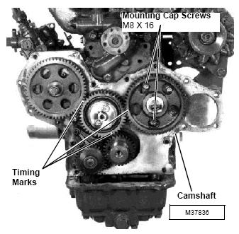

I don't know where I came up with "five sets of timing marks"... maybe because there are five gears in there. Guess the memory ain't what it used to be. Anyway, there are only 3 sets of timing marks.

So if I understand this correctly, when I get my pump back on and start cranking the engine, every second revolution and the timing marks should align between the IP pump gear and the idler gear? (And this I will be able to check through the inspection plate I currently have removed)
