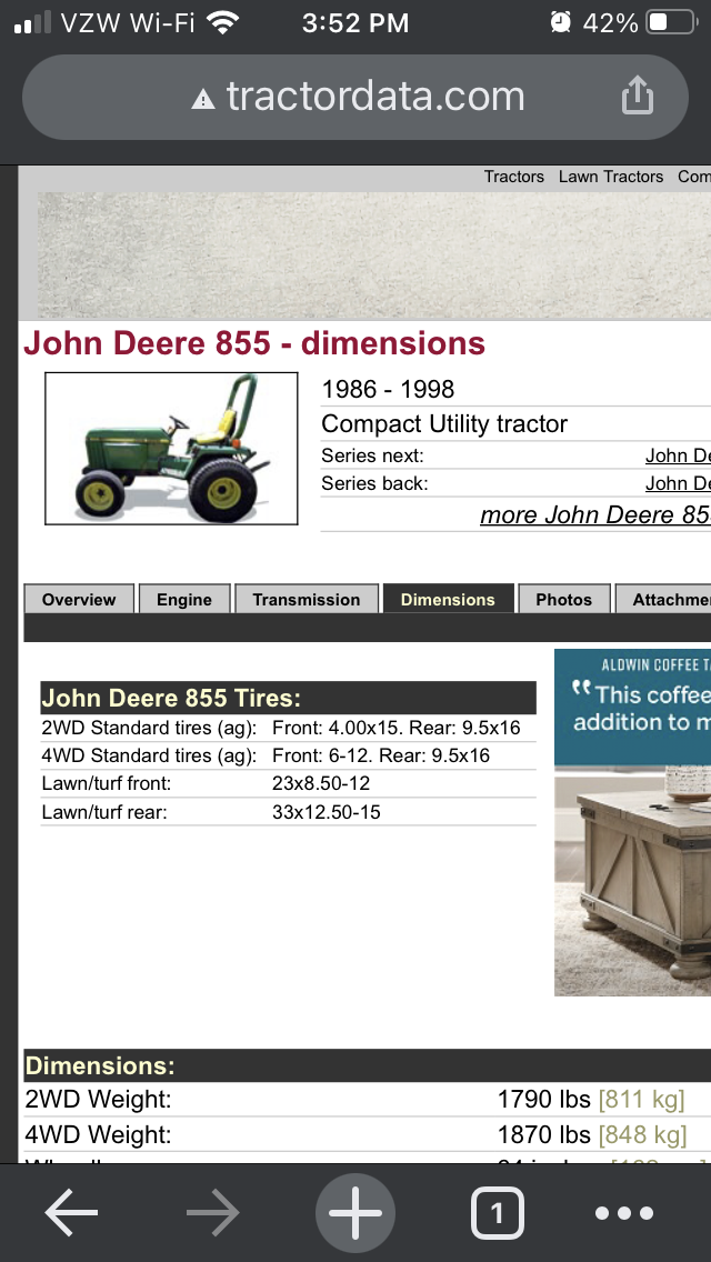

I have John Deere 855 that was my grandfather's and I inherited it when I moved into his house 8 years ago. I love it and rely on it and want to treat it the best I can. My dad passed away in June and he was my go-to guy for all things tractor related. So, here I am now on my own trying to figure things out.
In the barn we have a set of ag tires for the tractor that have never been on it. It currently, and always, has had the turf tires on it. I'd like to have a second set of tires that I can put on the tractor for the winter for blowing snow, and for the spring to use to work my 2-ish acres of market garden. The turf tires seem to fill up with snow/mud in no time.
I've been shopping around for the right rim to match the tires I have in the barn and I think I have the right ones. I was hoping I could ask here in case someone could confirm for me. These are the ones I think are the correct ones are model number JD3210 that I found on eBay. I can't post a link to them because I don't have enough posts. The specs for them say 16x8, 6 Lug, 4 5/8" Pilot Hole. And they definitely look the same.
The tires I have are 9.5-16 R-1 Ag tires that seem to meet all the right measurements for those rims, and those rims seem to meet all the right measurements for the tractor. Assuming I know how to measure.
I'd be grateful if anyone could help me confirm that these are the right rims for the tires I have. I am certain I will have other questions in the future.
Thank you in advance. :)

Is this a 2wd or 4 wd (MFWD) unit. If the latter, then you may need to change the fronts too to preserve the correct ratio of circumference between front and rears.
/ John Deere 855 Tire + Rim Question #3
From tractor data ...
Good luck.
Frank

Yes, it's a 4WD tractor. That's a thing I hadn't thought of! Huh. Thank you!
