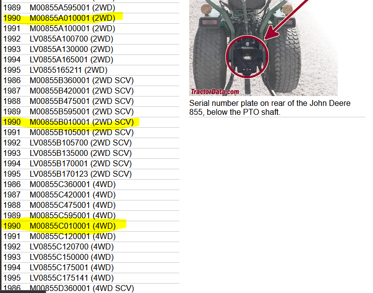

Doug, not all the JD855 are capable of SVC. You have to verify per the tractor ID plate on the lower back end near the PTO output spline shaft.

bmaverick,
I apologize, but I do not understand your reply. If my 855 can operate the model 70 loader, does it not have a selective control valve(s)?

Doug, you would have to find the tracto serial number on the rear ID plate by the PTO output. M00855B010001 and higher s/n would allow a SCV interface on your machine. It's that simple. Because the hydraulic system either came with the interface or was not added to the sunstrand die cast on the tractor. So yes, look closely at the s/n of your machine. It's that smple to find out Yeah or Nah to add the optional SCV to your machine.

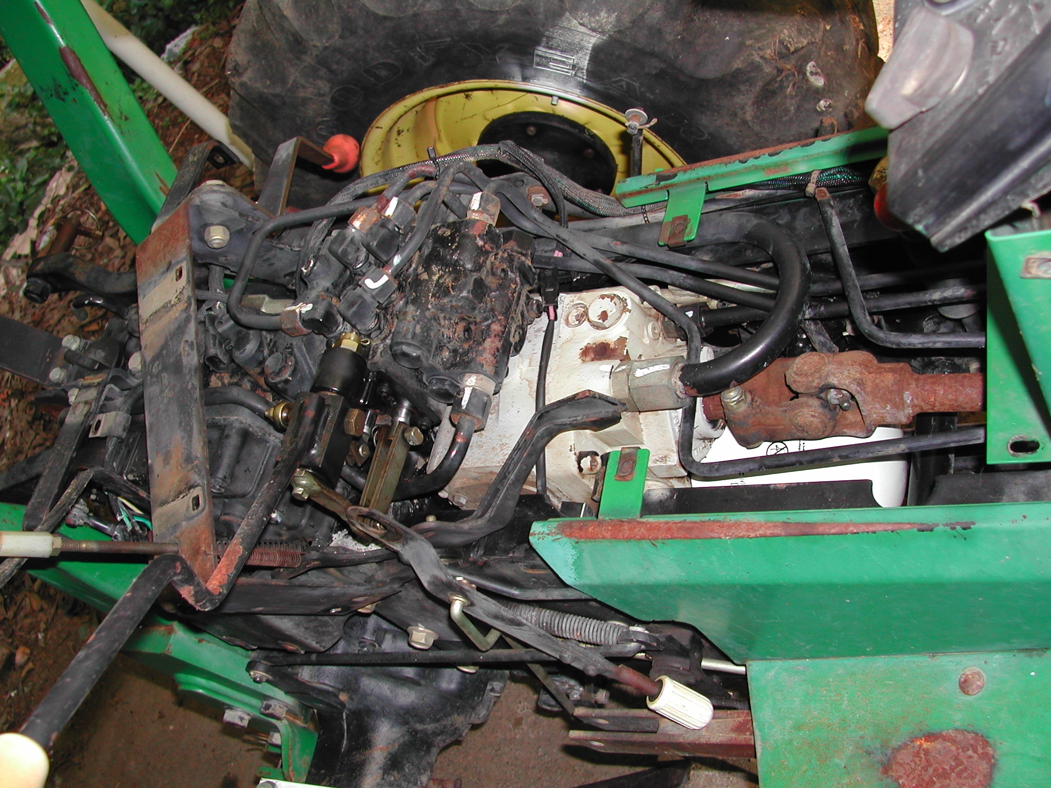

Your FEL joystick valve prob looks like this one from one of my 955s. All is accessible after removing seat and its support bracket. Fender removal helps, too, but may not be necessary.
The joystick's heim joints and some of the brackets get pretty worn as most owners don't oil them. At the time I did mine, JD parts were available and reasonable. Now? Dunno.
But I just ordered a full set of 6 replacement heim joints for my backhoe that look better-made than the original. About $20 total. You can also fix the worn holes in those brackets by drilling them out and inserting a bushing.

The area around the end of the spools looks pretty damp from hydraulic oil. Also damp around the cap screws going into the flow divider.
The largest leak I have found is where the pressure line to the power beyond comes out of the top of the case. In order to disassemble it to replace the O-rings, it looks like I have to start removing hydraulic lines from the top of the SCV, at least one if not all of them, to have access and clearance to turn the fitting.
It doesn’t look like it is too tough to remove the flow divider and the SCVs. The fun probably really starts when you start pulling the spools out.
Yep,
Mine looks very similar to yours. It looks like I have a long phone conversation with the John Deere parts person in my future.
