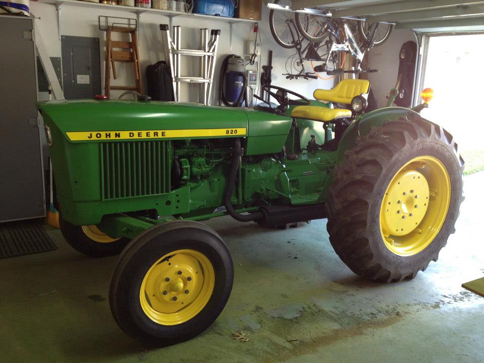

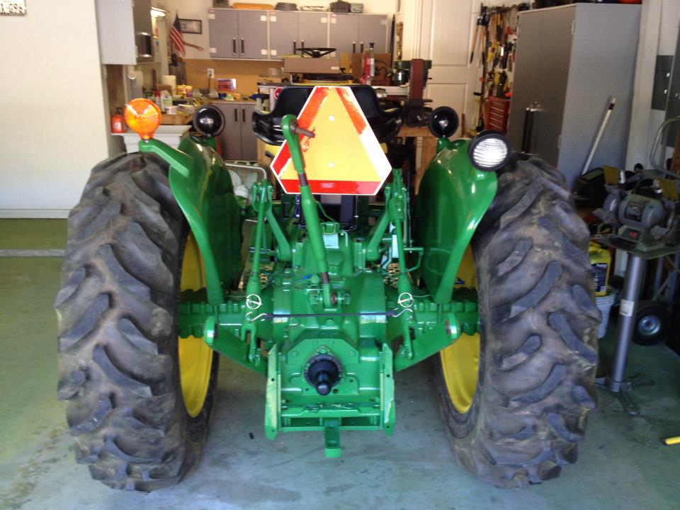

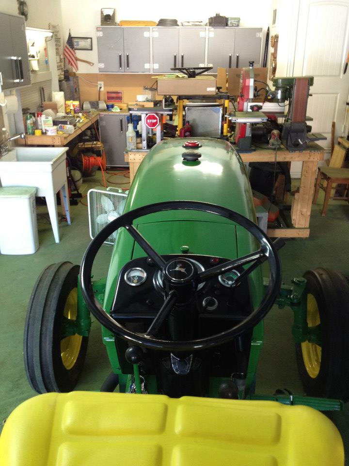

Tractor 1.jpgTractor 2.jpgTractor 3.jpgI haven't updated you guys lately so thought I would do so. I was unable to weld the tab on the transmission slider. I would have had to have a MIG welder and all I have is a stick welder. But, I built a bracket that clamped onto the end of the transmission slider that did the job very nicely. I built it so that I had to actually bend it onto the end of the slider and had just enough room there to insert it and bend a tab into place with my channel lock pliers. I also put in a setscrew to keep it tight and installed that with some loctite for permanent installation. So, I'm pretty satisifed that the bracket isn't going anywhere. It works great and holds the end of the spring in the right location. My parking detent now works fine.
I also finished the entire tractor and have a couple of pictures I'm uploading here. It turned out great. I bought a King Kutter finishing mower and refurbished it a bit and now use the tractor to mow the old home place where I grew up. It makes quick work of the acre and a half yard! It brings back old memories to as I grew up at that place on that old tractor--drove it when it was new. In fact, I decided I wanted to be an engineer driving down the road on that old machine so it has a lot of sentimental value to me. Nothing runs like a Deere!
