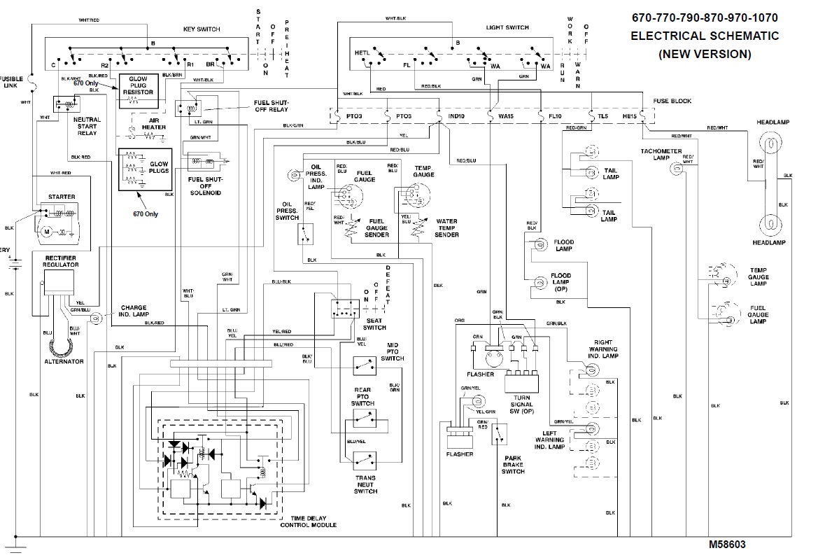

My JD 790 is totally dead, it does nothing when I turn the key. Three weeks ago, it was running just fine and I cut grass for two hours, then I parked it. Last weekend I went to crank it up and for about 1 second I barely got a red light on, and a faint click of the starter solenoid. Then NOTHING. I charged the battery (in the tractor) at full charge for 3 hrs, turned the key and NOTHING. So I then hooked the charger back up to the battery (still in the tractor) to see if the charger would even light up the red indicator light, or move the gauges, and turned the key... NOTHING.
After raising the hood and taking the side covers off, I see the fan belt is loose as a goose. I suspect it was barely turning the alternator so it was probably running the battery down. Looking at the wiring diagram, I see there is a fusible link in between the starter and the ignition key switch. I suspect it is now open as it gets no lights, gauges, or sounds when I turn the key to ON, and then turn it to CRANK. NOTHING!!! I've already called my JD dealer and the link is an $8 part, so they have one on order for me and it should be in tomorrow.
Unfortunately my tractor is about 60 miles from me, but I will be up there Saturday morning to look at it again. I will be taking my DVM to make some voltage checks on it. If anyone here can tell me exactly where the link is, I would appreciate it. I think I may have to remove a panel or two from around the steering column? TIA.

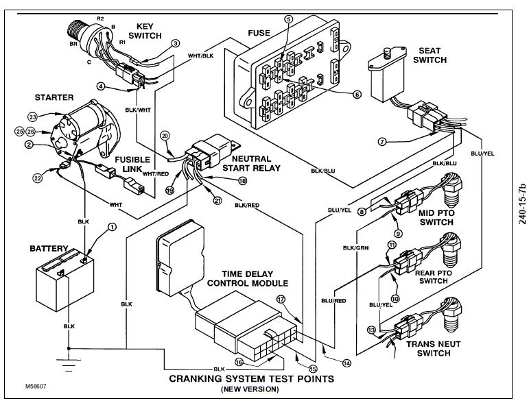

kebo
Searched my service tech manual which includes the 790 new version.. found the following schematic.. indicates the wire color which may help locate it. On white/red wire between the starter and the key switch. Hope that fits with your replacement link and is some help.

From the drawing,
Before replacing the fusible link, I would check the continuity of the wiring from the battery + to the "B" wire at the ignition switch. Or check for voltage at the "B" wire at the ignition switch.

Nobody has mentioned battery cables, so I will. Be sure to clean all connections at battery and at the ground cable connection on the frame. In my experience, 90% of the time when there is a sudden loss of all electrical power, a bad connection or a bad battery cable is the culprit. The fusible link is just as the diagram that beenthere posted. It is right by the starter about 3 inches from the battery cable connection.

Thanks, this helps. My dealer called this morning and said the part (fusible link) came in, the link itself is red wire. They also printed off a copy of the wiring diagram similar to what you had attached. He gave me two versions of it, one for the 28hp 790's and one for the 30hp 790's, which is the one I have. Thanks again!
