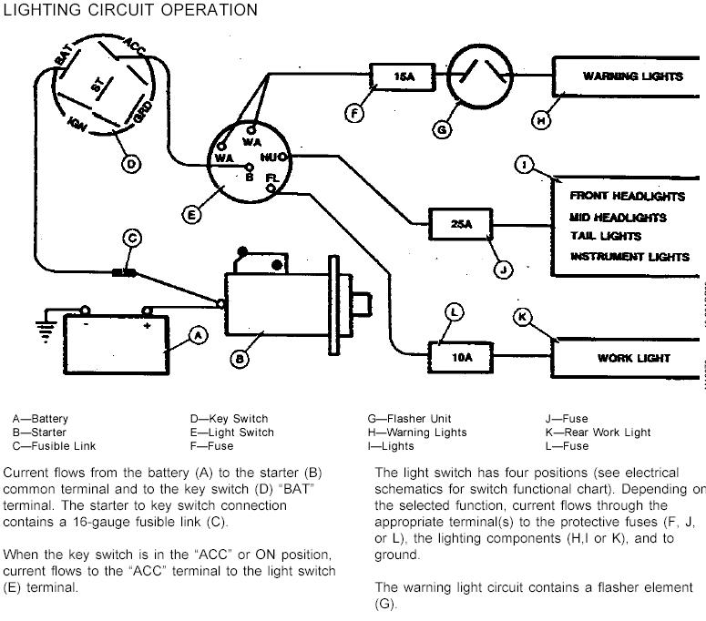

Oct 2, 2011 / John Deere 755 need wiring diagram #1 S stallardt New member Joined May 2, 2006 Messages 13 I have a JD 755 and the previous owner cut a lot of the wiring for all areas of the lighting system I hope someone can supply me with a wiring diagram Thank you Tracy
Oct 2, 2011 / John Deere 755 need wiring diagram #2 B beenthere Super Star Member Joined Aug 16, 2001 Messages 18,537 Location Southern Wisconsin, USA Tractor JD_4x2_Gator, JD_4300, JD_425, JD_455 AWS, added JD_455, JD_110, JD_X485(sold) :welcome: Here is the wiring circuit. Hope it helps. Attachments 755_wiring_circuits.JPG 89.5 KB · Views: 19,938

Oct 7, 2011 / John Deere 755 need wiring diagram Thread Starter #4 OP S stallardt New member Joined May 2, 2006 Messages 13 Thank yyou for the wiring diagram Tracy
