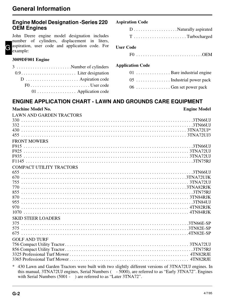

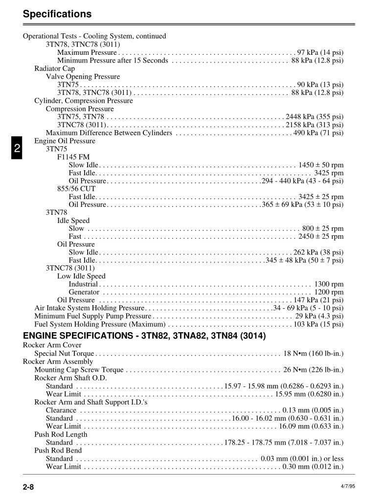

   / John Deere 755 compact Torque specs #9
Samples from CTM3 JD yanmar engine manual
