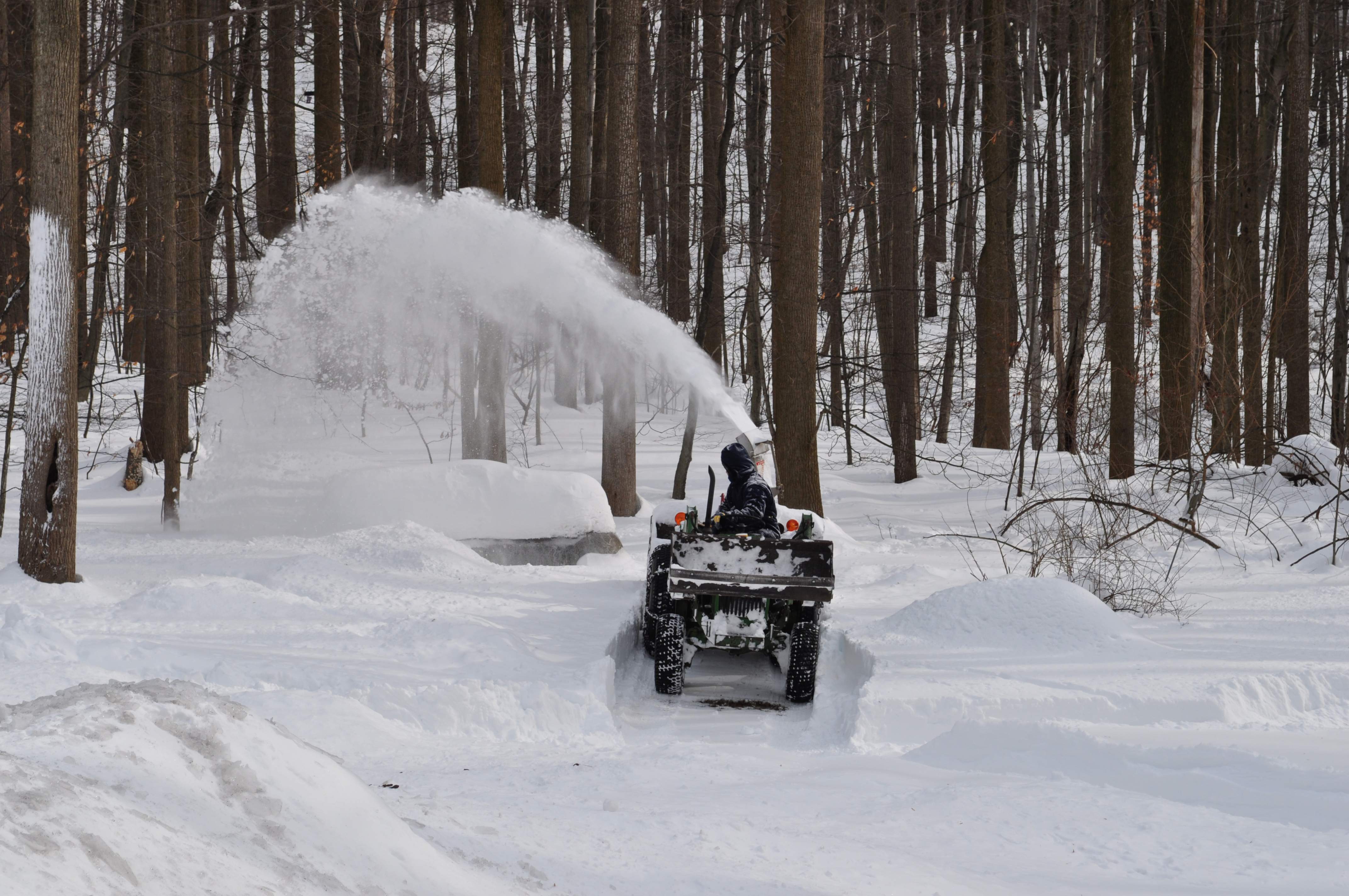

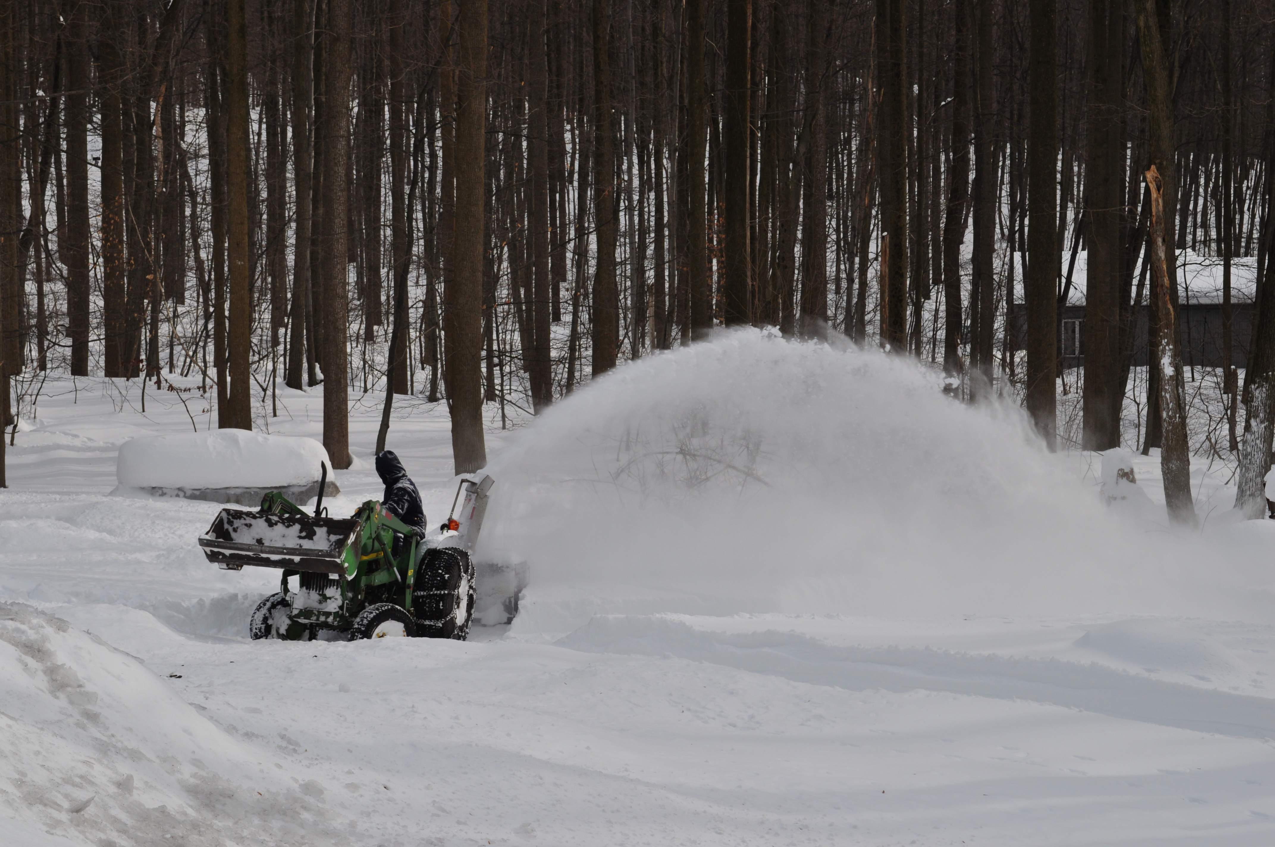

I used a rear mouned snowblower for 10+ years on a 750 and it worked well. I believe the front mount snow blower requires an add-on electric clutch belt driven off the front pully. I don't believe it is available any longer from JD although it sometimes is available on ebay. The rear blower I had was 60" wide.
