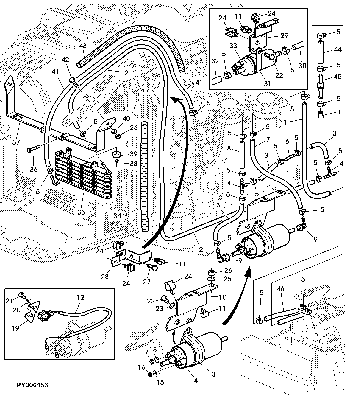

The newer 6415 with Tier II engine uses a fuel cooler. it is mounted above the battery, in front of the radiator as shown in this illustration. #35

i am sorry to report that i am NOT very good with computers. i have no idea how to put a picture on here.:( but the illustration in jd110 post is the correct setup with the fuel cooler. it is just a little radiator in front of the coolant radiator attached to a bracket. at first look i thought it was a modification, but all the brackets and the setup looks like it was stock. just a question, why would a tractor need a fuel cooler?

Thanks with the aid of your photo I found the cooler part #AL159242

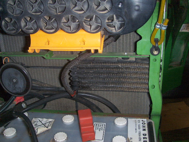

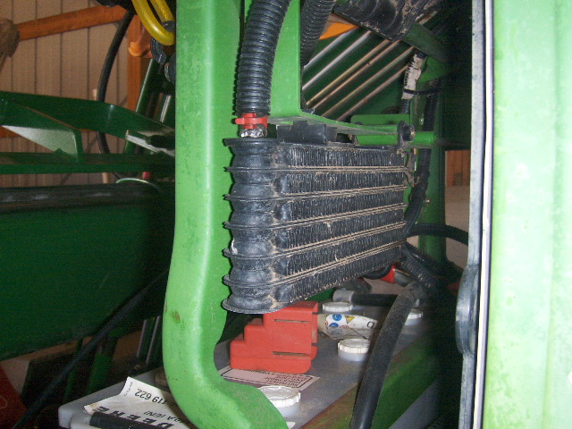

Finally checked my 6415. It has the fuel cooler, so I must have tier 2 engine with common rail injectors.
If any one still wants a picture I can take one and post it. :)
   / john deere 6415 starts hard #20
Pictures of the fuel cooler on my 6415
