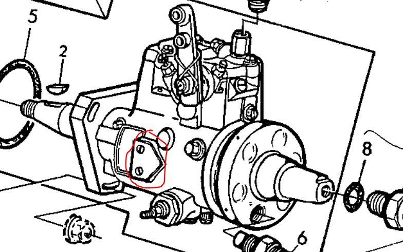

my 5520 tractor is open operator station. i.ve installed an inline electric fuel pump. with this installed there was no help when it was started with no increase in rpm. now it still won.t start with thi installed. i installed it just before main fuel filter. pump primed tight. bleed screw on injection pump was shooting fuel out. fuel line on top of injectorpump was shooting fuel out. tried to start up tractor. wouldn.t start. hooked hot wire to injector solenoid and it clicked everytime i touched hot post. don.t know if it.s working or not. what would stop fuel from getting to injectors besides that soleniod switch inside the injection pump. i.ve noticed through all of this that my water pump is leaking and making a terrible noise, but all my antifreeze has not leaked out. has the water pump got anything to do with it not pumping fuel

Try this simple test: loosen the 2 screws outlined in red,pry gasket loose(if it's stuck) and see if engine will start. If engine starts return line fitting or return line is plugged. Leaking WP won't keep engine from starting.

Loosen an injection line on back of pump. Crank engine and watch fuel flow. If it just dribbles out then it is injection pump. If fuel spurts out then it should run. Rehook up line if fuel flow is good, then crack lines at nozzles to bleed it. When fuel is spurting out up top, lock them up and it will start.
