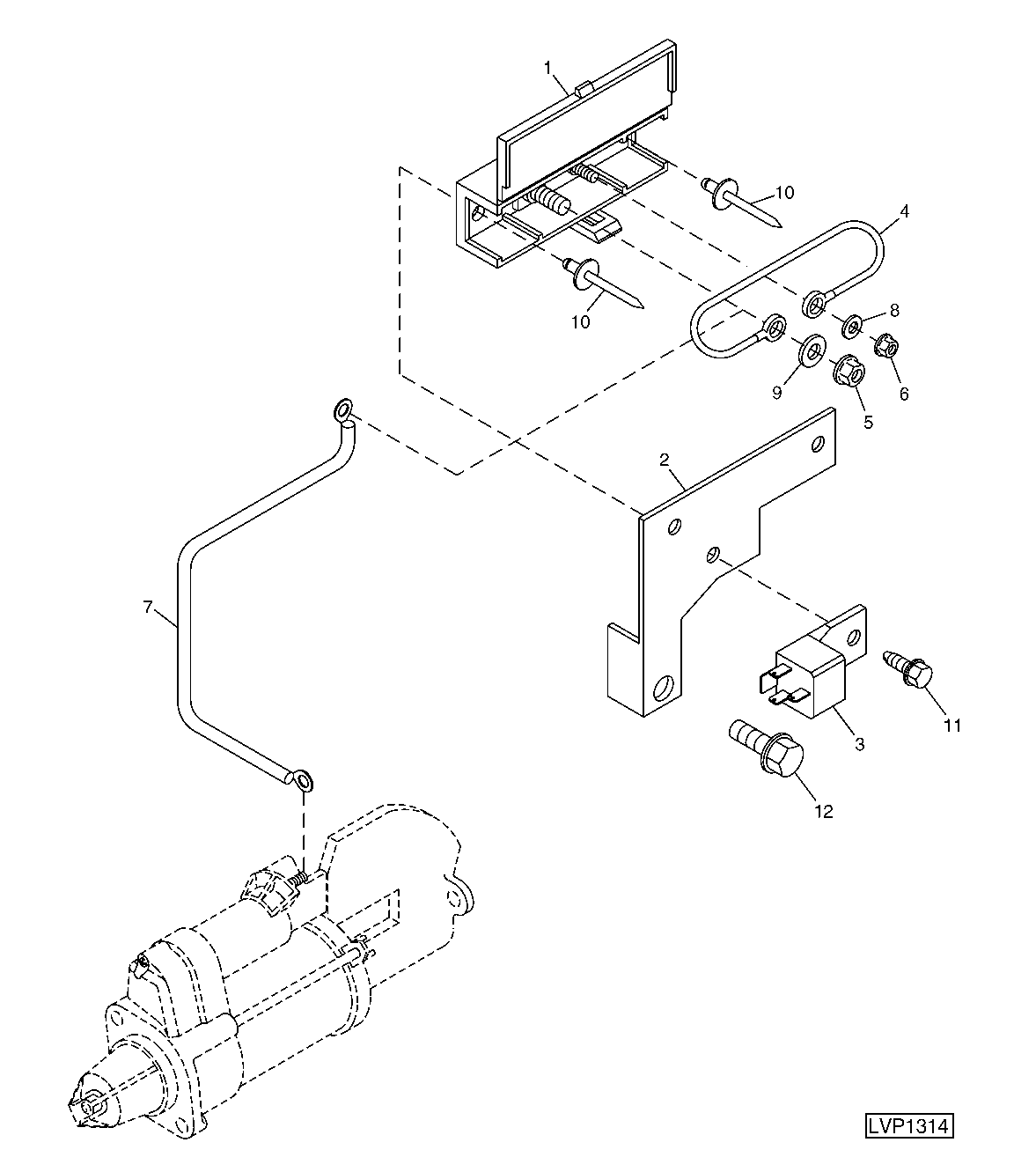

I replaced battery with a new one. Wrong connection. Big spark.Reconnected battery the right way.No start,no lights,nothing.What did I destroy?
   / John Deere 5420 #2
Most likely the fusible link key 4 in the drawing. Possibly the diodes of the alternator too. 5420fusiblelinkkey4.gif
