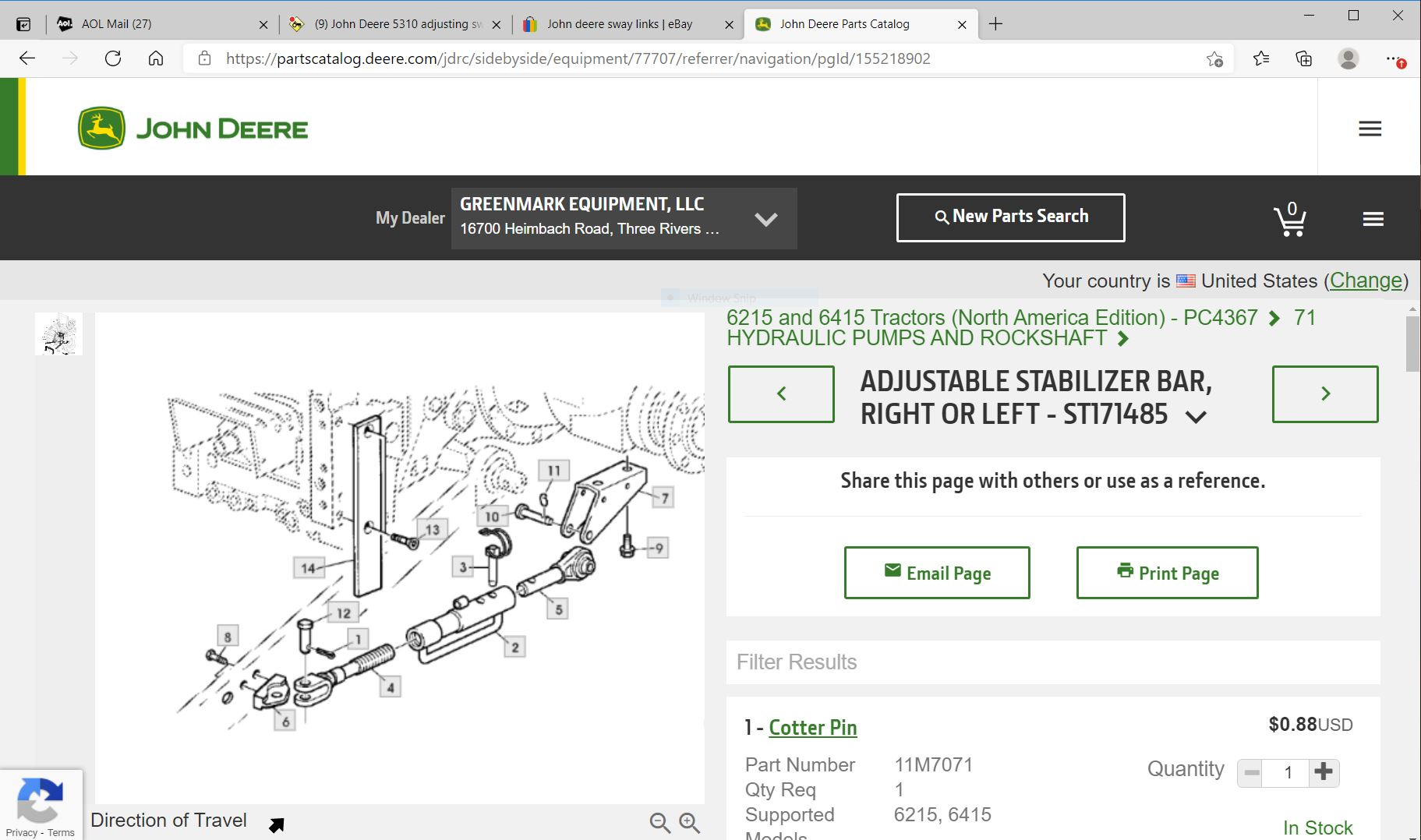

If this was my tractor I'd be looking for a kit with adjustable sway links made out of sq tubing with multiple holes to just put a pin into correct hole. I dislike the turnbuckle/chains anti sway links
I like that kind better too, but they use different style mounts on the tractor, a clevis instead of a single hole.
On my 6415, it has a combination turnbuckle/pin adjustment

I like the sway devices in your photo better than the adjustable square tubes I referred to.

Two changes you can make.. to take up some of the slack..
Add a bushing or washers to bring the arms closer in , and put the sway links in the top pin hole.. both suggestions circled on the attached pic.
All brush hogs are not made the same.. so yours just fits different on this tractor.
Additional you should be able to find a shorter shackle to replace the rather long shackle on it sway linkage. Match the pin size if the shackle and get as short as you can find. A ‘bow’ shackle will be shorter. It is possible there will be a ‘WLL’ and a number printed on your shackle. You should try to match this also if present.
WLL=working load limit

I was thinking same thing, shorter shackles.

Thanks, That's what my 6415 came with.
