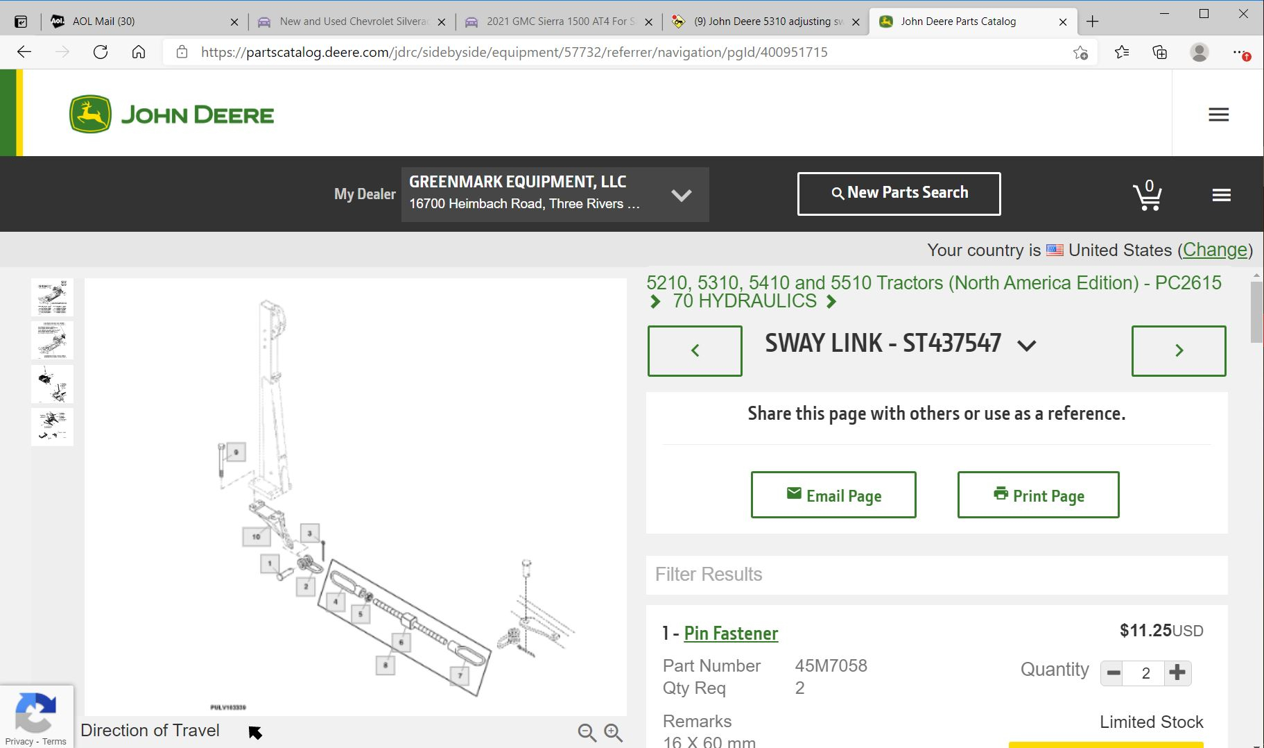

Looking at the sway links for that tractor on Deere parts it looks like they are infinitely adjustable with a center turnbuckle. Compare what you have on the tractor to what is shown for it and make sure it has the right parts.
   / John Deere 5310 adjusting sway bar/ stabilizer chains help #4
Here's a drawing from JD parts

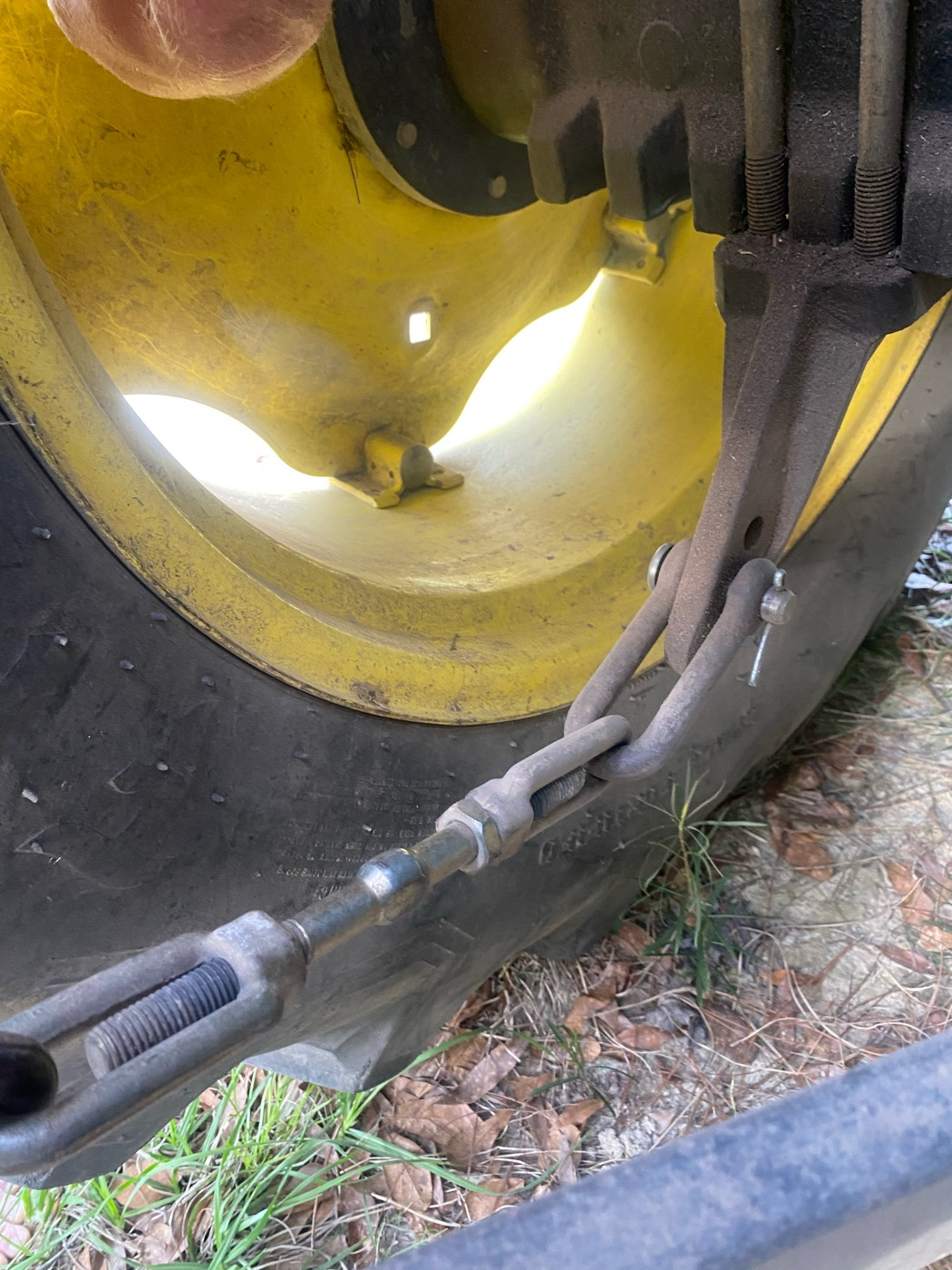

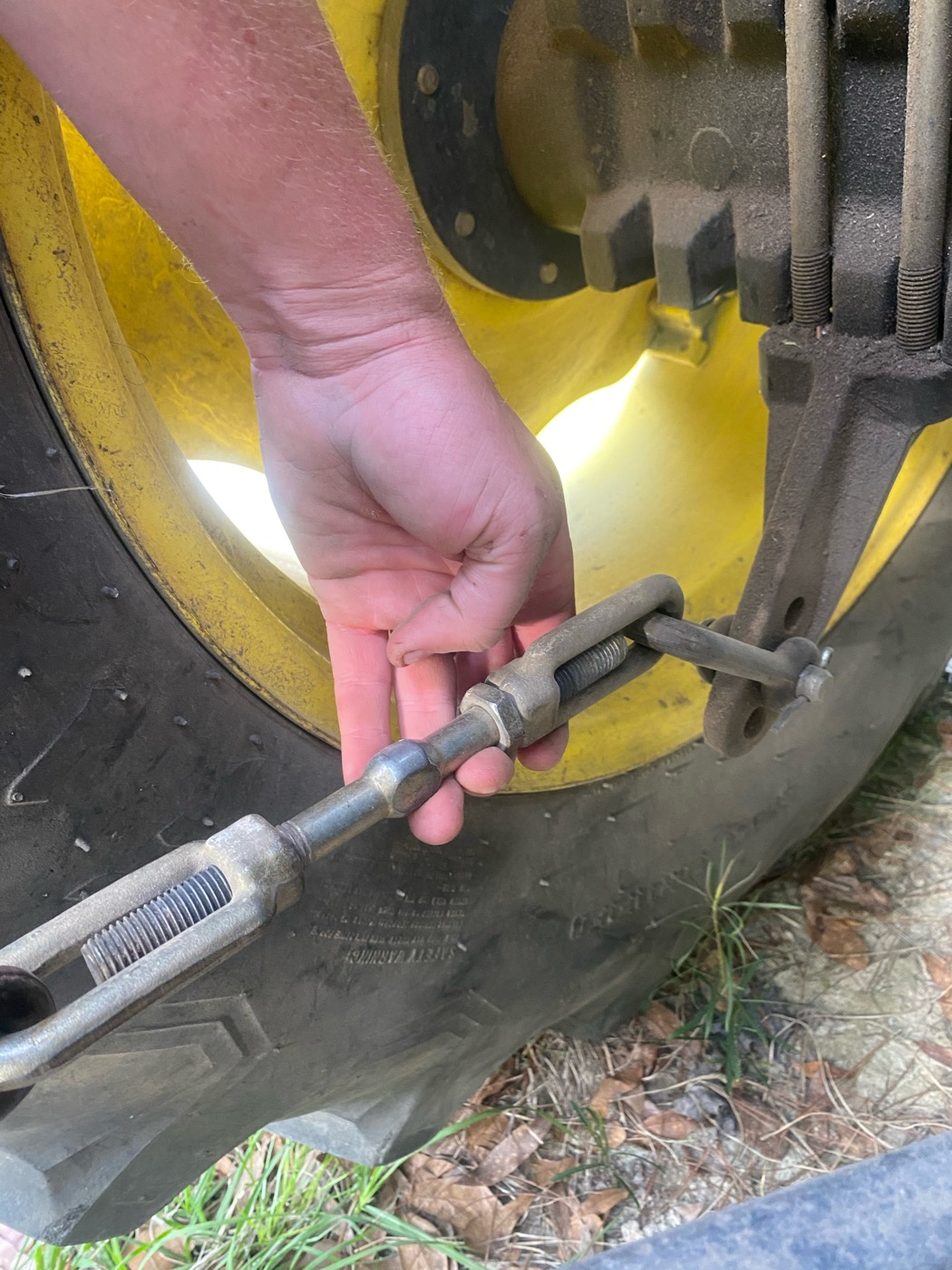

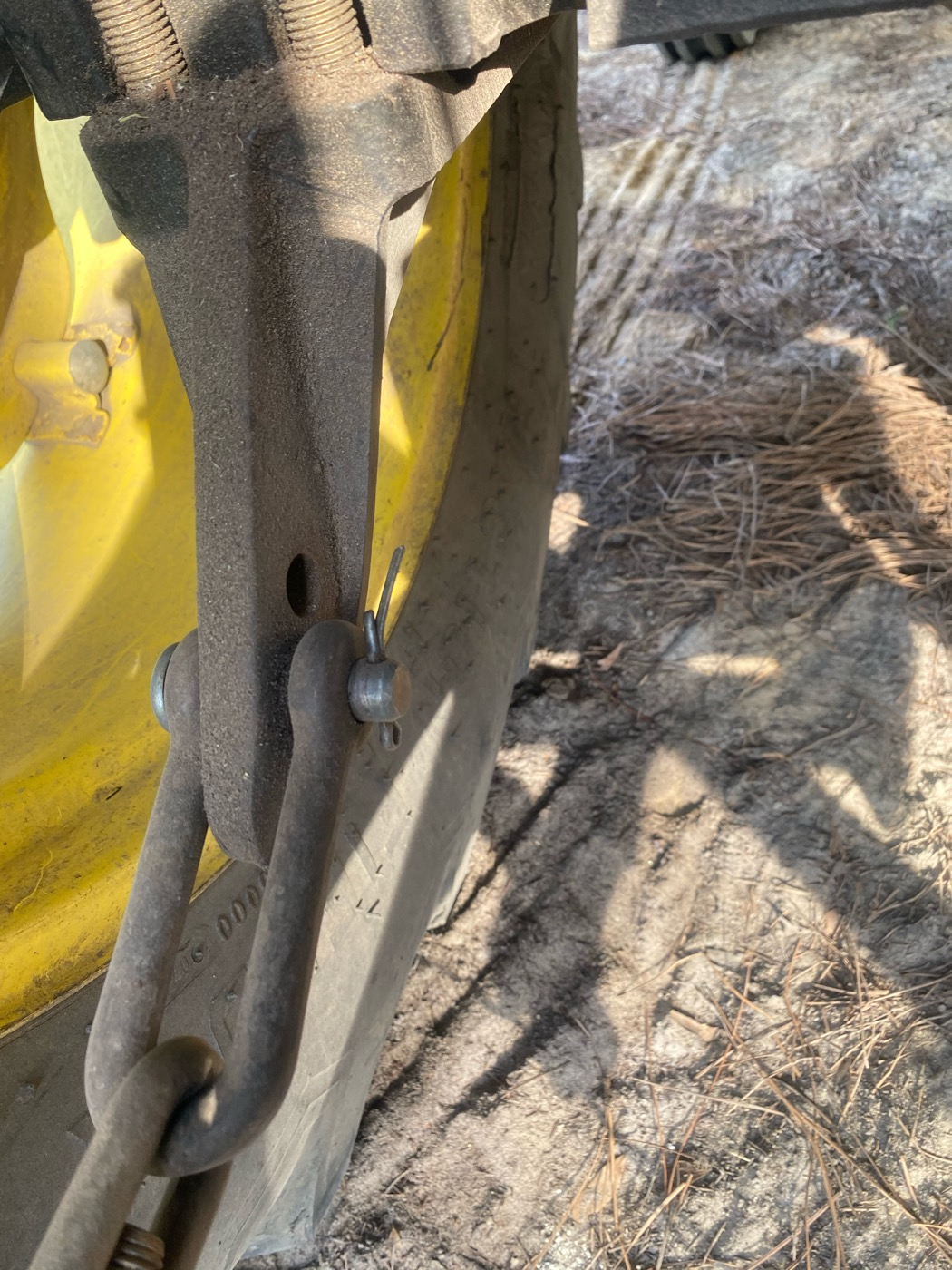

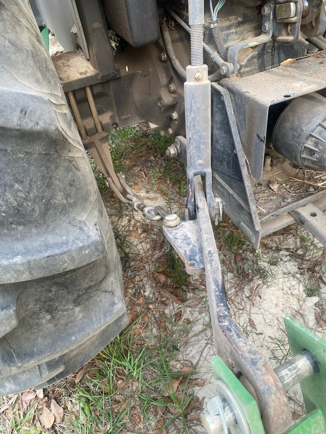

So this is as tight as i can get it. There looks to be another hook up in the first picture that would would be slighly further away and should get things tighter. This is how it was when i bought the tractor and he used to brush hog a good bit... i guess his brush hog fit differently?
To answer one of the questions above, yes i am out of threaded rod to tighten. When i am running the cutter and in reverse, it sways, making it pretty difficult when im in tight spaces.

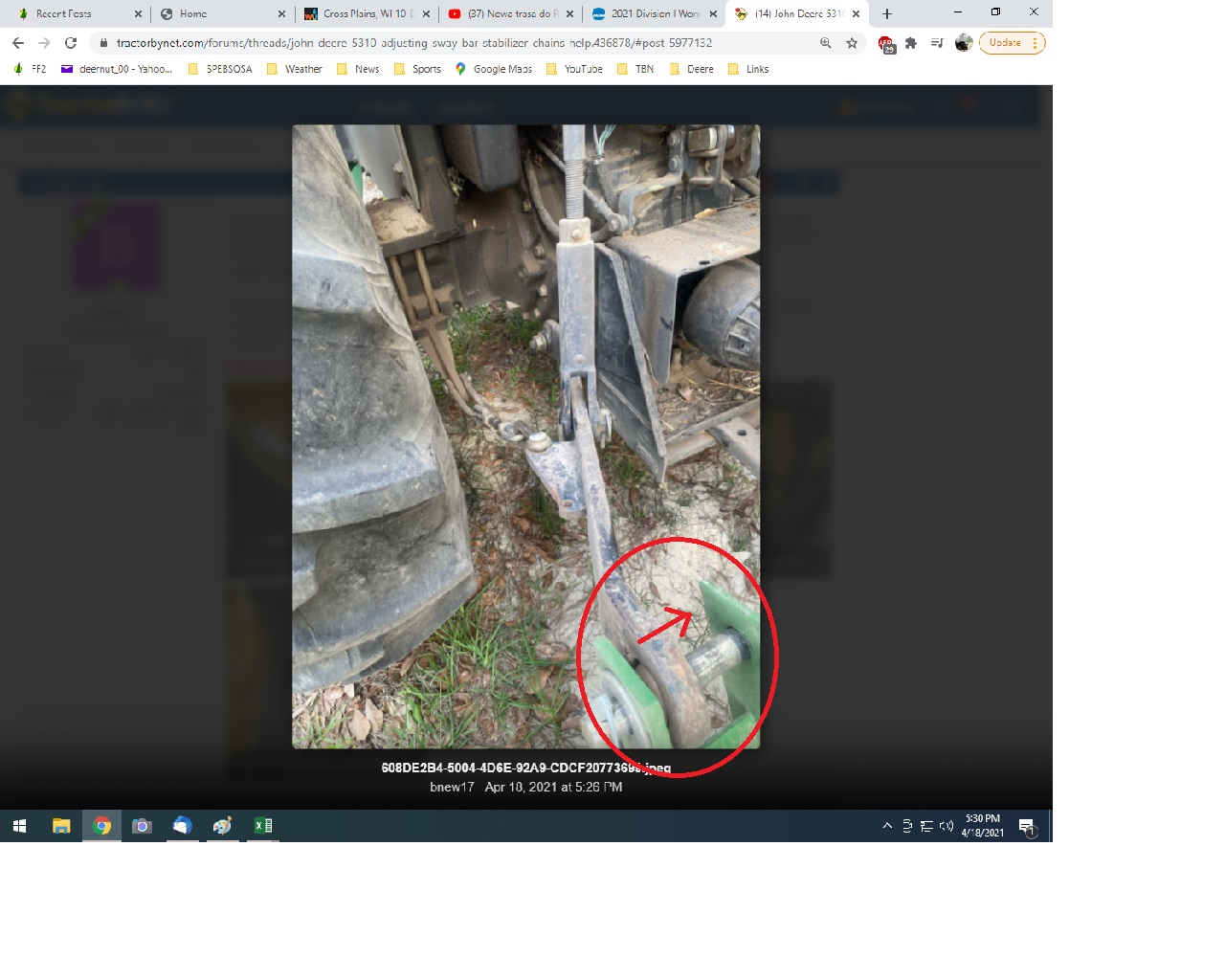

Two changes you can make.. to take up some of the slack..
Add a bushing or washers to bring the arms closer in , and put the sway links in the top pin hole.. both suggestions circled on the attached pic.
All brush hogs are not made the same.. so yours just fits different on this tractor.

Appears your outta thread adjustment. Hmmm. Would moving the front clevis to the top hole give you much more room for adjustment? Its hard to tell from the photos. Or try to find shorter clevis’s for the front or rear side of the turnbuckle.
