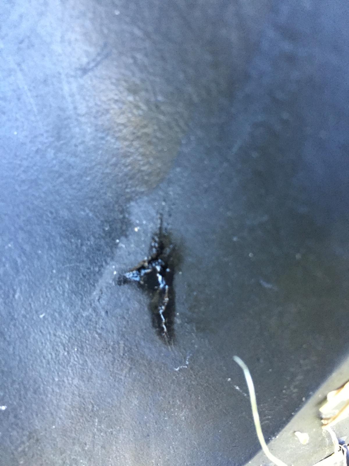

I was out on the land this morning and mowed about 30 acres. Came in the house to take a break and grab some lunch. Went back out and noticed that the left rear tire was flat as a pancake. There is a hole that is about 1-2 mm more or less a very very tiny hole. I know that these tires cost $1,000 and this is a brand new tractor not even a 100 hours on it.
My question is this.... Can a tire like this be patched just like a car tire? I know that it had anti freeze inside the tires for ballast. Anyone have a recommendation where I don't have to spend $1,000. We have a baby on the way and by no means can afford this at the moment, a $1,000 that is!
I really appreciate any feedback I could get.

You can always put a tube in it, not sure if they can be patched, but I would check with a tire shop
/ John Deere 5085 Flat Tire Question #3
it can be fixed, if it has a tube in it you can patch the tube, if its tubeless you can plug the hole. call around and find tire dealer that has service truck
/ John Deere 5085 Flat Tire Question #4
Rear tire flat be it tube or tube type can be repaired by a competent tractor tire repairman.

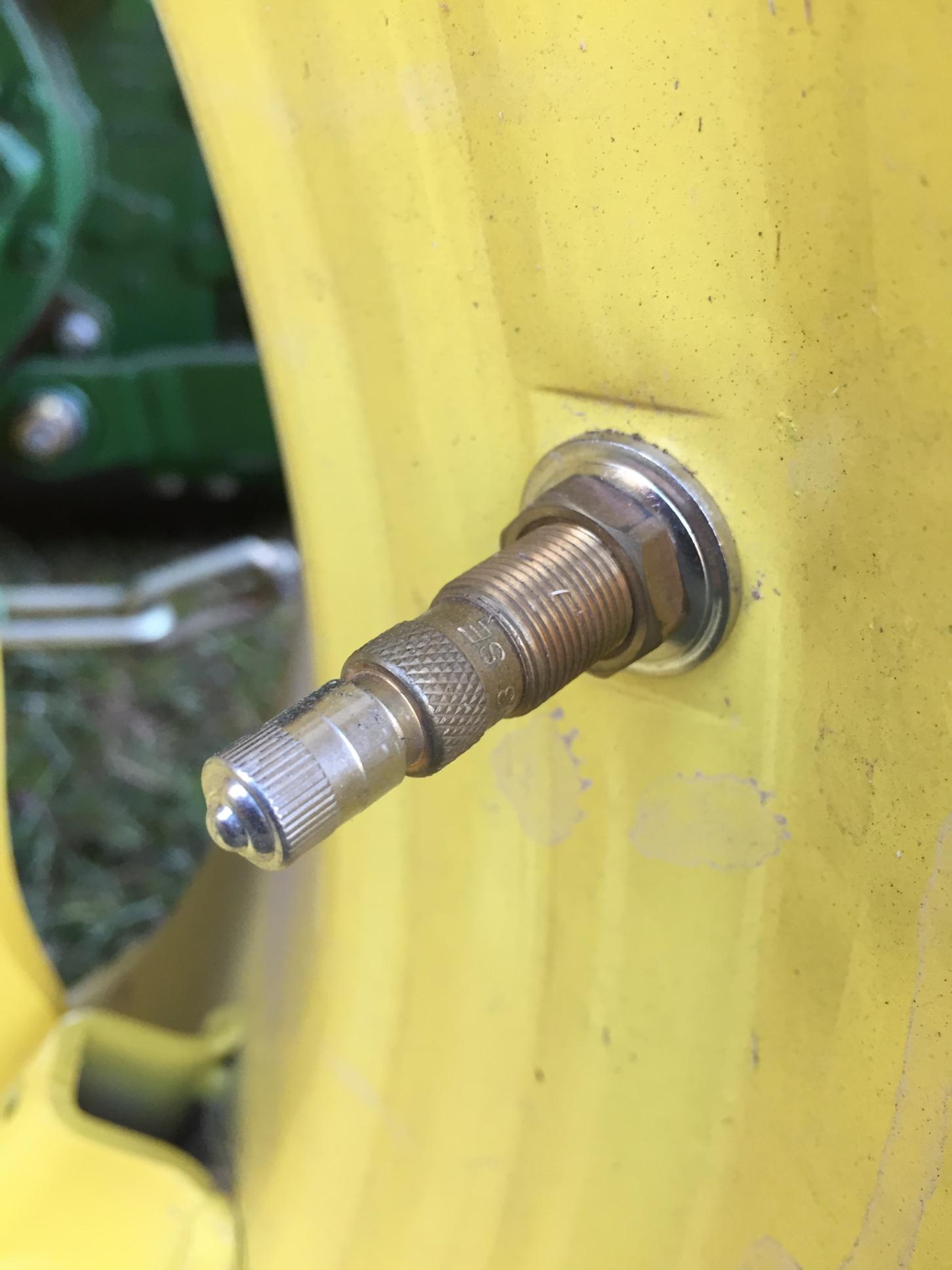

no need to call the dealer call tire store that has service truck. if you post a picture of valve stem we can tell you if it is tubeless or not

@ whis - I took a pic of the stem and the puncture. I really appreciate the help. If it's tubeless would that be a simple fix compared to tube? What part of Bama are you from ;)

Watching this thread. The valve stems on the rear tires of my 6415 are different (from each other), so I suspect one is a tube and that tire suffered flat before I bought the tractor. Mine are filled with Calcium Chloride (not my choice) by previous owner.

its tubeless looks like plug patch will work will need to be broke down to do it, for quick and temporary fix you can just plug it. I am from Arab

If it is not leaking fluid what makes you think it has calcium or anything else in the tire for weight? Some modern patches are put in the tire thru the outside. They have a rubber plug that is pushed in and a round patch opens up on the inside of the tire the gun pulls the plug back out. The plug is cut off like normal on the outside of the tire. To fix it correctly have a boot type patch put on. I have ran new E range tires patched this way and have driven the tires past the legal limit with no more flats or leaks. Just be glad the tire can be saved. much worse case would be catching a steel T type fence post and ripping the sidewall out.
/ John Deere 5085 Flat Tire Question #14
A few miles up the road is a tire repair store. They fix cheap $600 tires and tires that cost tens of thousands of dollars. I have seen tires I thought were bald and shot they were applying patches to. Grind, clean and vulcanize a patch. Even chunks missing from the tire can be fixed by a good tire repair shop.

Tire Fixed for $200. It was patched. Took about 1:45 minutes and was a local fellow. Now back to work and thank you everyone for your help!
