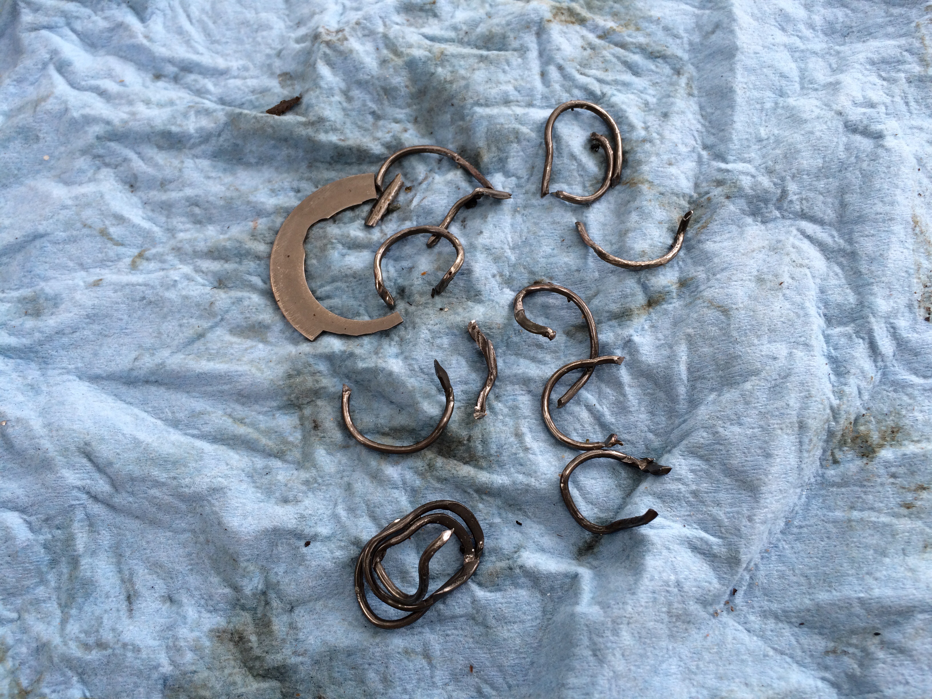

I have a John Deere 500c backhoe that suddenly lost hyd pressure while digging, no noises or leaks everything just got very slow and sluggish, steering, trans, and brakes still work ok. I parked the machine to change hyd filters and when i drained the rear end found some metal that I couldn't identify. Could be the problem or completely unrelated. No foam in hyd fluid like if pump was cavitating. Could a bad de stroke valve on the pump cause this? Any input would be appreciated
/ John Deere 500c hydraulics #2
Pieces resembling wire are broken spring. Check frt hyd pump drive coupler to be sure pump shaft turns when engine is running. Yes faulty stroke control valve could be the problem.

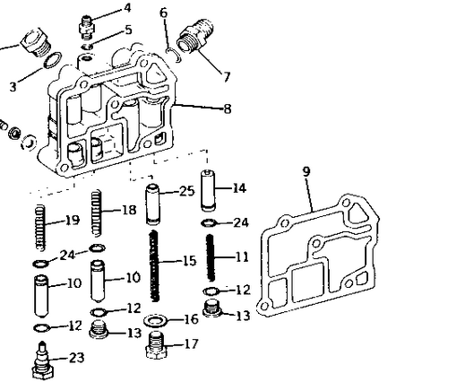

Correction: I was thinking about smaller tractor when I stated RH side. Hyf filter relief valve is on LH side on a 500 series. I don't remember which valve is filter relief but I think it's either key 14 or 25.

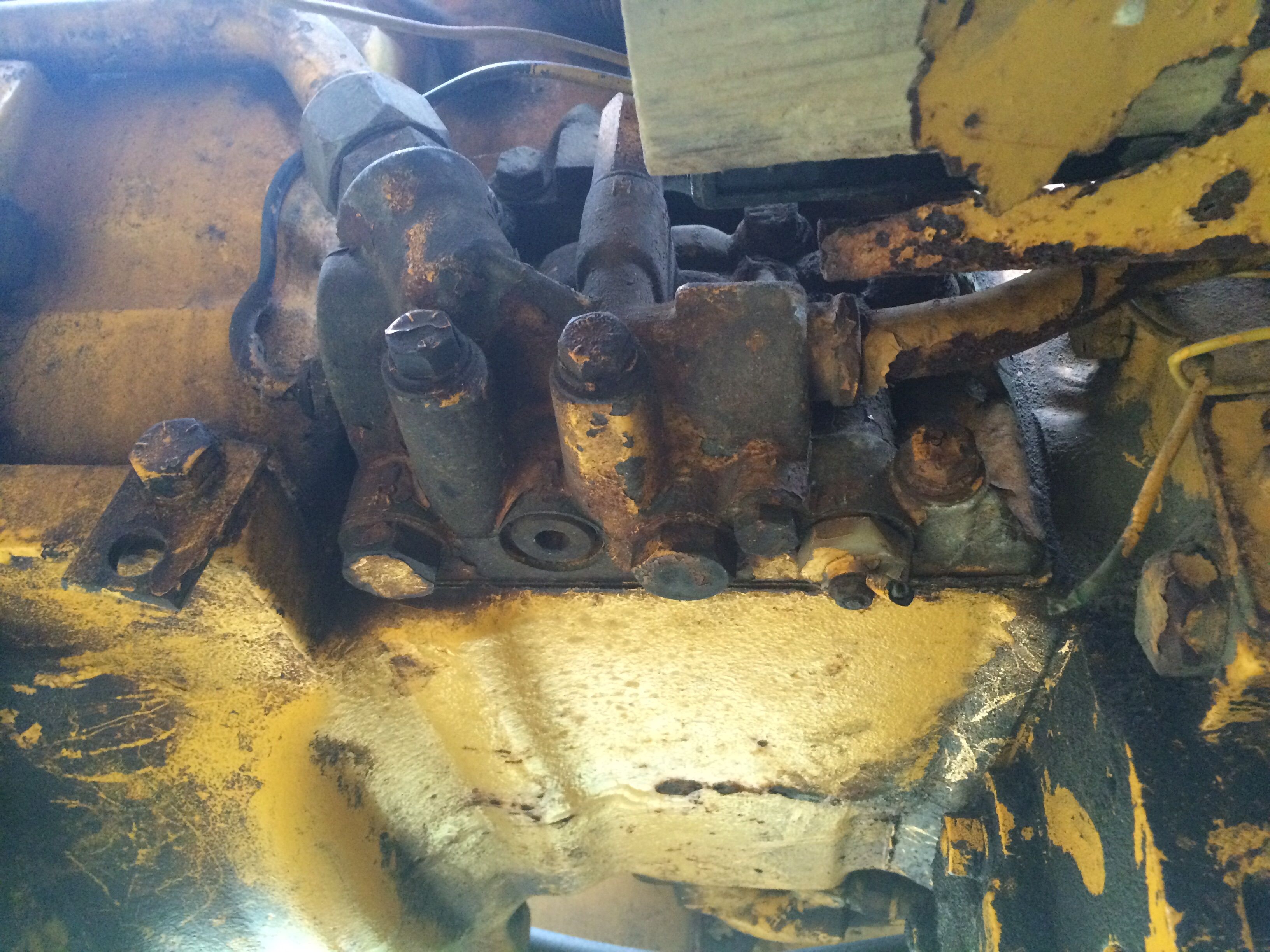

I've attached a pic of the valve housing the plug closest to the rear of the machine is plastic and has an electrical connector on it. I did not see that in the parts diagram, would that be the relief valve?image.jpg
/ John Deere 500c hydraulics #14
As I previously stated I don't which valve is the valve in question. You need to acquire a JD service manual for your tractor.
