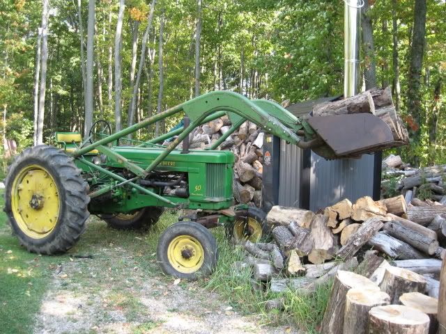

If you can get a picture of the front end I can tell you if it is convertible. There were a few late letter series and some 50 series with what was callled a convertible front end. They are much easier to change. A wide front may be quite expensive. I own a 1953 50 which has the solid pedistal. Great little tractor. Clutch is a breeze and all of the parts are availible thru Deere. You can also pickup any manuals there as well.
