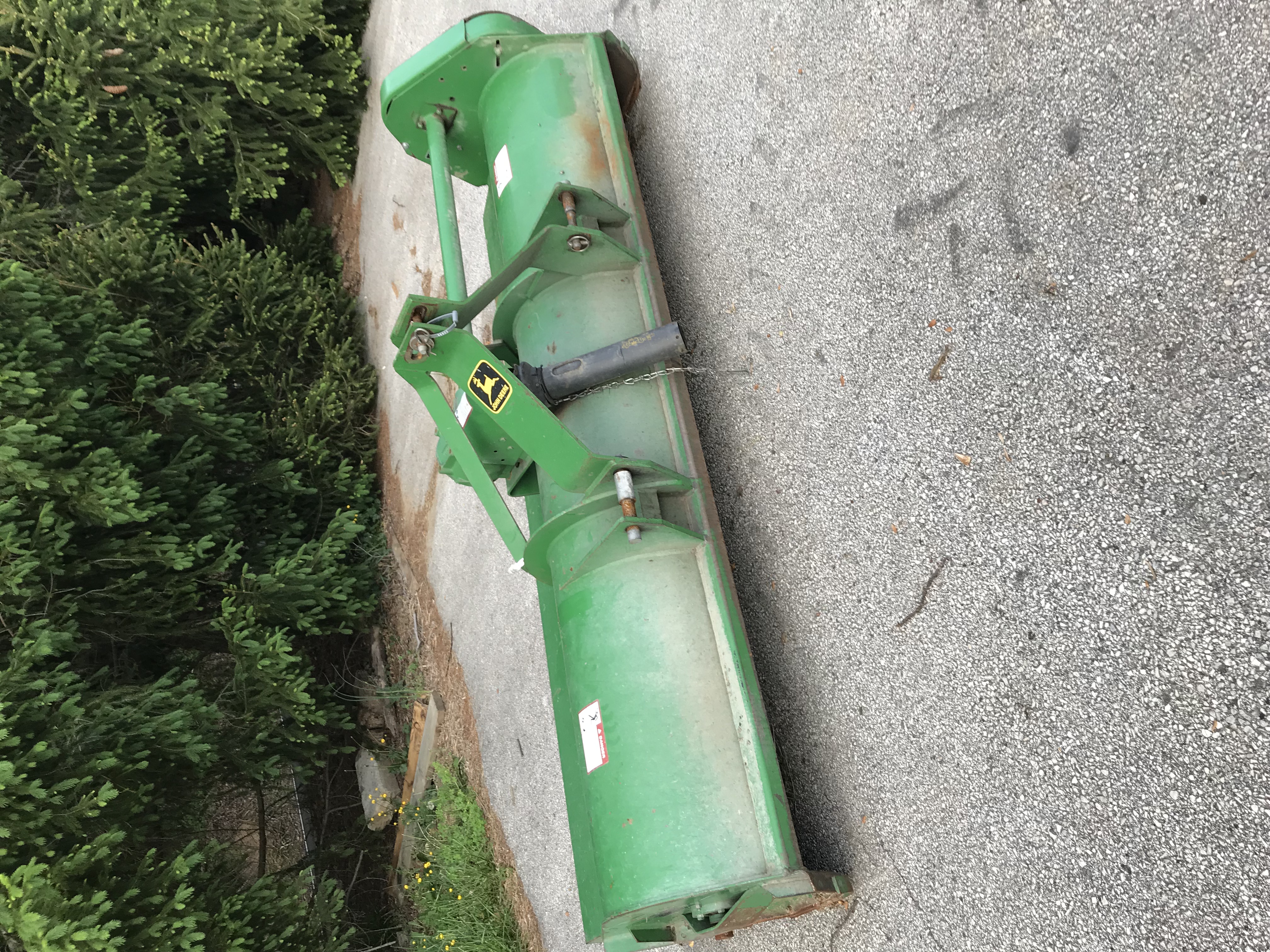

I am interested in getting a 88” flail mower and am wondering if a 4600 will handle it, but I would like to hear from a JD 4600 owner.
/ John Deere 4600 #5
36 hp on the pto.... wood maxx 88'' 50 to 90 hp to run it.......
/ John Deere 4600 #8
Peter 315,
JD's 390 says it will run off of 30 PTO horsepower and the 390 has 90" cutting width.
Cutters & Shredders | 39 Offset Flail Mower | John Deere US
Sometimes the higher horsepower ratings are there to ensure there is enough weight to handle picking up the mower.
I run a JD 390 flail mower. A 4600 would possibly run it for lawn or light meadow use, but anything taller than a overgrown lawn will bog it down. 390s are big heavy flail mowers. Theyre not a little Chinese flail mower. You’ll definitely need a rack of front weights or a loader.

I have JD 4700 and have run a 7 foot Ford flail for years with nary an issue, and not on grass either, above the knee fields. There have been occasion where I needed to slow down or take a smaller bite, but not often. You will know when to back off a bit.
/ John Deere 4600 #10
Your 4700 with 5-6 more HP is like 15% more HP than a 4600 the OP is suggesting. The other thing is a JD390 is a very heavy built flail. It was a perfect compliment for my Kubota M7040, and that was about 60HP. It would easily cut thick grass, but I couldn’t imagine same mower with only 36HP.

It shows 40hp (30kw)..........:)
I see both 30 and 40 HP listed as minimum in two different places on the 390 info,
That said I was using it as an example only I'd prefer to get a Ford 917 with the 88" width or a Bush hog FH188. I think these are lighter than the JD 390.
I agree on the front weights as my 917 that is 74" wide can make my tractor light on the front end at times.
A JD 4700 would without a doubt be better.
Also, I am cutting pastures that have been grazed and some yards and on rare occasions if a pasture gets overgrown.
