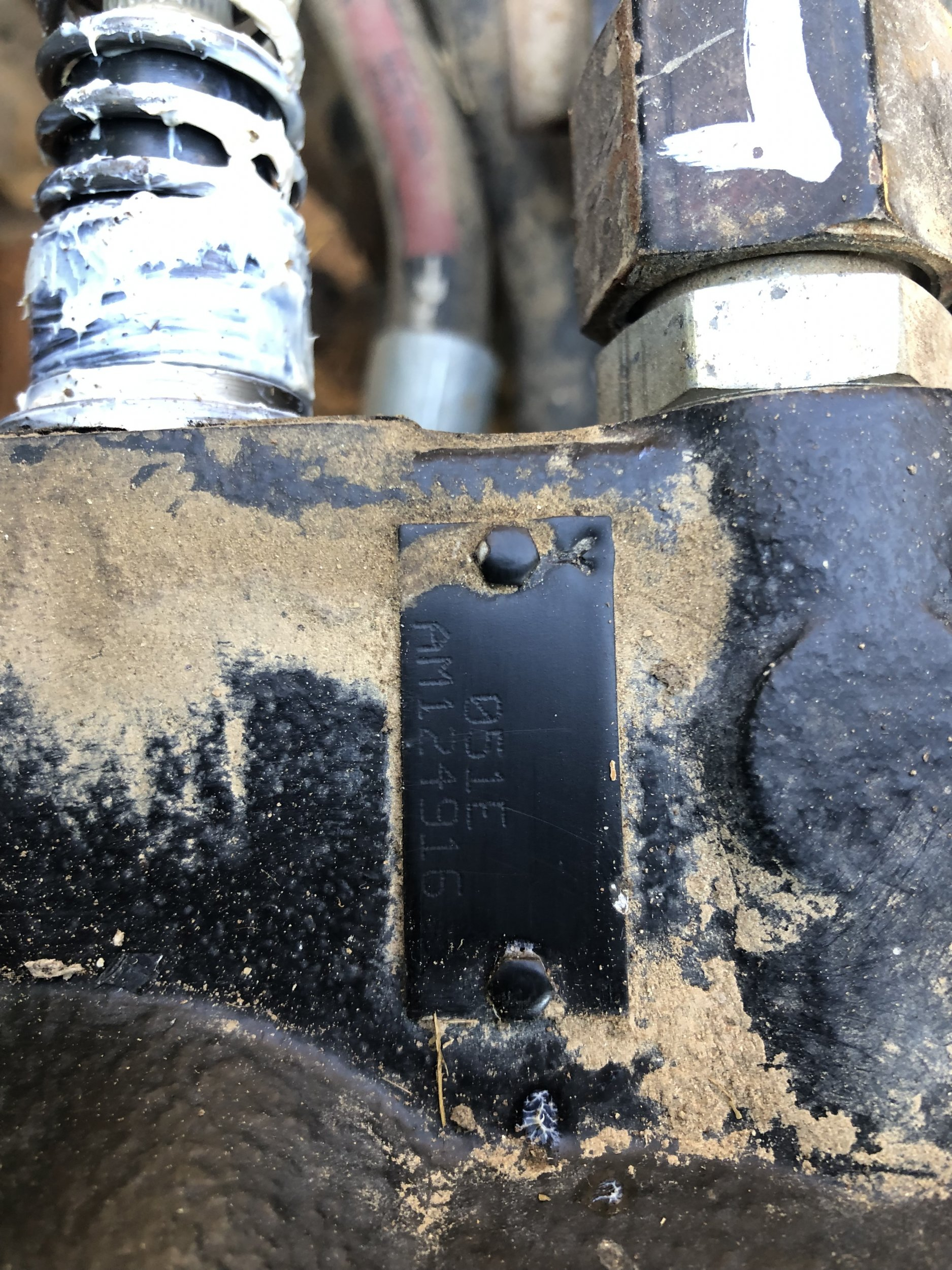

John Deere 4600

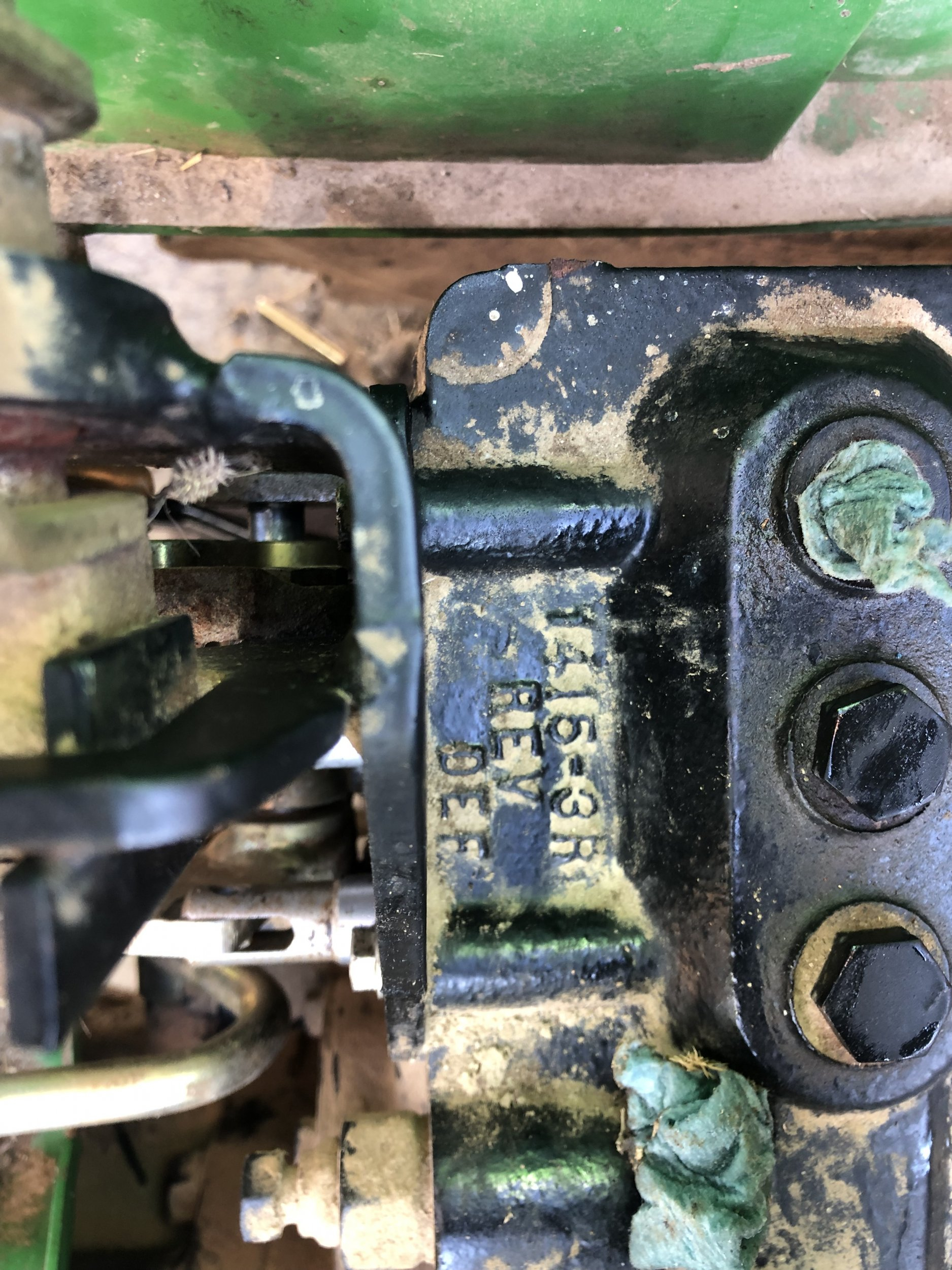

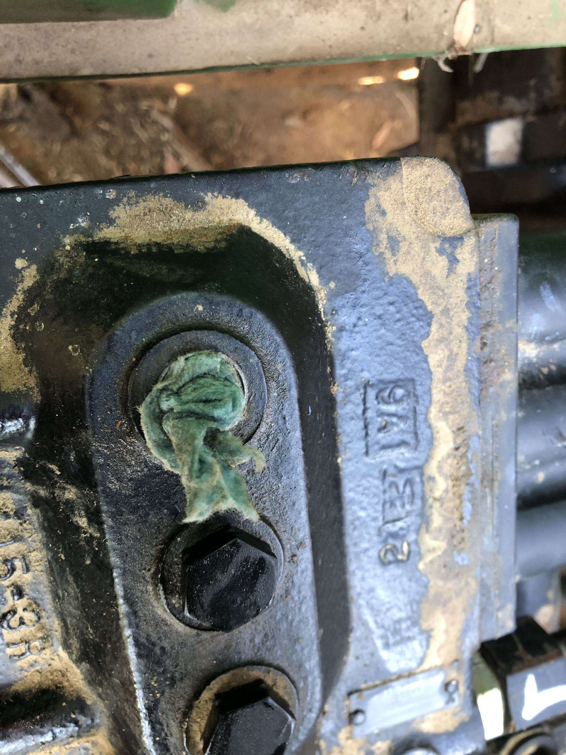

I've got a 3-spool SCV valve installed - two to run the loader and one spool for aux - that has a part number of AM124916 stamped on it. I've got a bent spool (#1 position for bucket up/down) that I'm trying to source. John Deere doesn't have any record of that part number, but shows a new 3spool valve part number of AM124970. I'm trying hard not to buy a new $2000 valve...can anyone tell me the manufacturer/model number of the original valve, or even the new one? I may be able to match up a new spool that way. Attached a couple pictures of the numbers on the valve. There's an old post on this forum that calls my valve may be a Sauer 031A, but I've hit a dead-end chasing that down. Thanks in advance for any help!

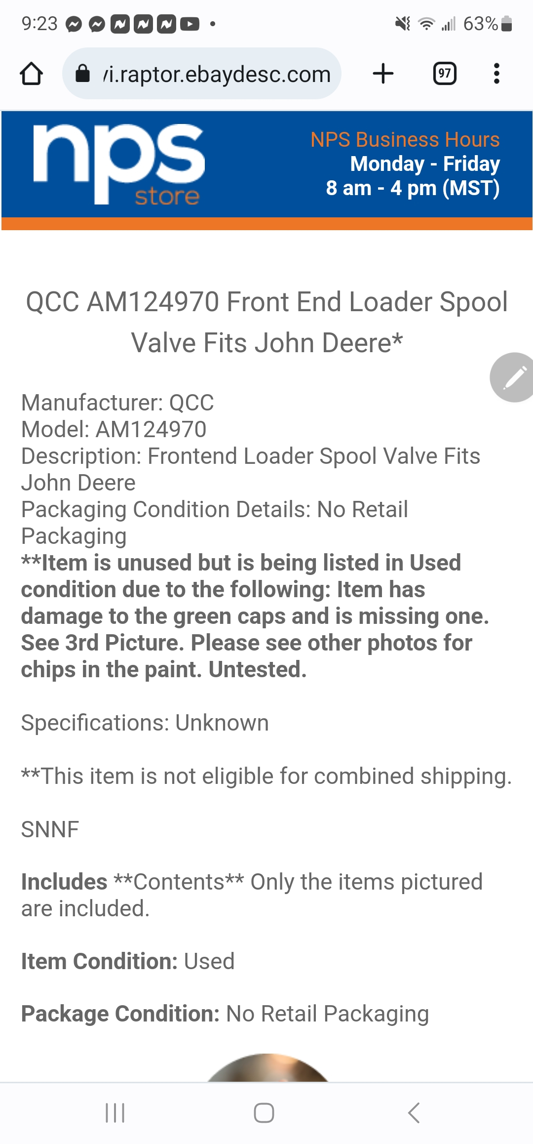

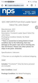

I tried the 051e as a cage code but no dice. I did see a aftermarket 1 that sold on ebay for around 500. says the manufacturer is QCC

What part of the spool is bent? Just curious since that is an unusual type of failure for a directional valve.
   / John Deere 4600/460 Loader SCV Valve #6
if the body is good, and you can get the old spool out. a new spool can be machined . I have had to make them on older equipment. any machine shop should be able to make you a replacement , if you can provide the original 1 to get measurements off of.
