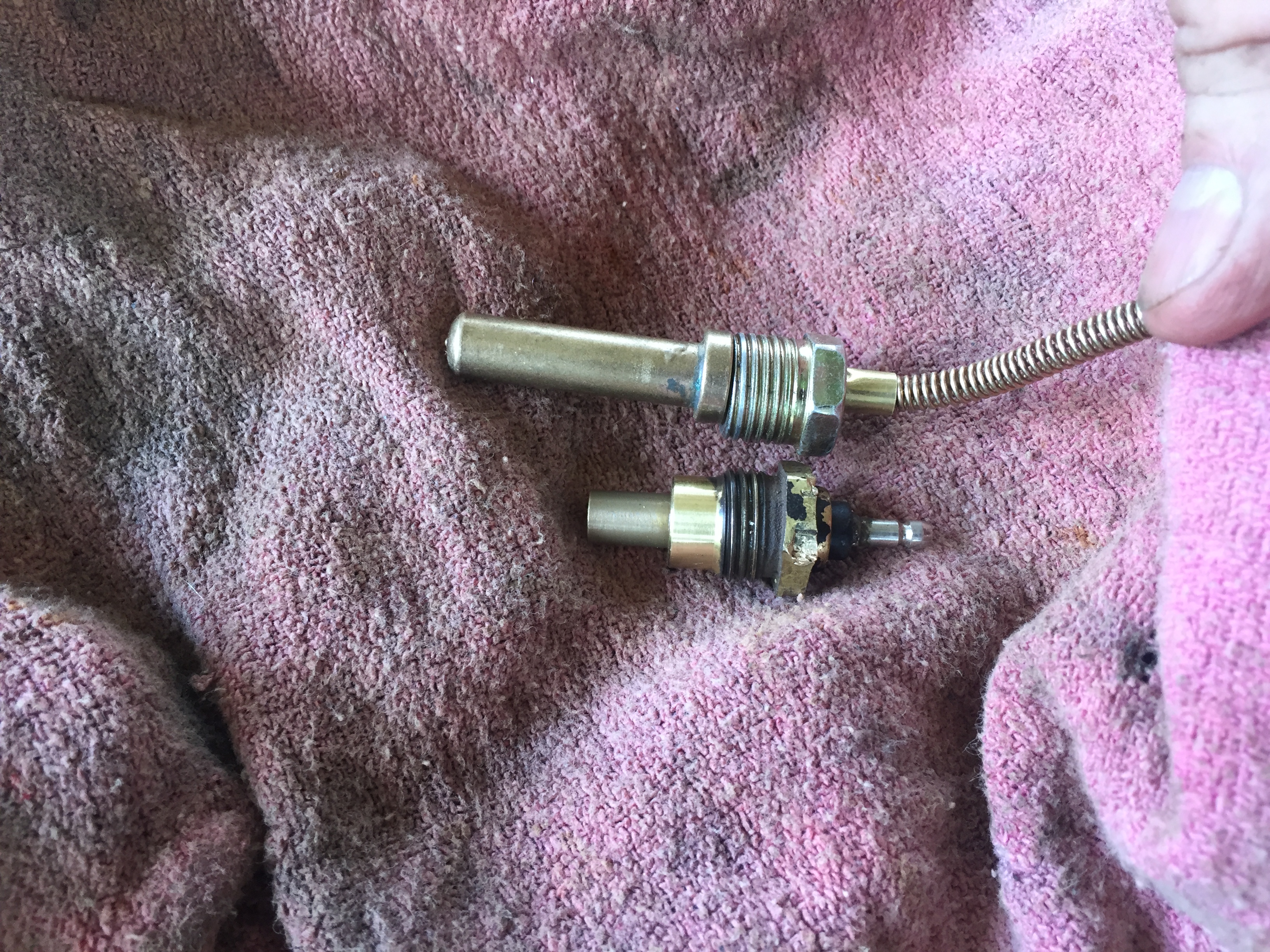

I can't seem to find an external temp gauge that fits a 1999 John Deere 4400...???
   / John Deere 4400 temperature gauge #13
I see plenty of 2" round temp gauges for under $10 on eBay. Amazon or your local parts store would have them, too. If you eliminate the turnsignal switch, you can widen the hole to mount it.
   / John Deere 4400 temperature gauge #14
Thx so much dfkrug. I ordered one, but the sensor/probe is too long(it hits the thermostat). Every one I have looked at online is too long also. So I ordered just the sensor, even though it cost 3 times as much, but now I have a 2" hole in my dash...oh well.
   / John Deere 4400 temperature gauge #15
dfkrug, Did you see the attached image for the temp sensor probe? All of the aftermarket probes are too long to fit...? Thx
   / John Deere 4400 temperature gauge #16
Did your sender test bad? In my cases, I needed a new meter and wire, but I kept the sender.
   / John Deere 4400 temperature gauge #17
Did not test the sender, but cleaned the connections and it still didn't work properly; so I bought another one and haven't installed yet. I still want the temp gauge I bought to work, so I'm going to try to find a npt(sp) fitting to fit, cause I already cut a 2" hole for it on the dash. Thx for the info!!
