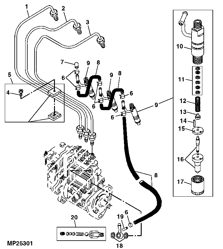

I have a 2002 john deere 4310 with 850 hours on it and it stalls under a load. Like going up hills in high gear, back dragging, and lifting material out of piles. Didn't know if there was any known concerns. Have replaced all filters and fluids with no change. Any help would be appreciated. Thanks

If it stall in low range or doing pto work try these things. Have you checked for good fuel flow from tank? Is tank venting properly? Remove fuel return line(parts key #8) from fitting while engine is stalling to see it that helps. Check ball(parts key #20)could be stuck or blocked.
   / john deere 4310
I bought the tractor new. Its had this problem for a while but seems to be getting worse. Before it was intermittent but it seems to do it all the time now. I use a and b range for work and c range for driving from point a to b. It is an e-hydro transmission. I will have to check the check valve today. Also the hills i'm climbing are small. Thanks
