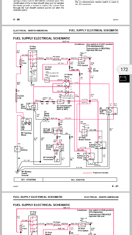

Guys my 01 4300 starts up an will run as long as u keep the starter engaged,when u return the key to the normal run position it shuts down anyone had this issue?

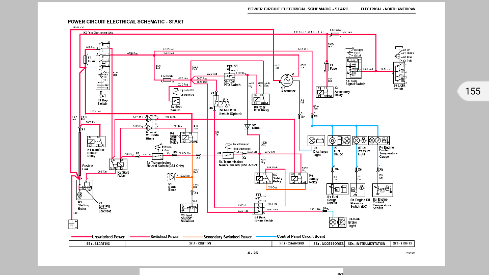

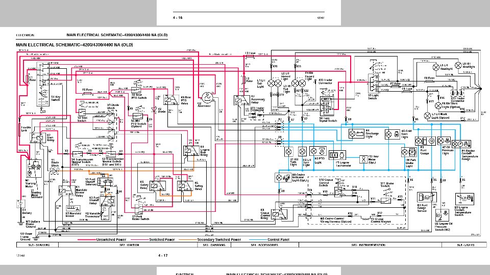

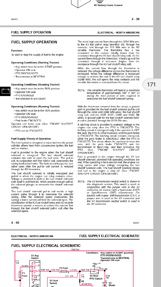

May not be readable, but I attached the some pages of the manual from my phone. Not sure if yours is "new" or "old" though. Screenshot_20170613-185423.pngScreenshot_20170613-185723.pngScreenshot_20170613-185839.png

Do a search for the term "thermistor", I'd bet that's your problem.
