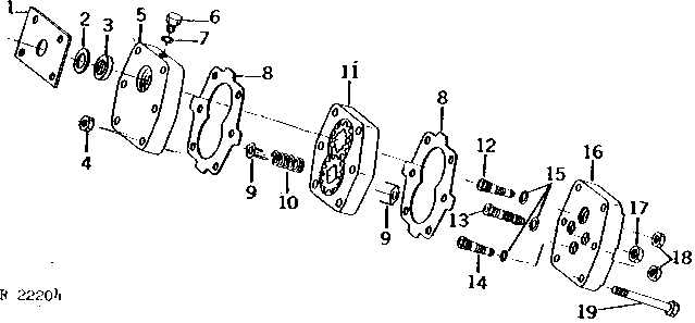

We have a John deere 4230 with a leak at the base of the steering column. This is a late model with a telescoping steering column. It looks like the leak is right at the top of the metering pump. I have a I&T shop manual that shows a oil seal (#27 in there drawing) at the base of the steering column. I am hoping that I can pull the column and replace the one seal and be done with it.
Just wanted to get some input before I got into this. Most of what I have been able to find is related to a leak at the top of the steering column. One other thing I have noticed is that when cranking the front wheels will turn slightly. Not sure what this is an indication of.
Thank you for any advice you can provide.

Early model 4230 had telescoping steering. Is your tractors serial number below or above 019558?

Thank You for responding.
The serial number is above: 027258R. However, it does have the telescoping steering. We bought this tractor used so I don't know what could have been done to it previously.

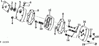

IIRC seal(parts key 3) is what you need to replace to stop leak. Both old(early) & new(late) styled steering on 4230 could be tilt & telescope.

Thank You for your help. I will see about ordering parts and making repairs.
