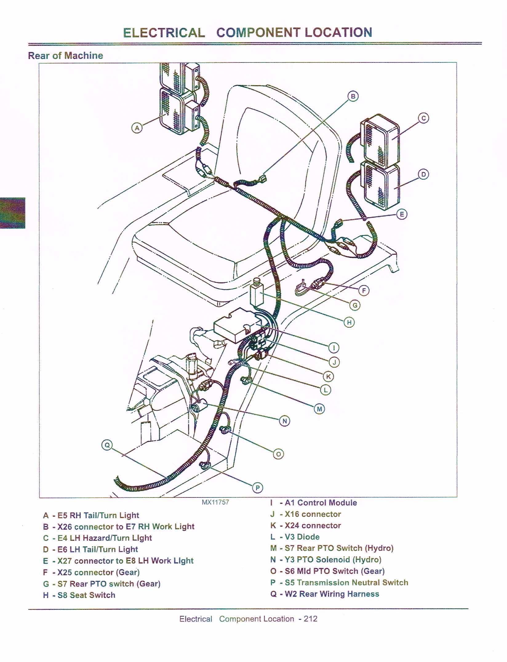

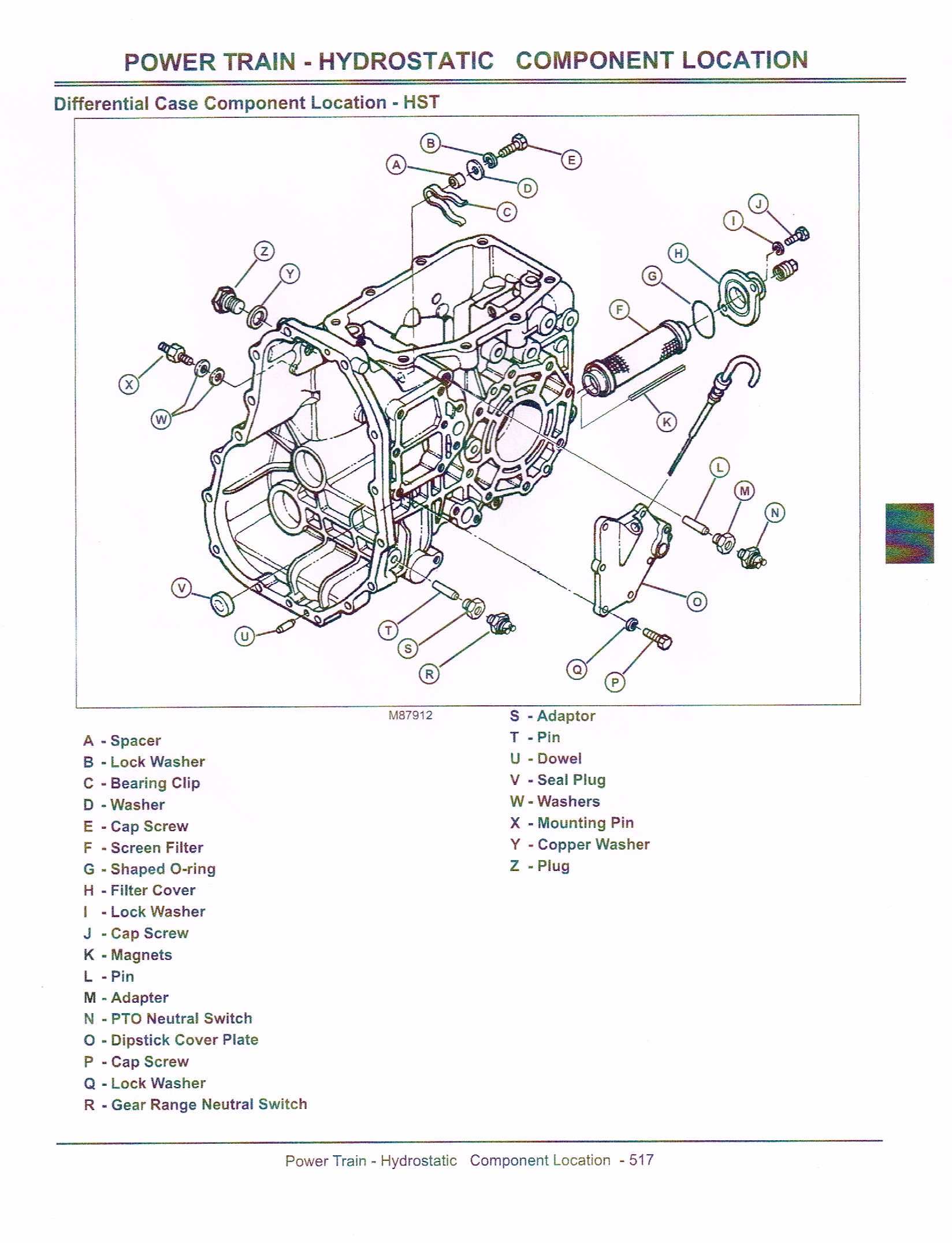

I need to replace the neutral safety switch on my John Deere 4115 , can someone give me info of what is involved ? Thanks

Here are two pics from the 4110/4115 service manual. Neutral switch is item R in first pic and item P in the second. Pics show location. I imagine the switch screws into the transmission, has a quick connection to attach it to the wiring harness. Good luck
