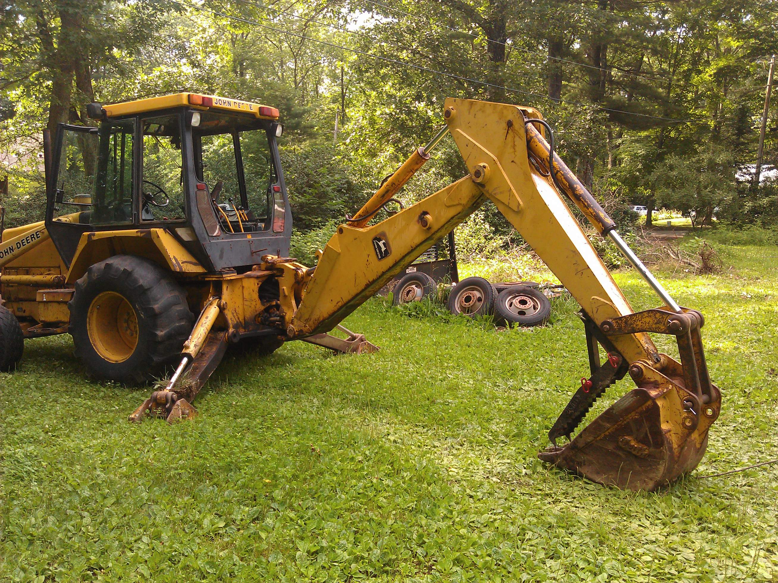

Hello All,

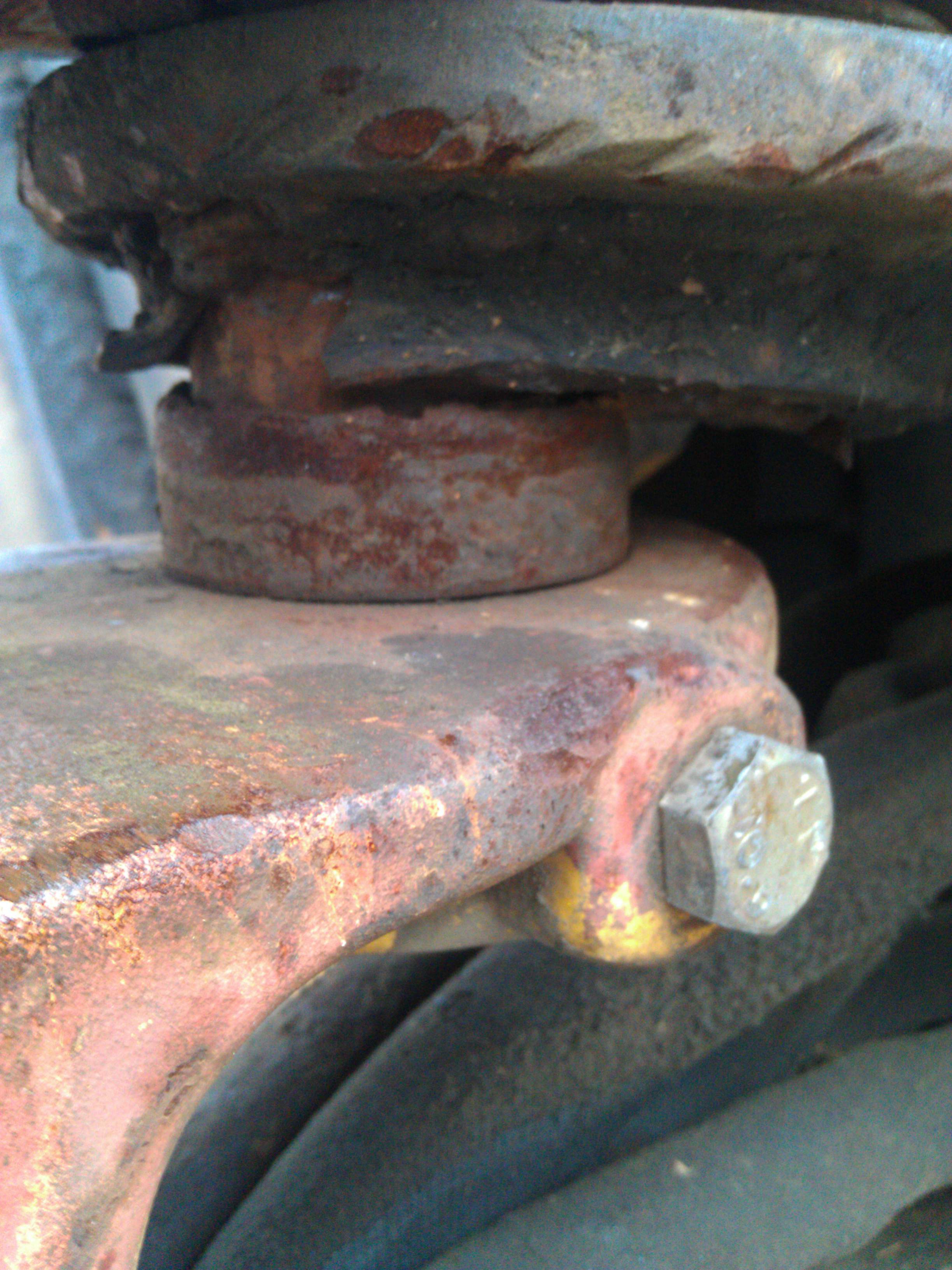

A couple weeks ago I found a deal I couldn't pass up on a 88' Deere 410C. Machine runs mint and had a new factory engine installed about 1000 hours ago. Hydraulic pump was also replaced within the last 1500 hours. So, there is the good, now the bad. Machine has been neglected and not used for a few years, doesn't look like it was greased very often, and pins/bushings in the hoe are SHOT. It is very loosey goosey and has a crack at the top of the dipper stick. The crack should be easy enough to weld up, and looks like stress from the bucket cylinder was the culprit there. The biggest problem however is the bushings/pins attaching the swing tower to the frame. The bushings are so bad, that there is nothing left and it's riding directly on the frame. Any thoughts? Advice?

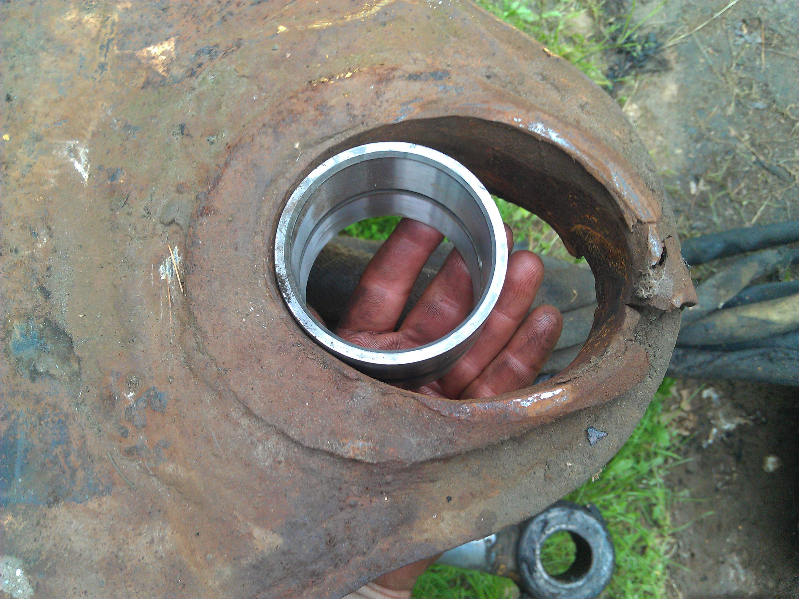

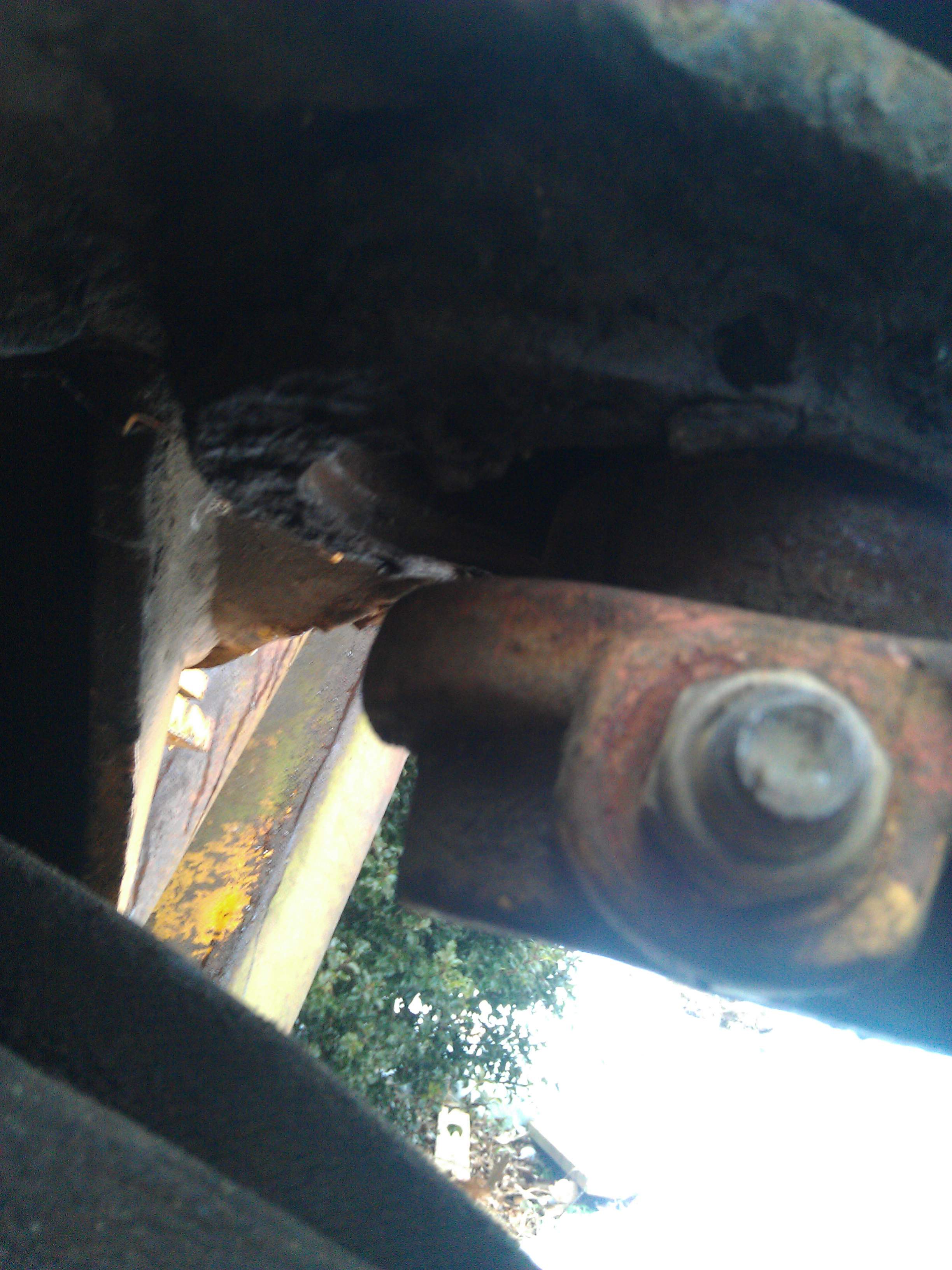

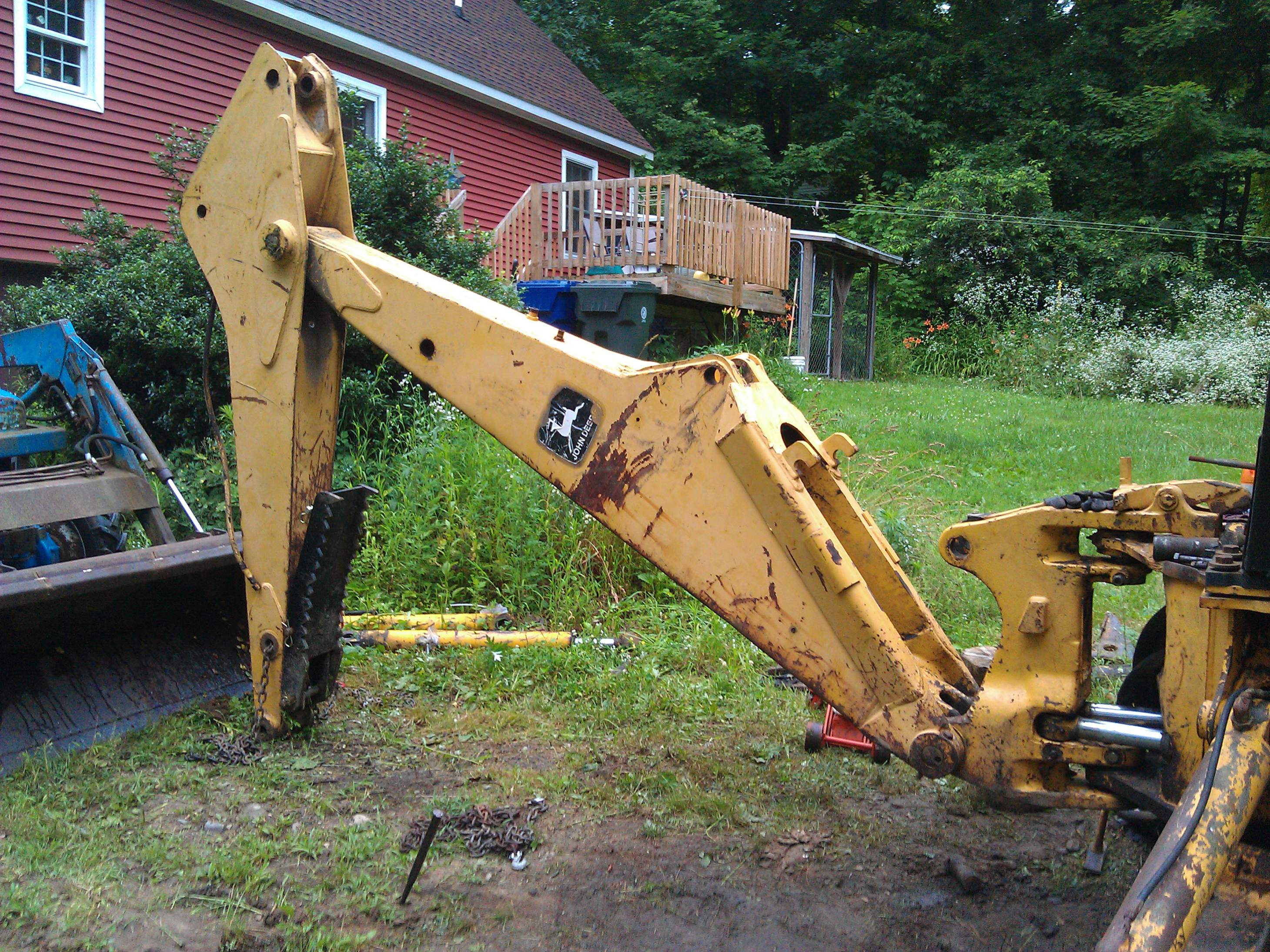

UPDATE!!!! With Pics! Here is the Frame to upper swing tower mount after I got it all apart. Talk about ugly! Old Frame mount.jpg

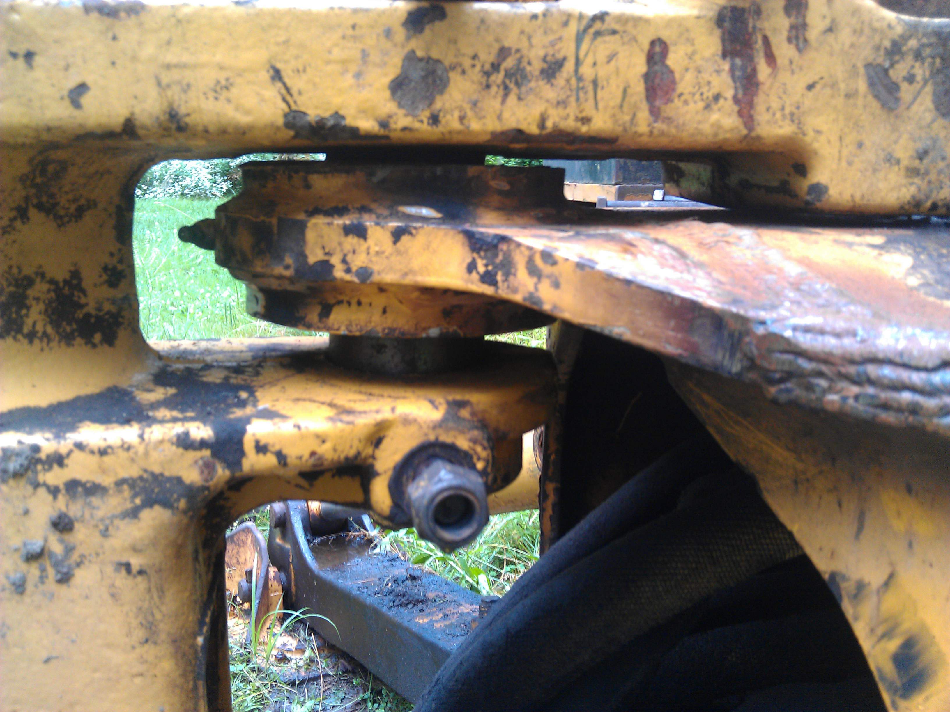

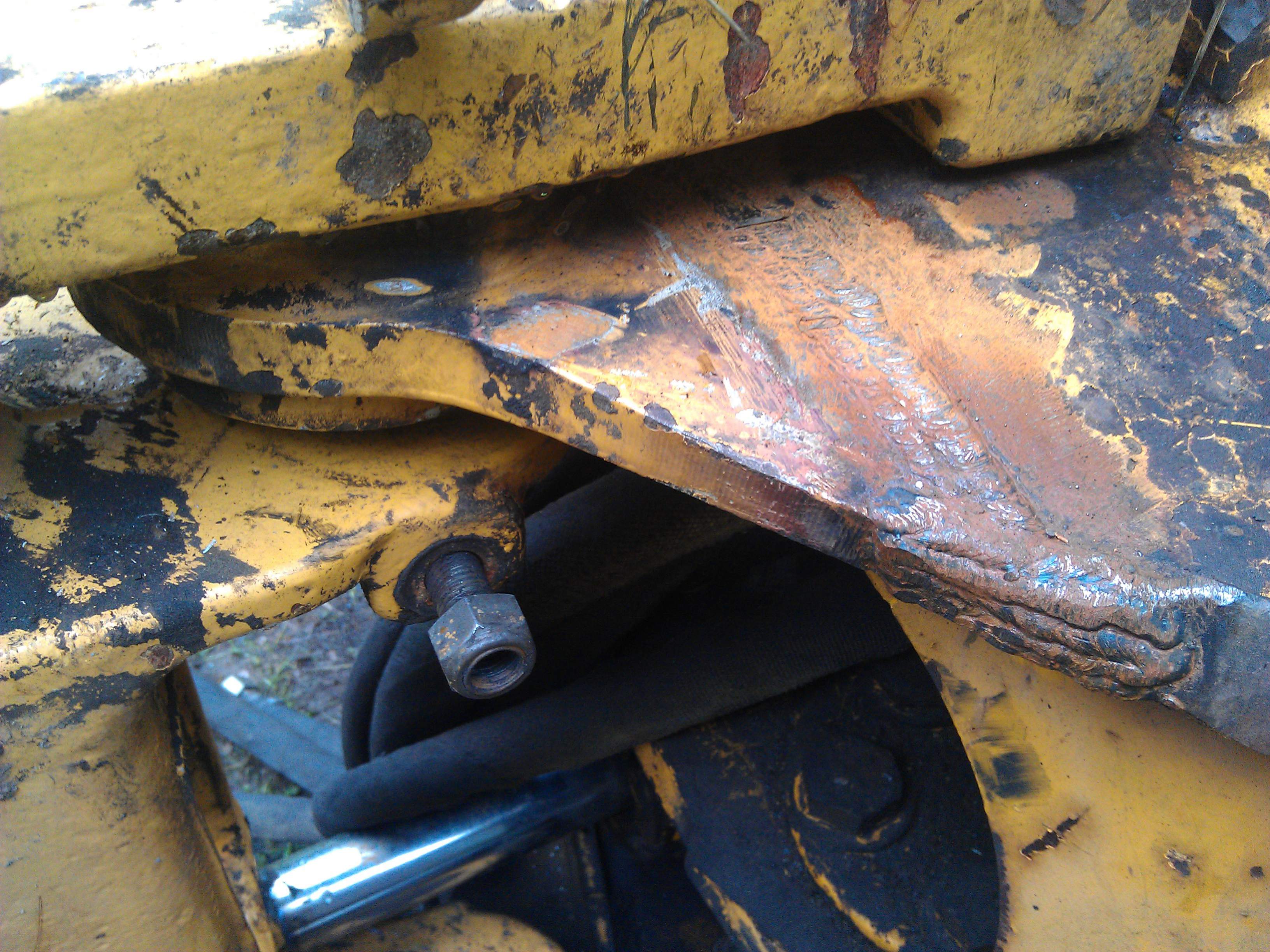

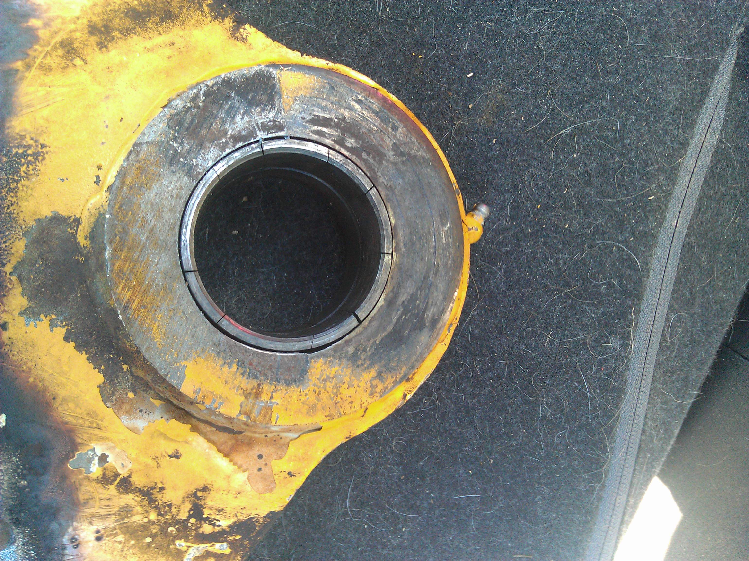

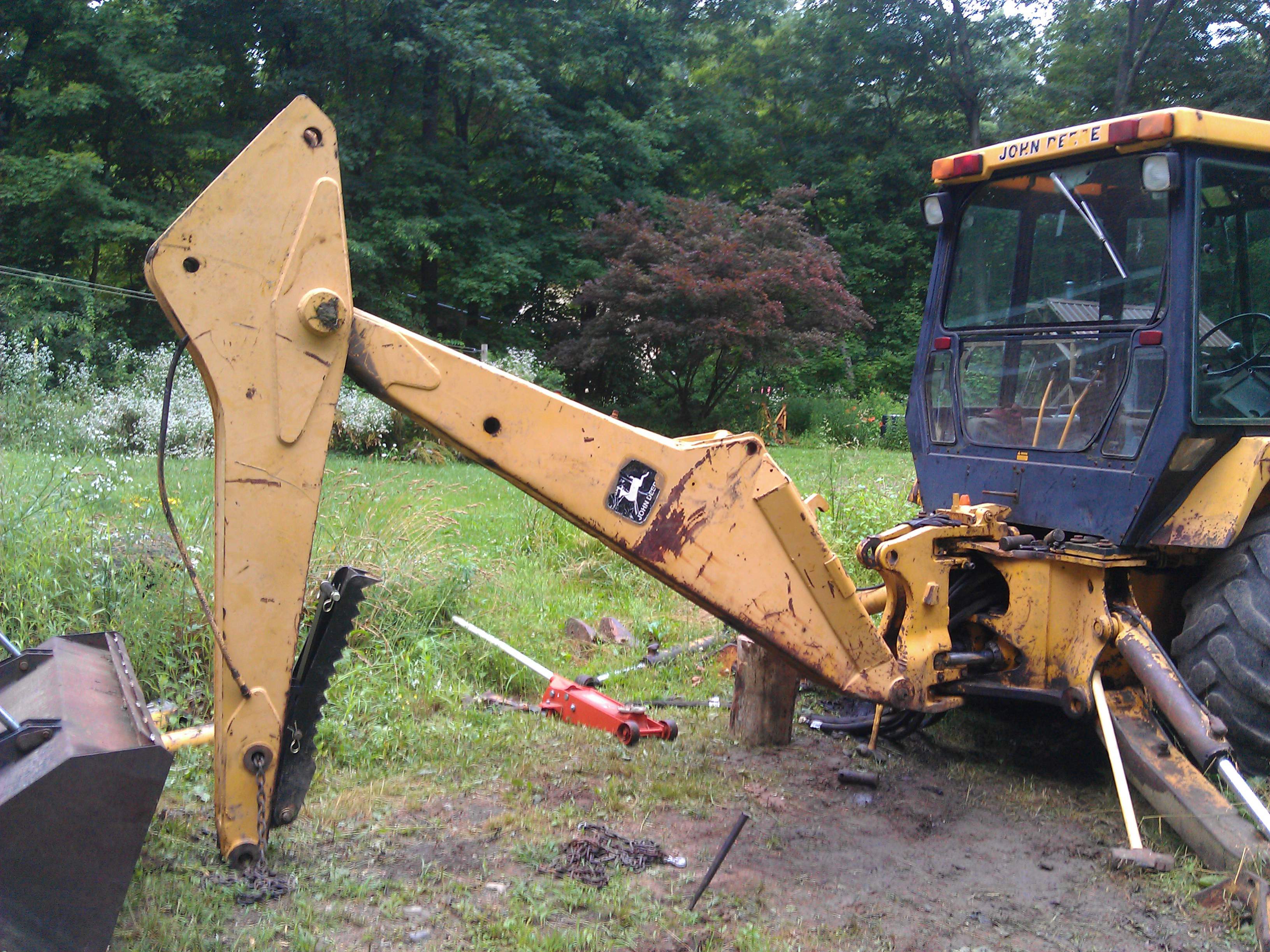

The frame was so bad, I didn't have many options. I found a Parts machine, and bought the Swing Tower/ Boom/ and Dipper from it. The guy also cut off that upper Frame to Swing mount for me, and I had to call in my mobile Fab guy!. Shown is the old mount/swing, and new ones.

New Frame mount welded on with new bushings.
