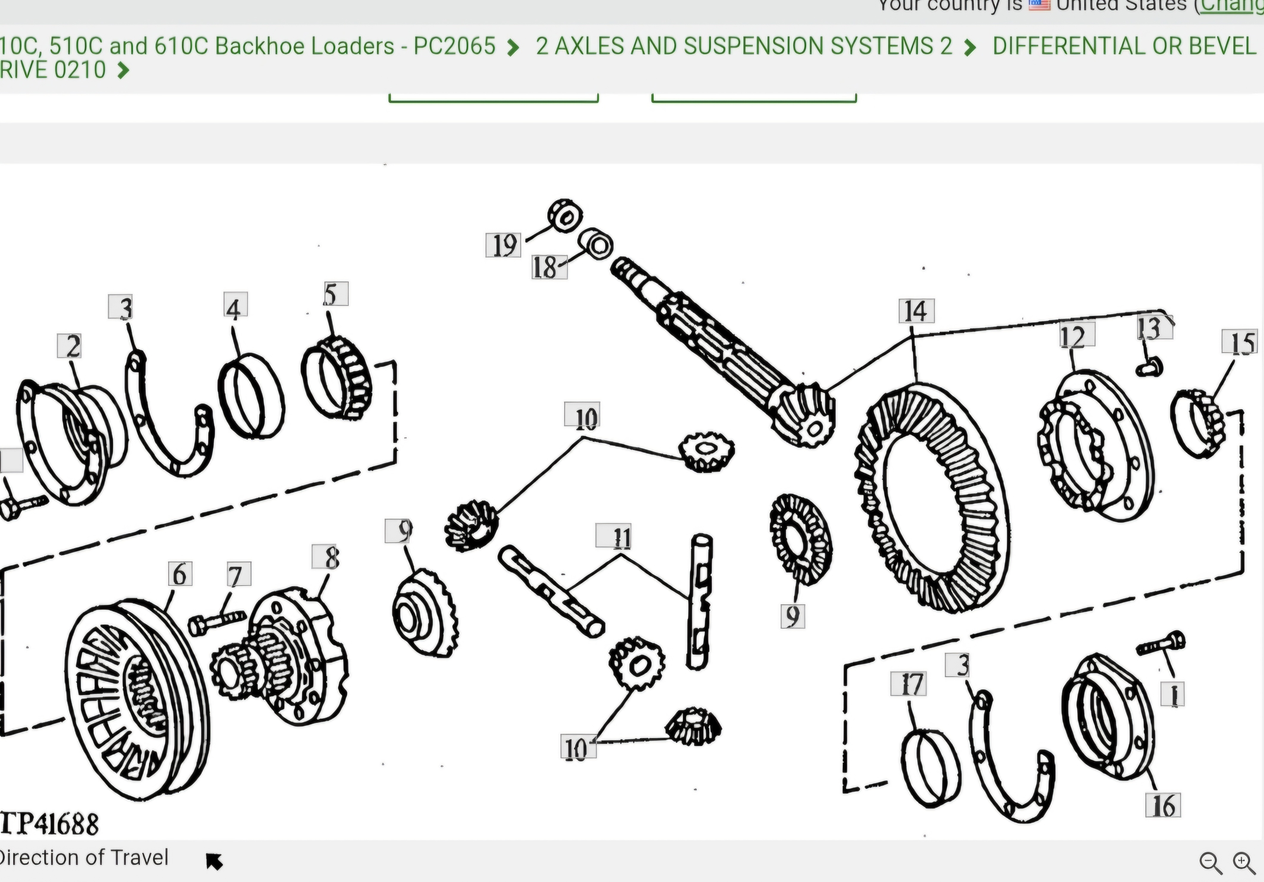

Hello to All,
I have a John Deere 410C 4x4 extend-a-hoe. The driver side axle broke off and I replaced the axle, planetary gears and housing and put it back together and then when I went to drive it in 2 Wheel Dr. it wouldn’t move, I put it in four-wheel-drive and the front tires move then I step on the differential lock and the rear wheels will move so basically my problem is in 2 Wheel Dr. it won’t move, somebody please help me with what it might be. Thank you for your time. I appreciate it.

It sounds like you broke your differential side and/or pinion gear(s) on the differential. #9, 10

Im agree with Tractor Tech I be checking pinion gears & shafts in the rear differential.
   / John Deere 410C PLEASE HELP!
Thank you guys for your replies and information. I appreciate your time and I guess I’ll be dropping the transfer case again! UGH!

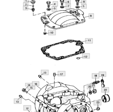

I think if that tractor was under my supervision I'd remove rear trans cover for a visual inspection of rear differential.
