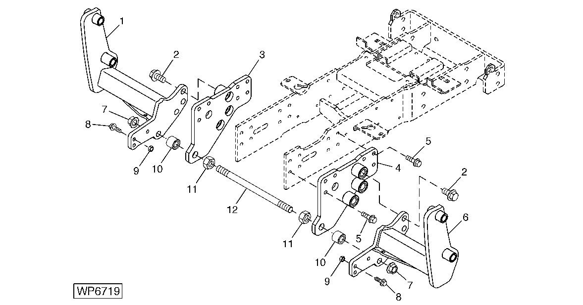

i am wanting to put a front end loader on my john deere 4100 and want to kmow what model to get and were a good deal on one is thanks for any help!! thomas

If you want a JD FEL, the model 410 was the original one sold for it but that will be a tough find. The newer model 200cx is available for your machine. There are a few aftermarket choices, everything will be in the $3000+ range.

i found a 200 xc do u know how much a mount would cost? it was off a 2305 jd that mount would not fit the 4100?
   / John Deere 4100 loader #8
Here are all the parts involved, you will have to check with your dealer for prices:
MOUNTING FRAMES (4100, 4110 TRACTORS)
Cart key PART NO. PART NAME QTY SERIAL NO. 200X 200CX REMARKS
1 AW34065 Frame 1 X X (SUB FOR AW33483) L.H.
2 W51622 Self-Locking Screw 6 X X M20 X 40MM
3 AW33481 Plate 1 X X L.H.
4 AW33480 Plate 1 X X R.H.
5 W51621 Self-Locking Screw 14 X X M10 X 35MM
6 AW34064 Frame 1 X X (SUB FOR AW33482) R.H.
7 14M7300 Flange Nut 2 X X M20
8 W51614 Self-Locking Screw 6 X X M12 X 35MM
9 14M7275 Nut 6 X X M12
10 LVU12858 Bushing 2 X X 22.650 X 36.460 X 32 mm
11 14M7335 Nut 2 X X M20 JAM NUT
12 W50795 Rod 1 X X
